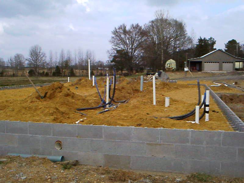

View attachment 447644I used (contractor used) all copper with closed cell foam insulation on all the pipe which was ran underground and up thru the slab. The insulation keeps soil and concrete from contact with the pipe plus insulates the hot water line to which I have a recirculating pump attached at the water heater. This may cause a bit of extra electricity to keep the line hot but I have instant hot water which conserves our precious water resource. It sure beats what I had at my previous house where the master bath was at least 60 feet of line away from the heater and took it seemed like forever to get hot water from the faucet. In the photo you can see the water lines protruding from the soil prior to slab being laid.
I hate slabs and for that reason the plumbing is in it!!! That will be a nightmare when those copper pipes corrode through or you need to move drain lines.
