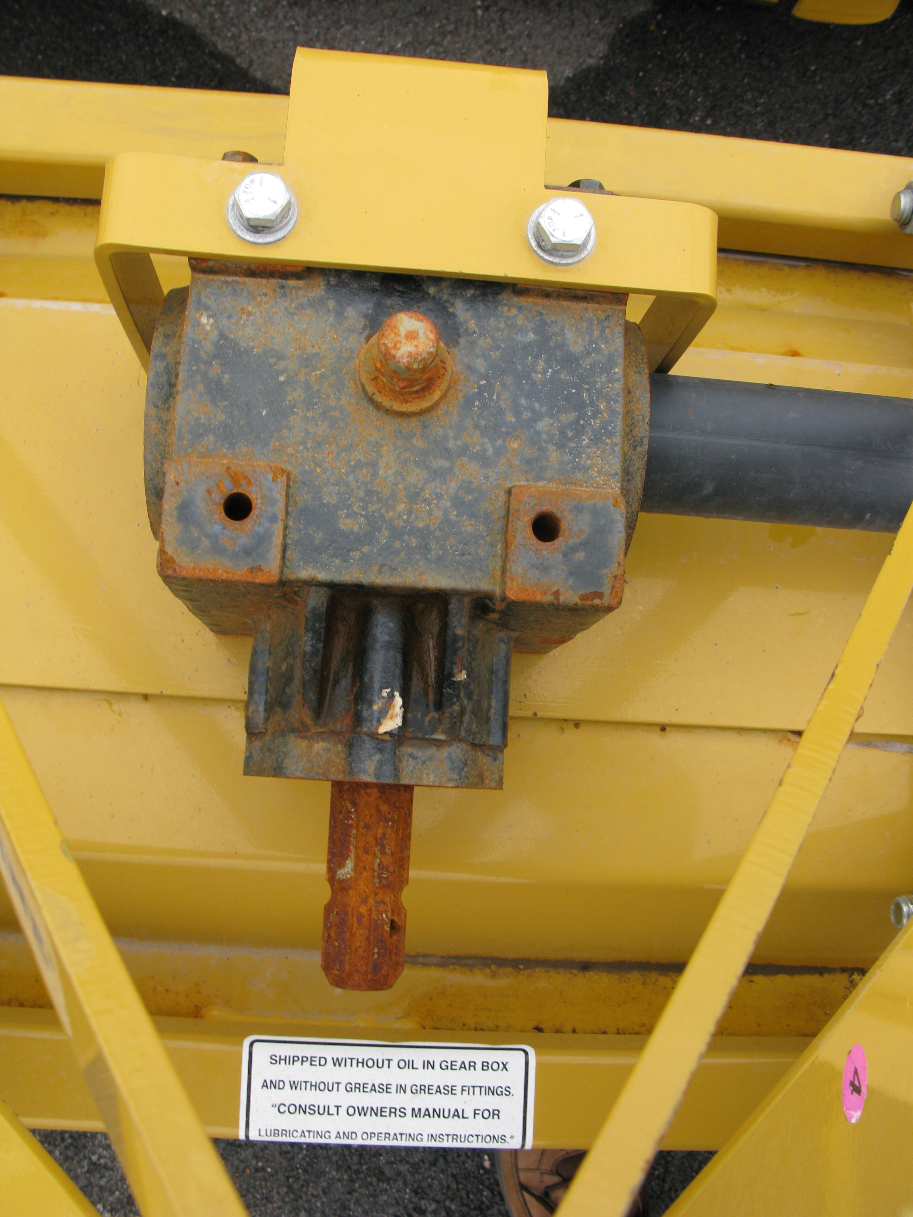

FYI, attached are photos of the 72" 3 point County Line branded tiller made by Behlen - that the manager at TSC, Nixa, Missouri swore was made by King Kutter - that I declined to buy.

Wow Missouri Pioneer, looking at the condition of that gearbox & shaft...I can surely understand why you chose to be un-interested in that machine! I would have walked away no matter how much of a discount was offered. That looked nasty! Greg
Sure looks like the same they sell here....... which I assumed were made by Tarter. I've never noticed a Behlen sticker on them, but they look the same with the 'open' ends. Unlike the KKII, which none of the TSC carry around here.
