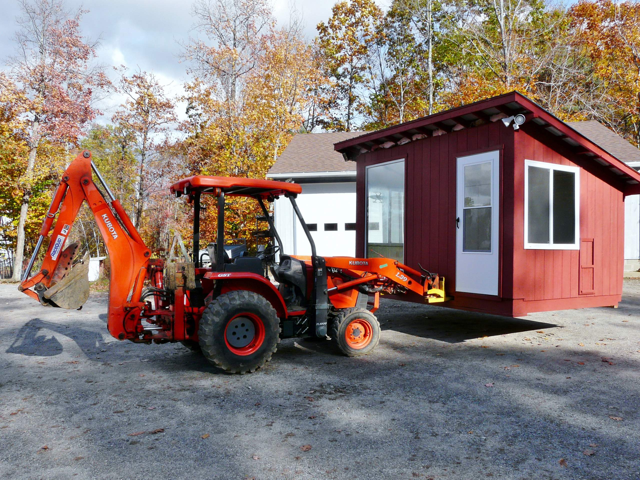

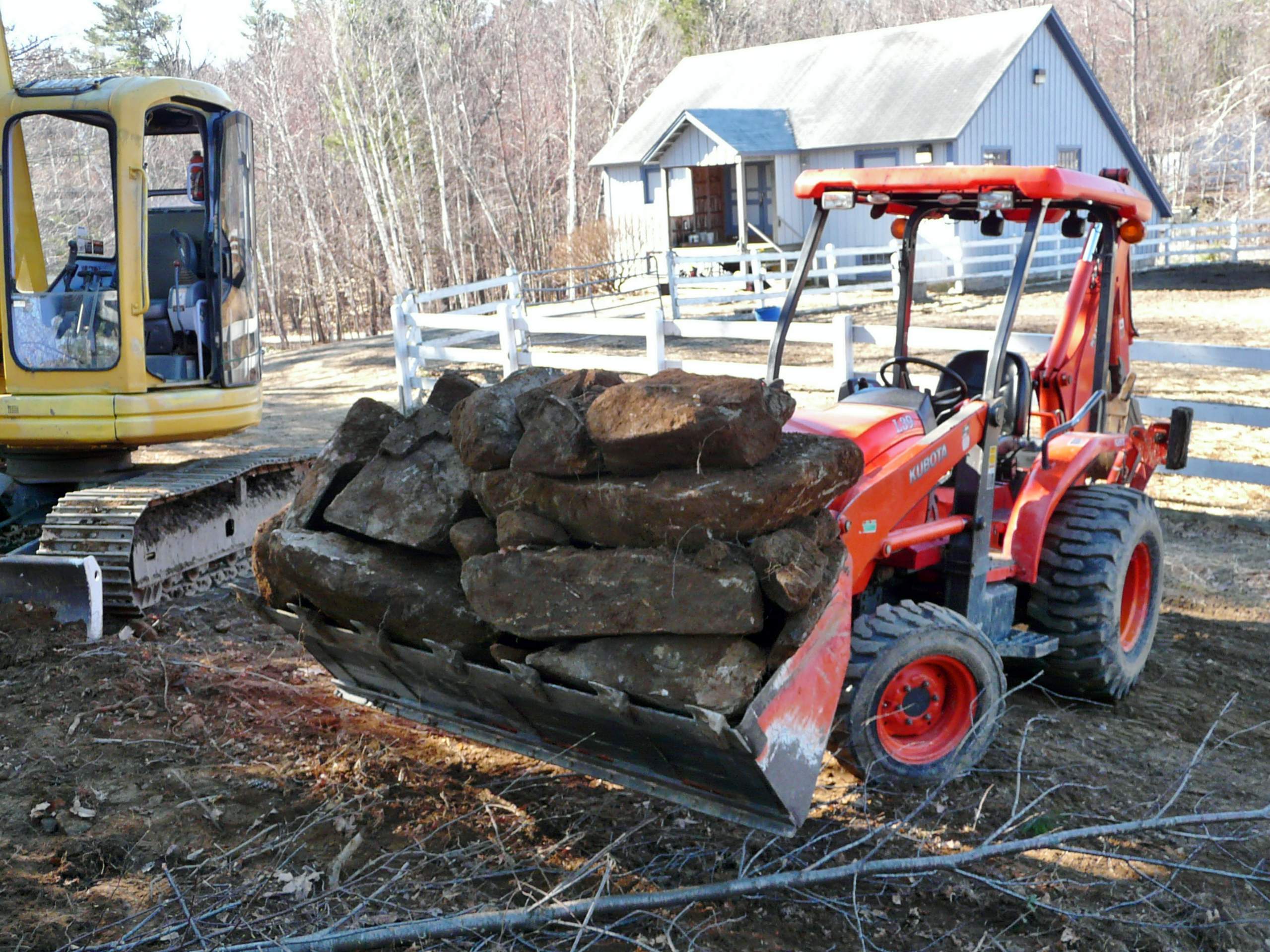

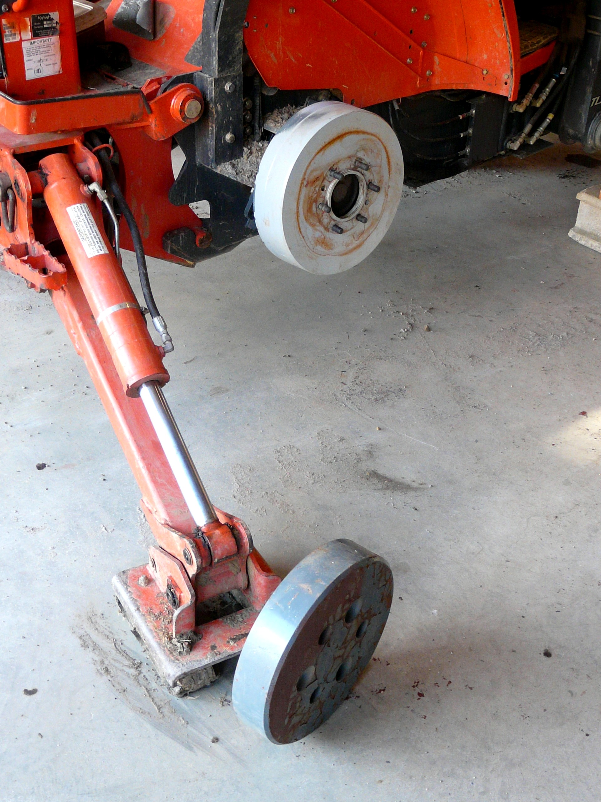

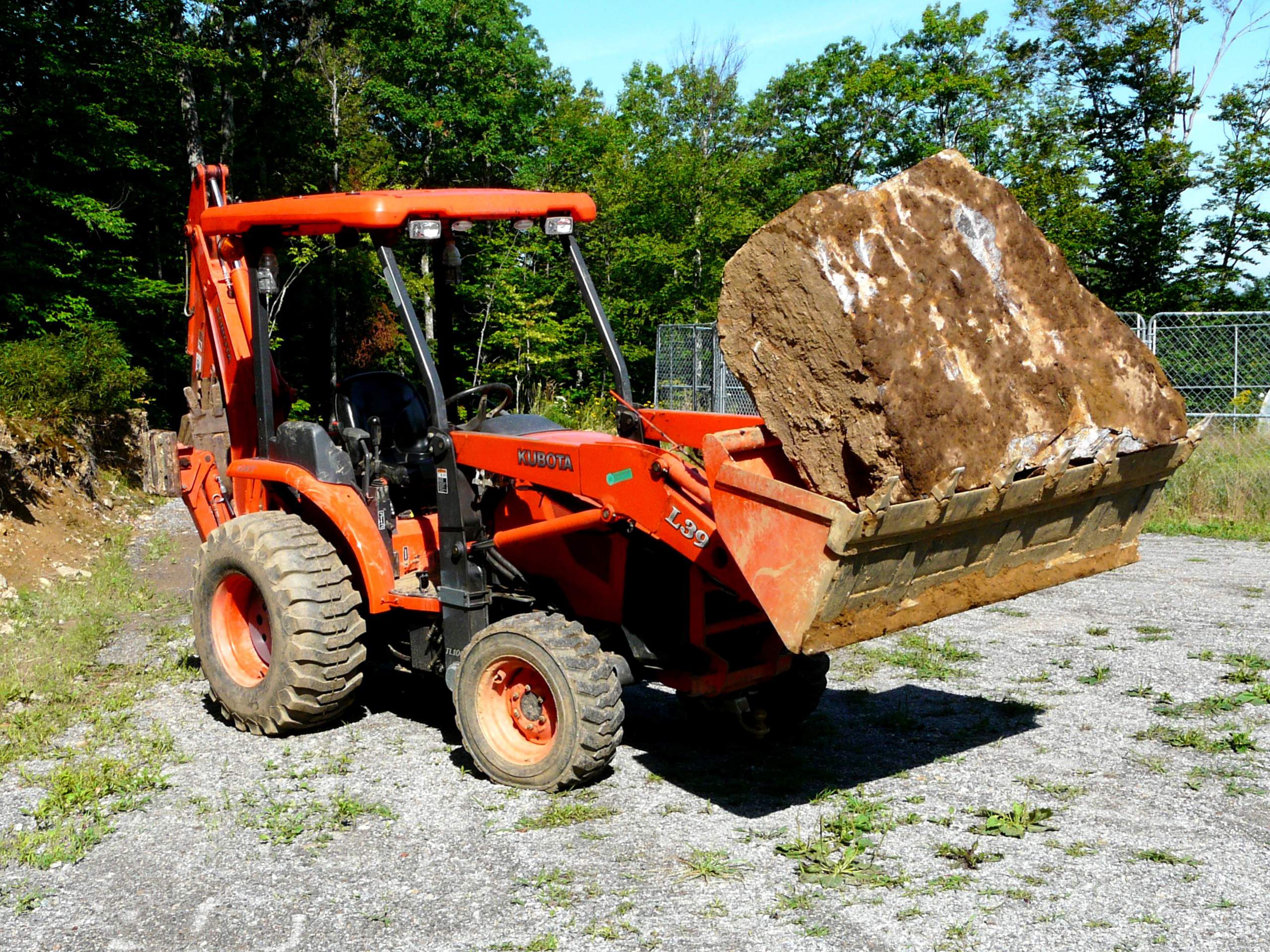

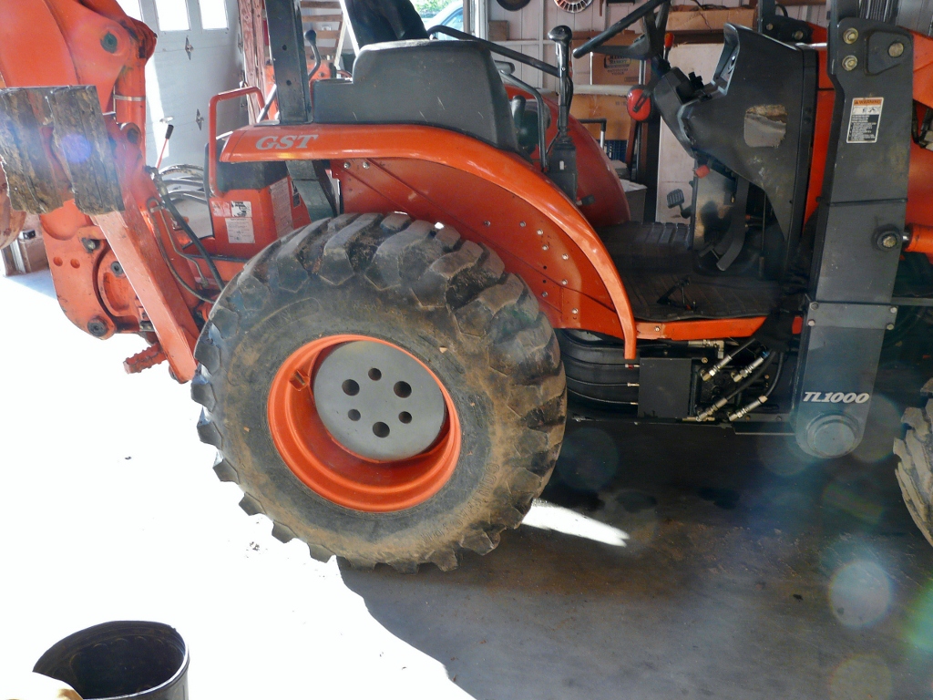

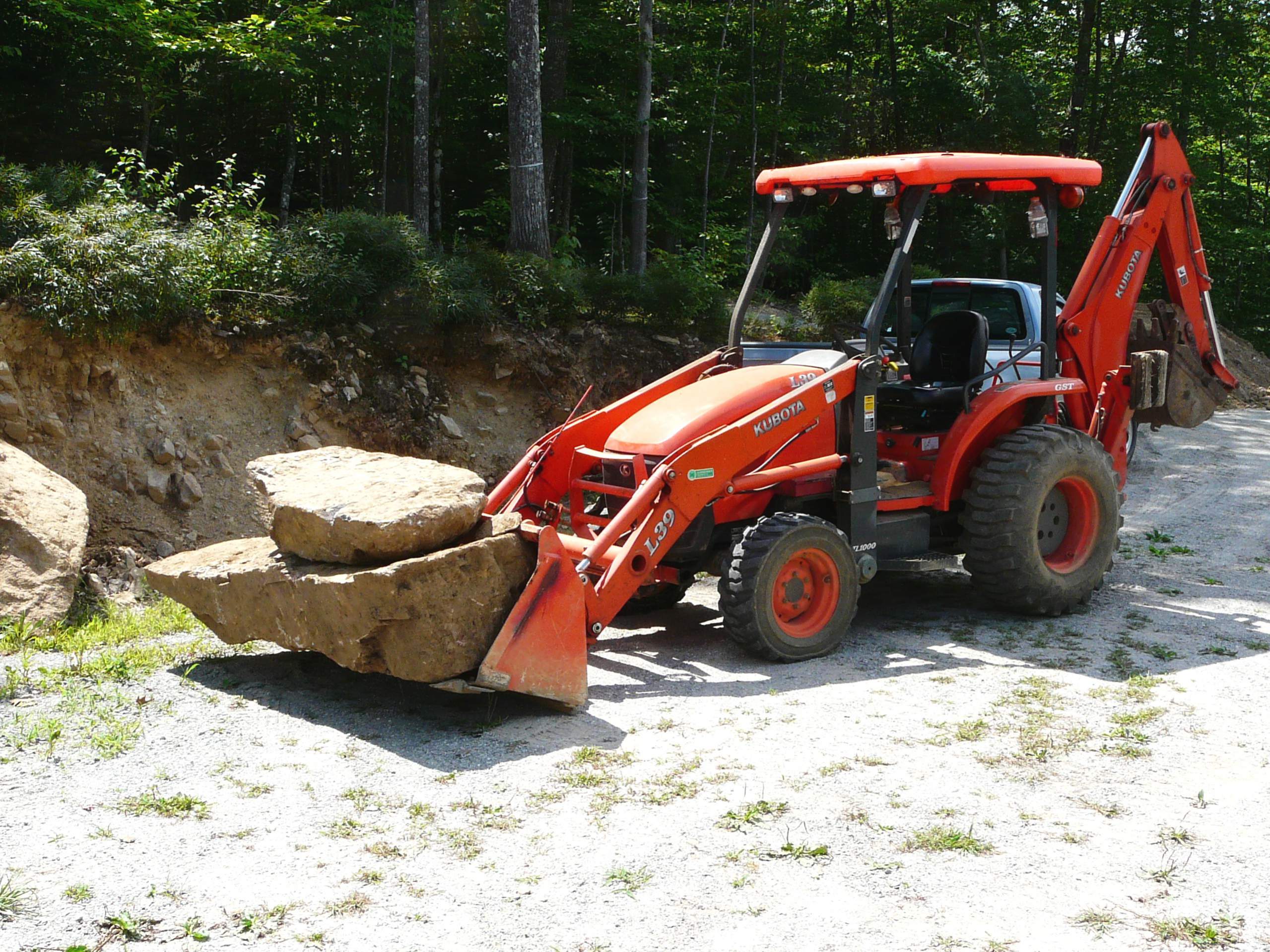

I take it you have an L39 without a hoe?
The hoe weighs about 825 KG and I have another 350Kg of wheel weights. so I advise about 10 Cu ft of concrete for ballast with loaded tires. Get the tractor near 8,000 Lbs for best stability.
