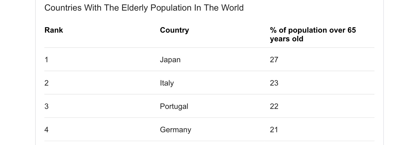

They must be doing something right on the healthcare end of it after the fact of the infections and Italy must be doing something very wrong.
Italy: 35,712 total cases 2973 dead.
Germany: 12,327 total cases 28 dead
This might have something to do with it also.
