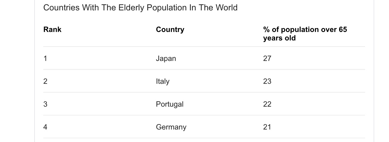

Tell me why the Germans have so few dead people.? Tell me why Italy has so many.
I'm not positive, but I believe Italy's got an older population.
   / Corona Virus #5 #97
Italy, Florida, same thing.
A population of older people on a peninsula in a moderate climate.
   / Corona Virus #5 #98
That can't be all of it. The fella in Portugal said that the German healthcare system is really really good and Italy's is really really bad.
   / Corona Virus #5 #99
Looking at the chart posted, they're only 2 percent different age wise, so yeah, seems close enough to not be age.
I wonder too then if their healthcare isn't as good, do more end up with other health issues that may cause problems ?
