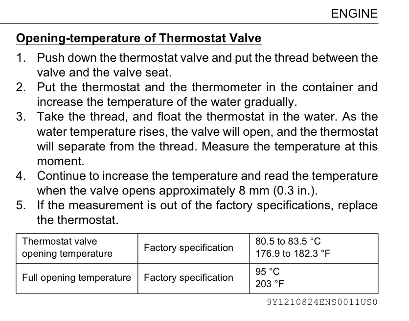

I don't have an LS, but my Kubota L4060 has what I believe to be a 180 deg f thermostat, so the coolant in the block would be regulated as in the following clip from the WSM :
I would imagine if you really want to know what your thermostat is you could either call the dealer or remove it and run the above test.
