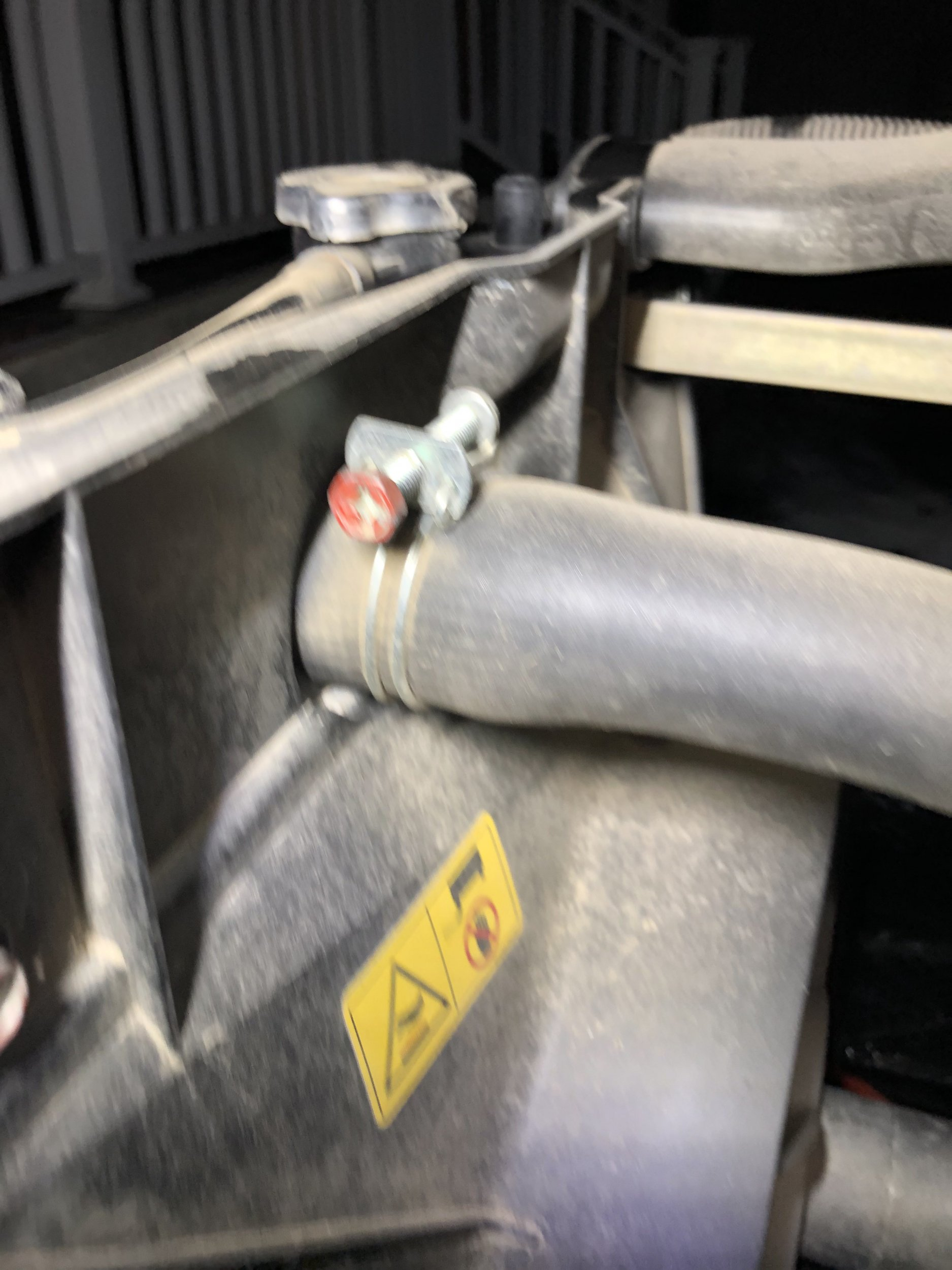

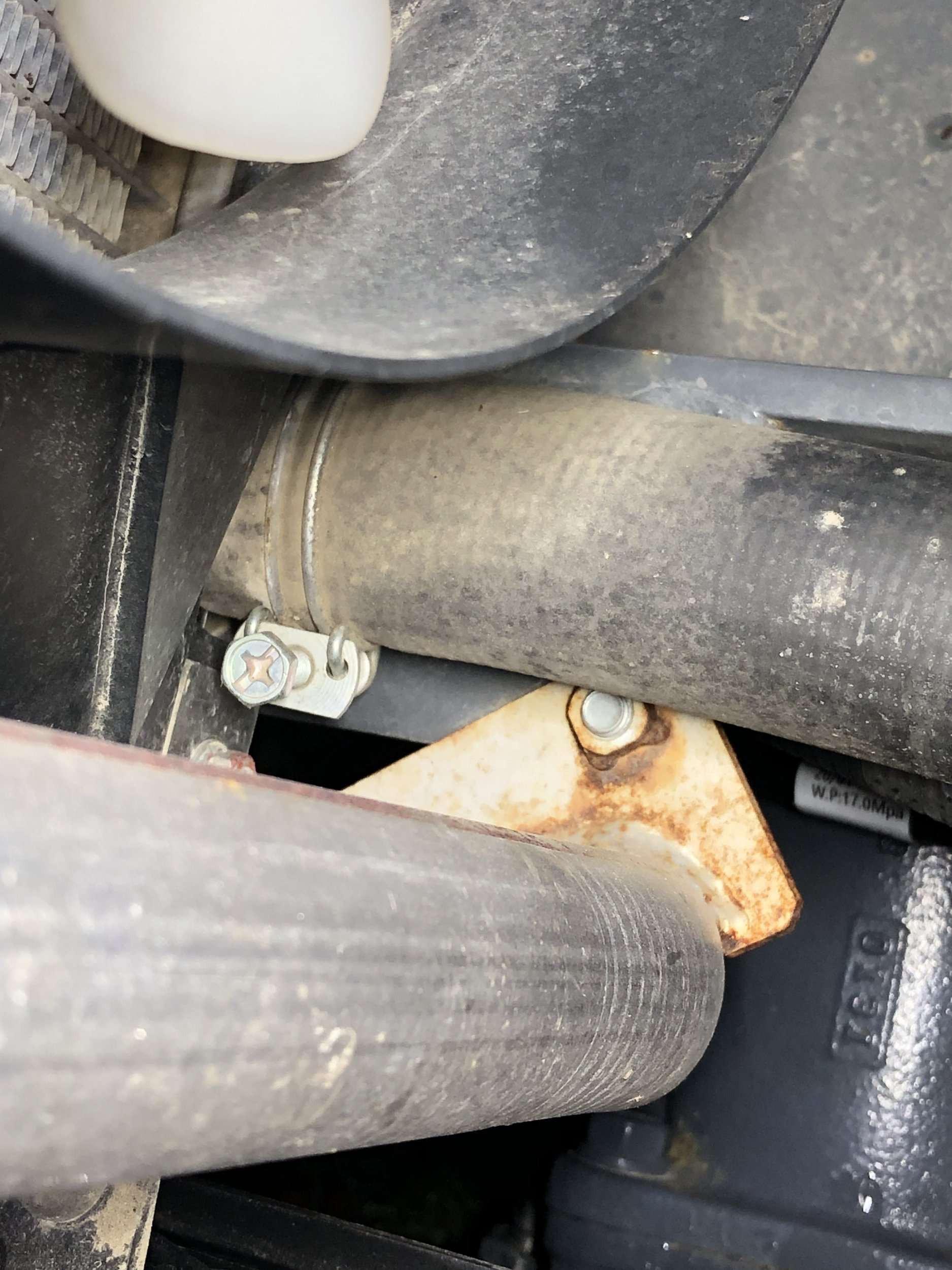

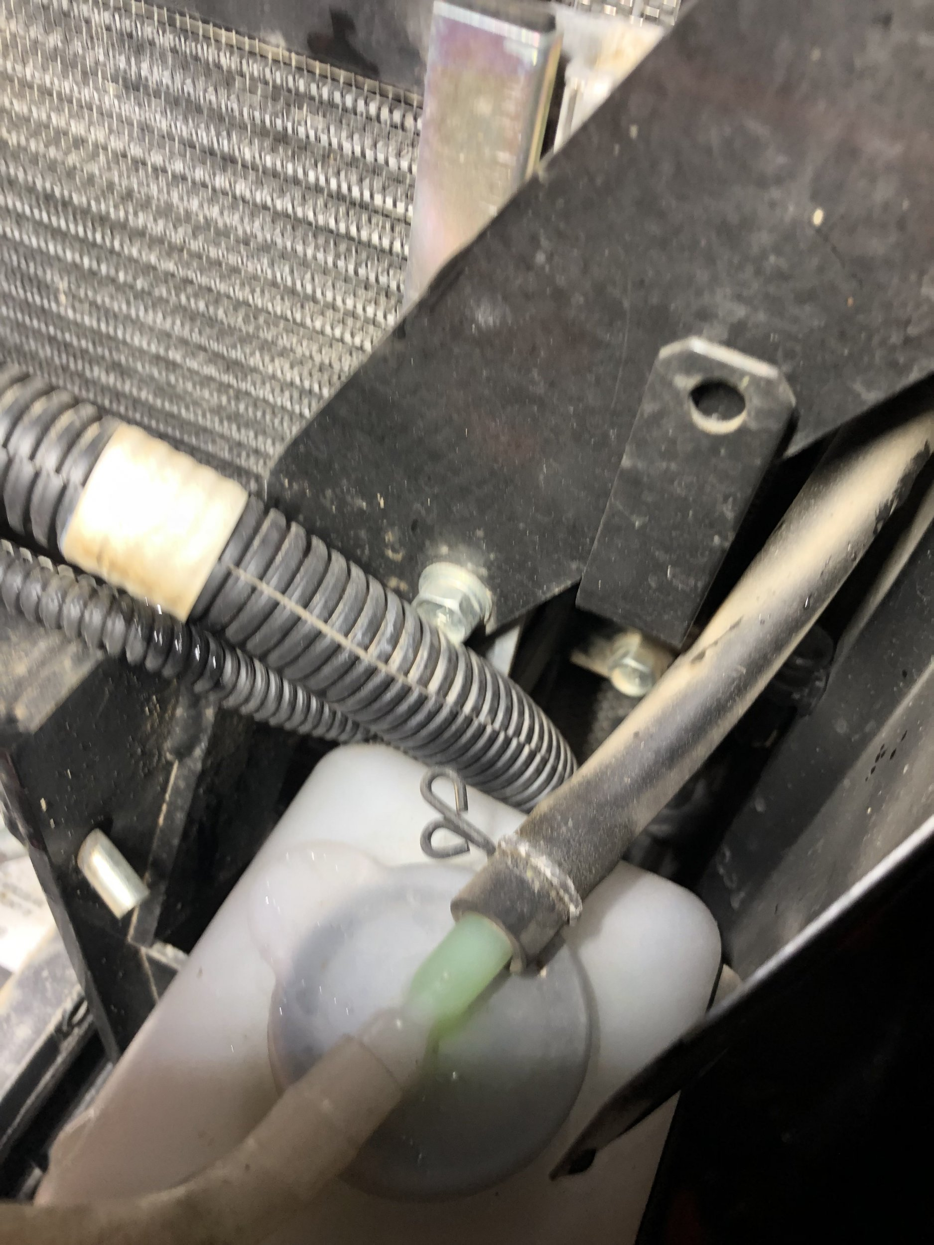

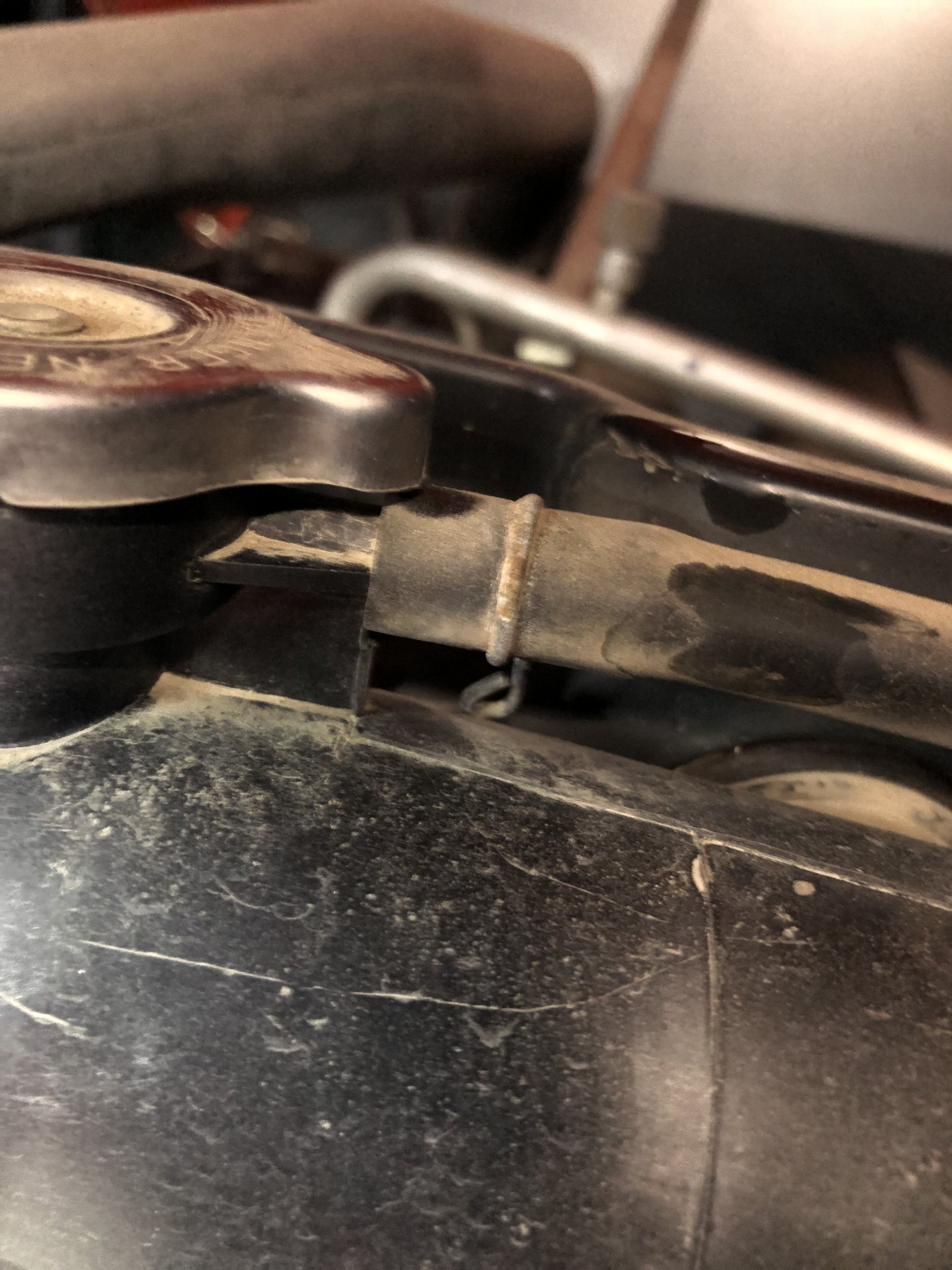

It's raining out right now, but took a quick look. The engine bay is dry, no leaks. I ran it for about 10-15 minutes on idle. The clamps on the small hose near the tank is. how would I tighten that one? The larger hose from the radiator to engine, I did not touch yet.

@JME81
There is also a large hose at the bottom of the radiator that I don't see in your pictures.
   / Coolant on the snow? #14
That small hose you circled does not need to be tightened; is good as is.

It is common for coolant to leak soon after shutting tractor off after working it. The reason being is there normally is a temp/pressure spike after it is shut off. Try looking for your leak about a half hour after shutting it down.

The factory clamps are fine.
If nothing is obviously wet, maybe you should just be sure the radiator is full and add some to the overflow tank, then run it - and watch it more.

None of the hoses you showed are leaking, and the level in the bottle is still good. The next step is to run the tractor for a bit while keeping an eye on the temperature and fluid level in the bottle. If the temps stay good and the bottle doesn't over flow, you are good to go - run with no worries. The little bit you saw on the ground was most likely just the engine burping out some air and/or excess fluid added in when the dealer did their pre-delivery checks. It happens.
   / Coolant on the snow? #20
The first thing I would do is look at the type of clamp that is being used, and ask myself if it is right for the application. A surprising number of hoses are poorly clamped. That will work for awhile, but eventually will leak. Maybe not much, but a little. And it's preventable.
The spring clamps are fine. None of the hoses using them are under pressure.
