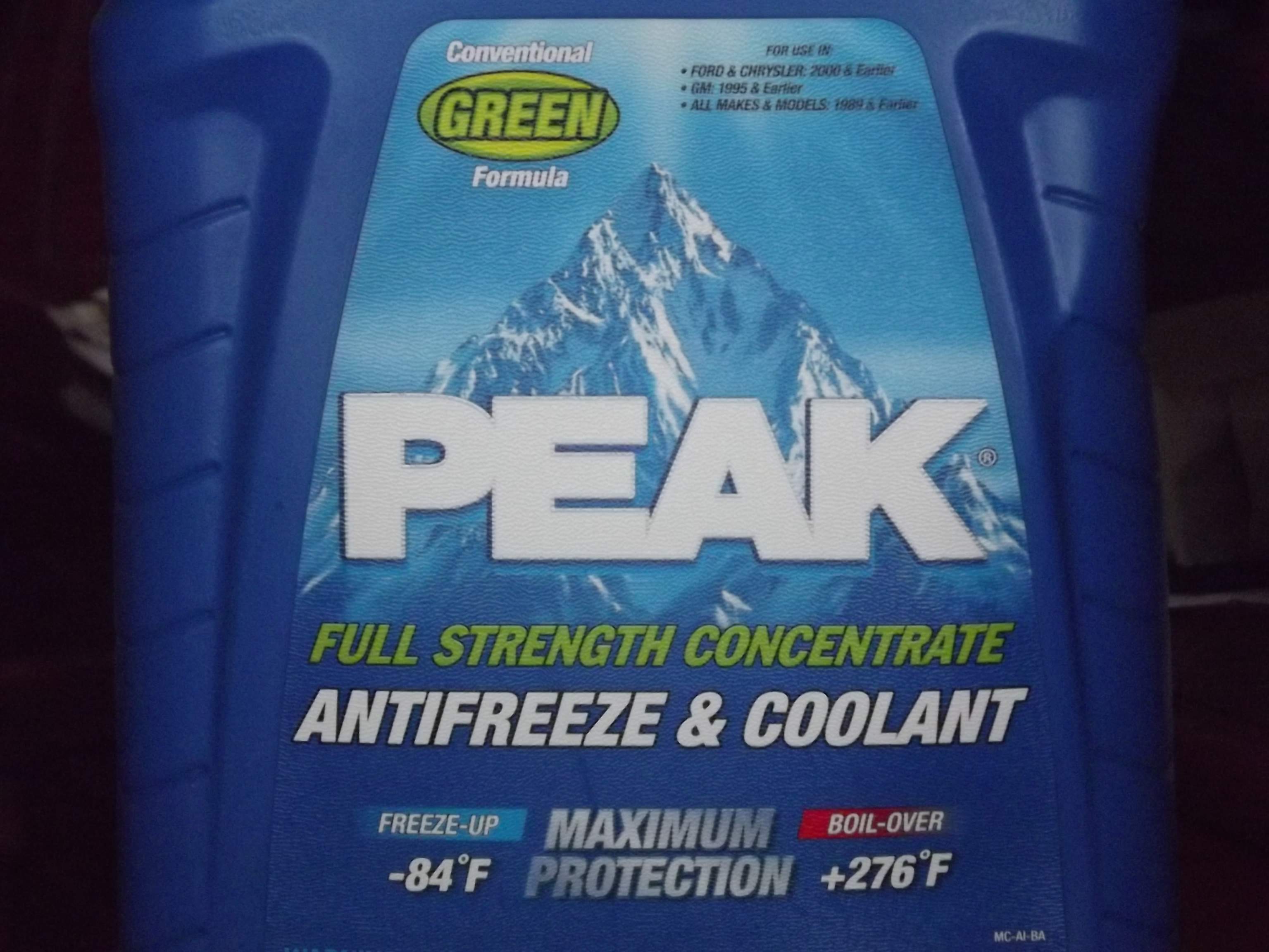

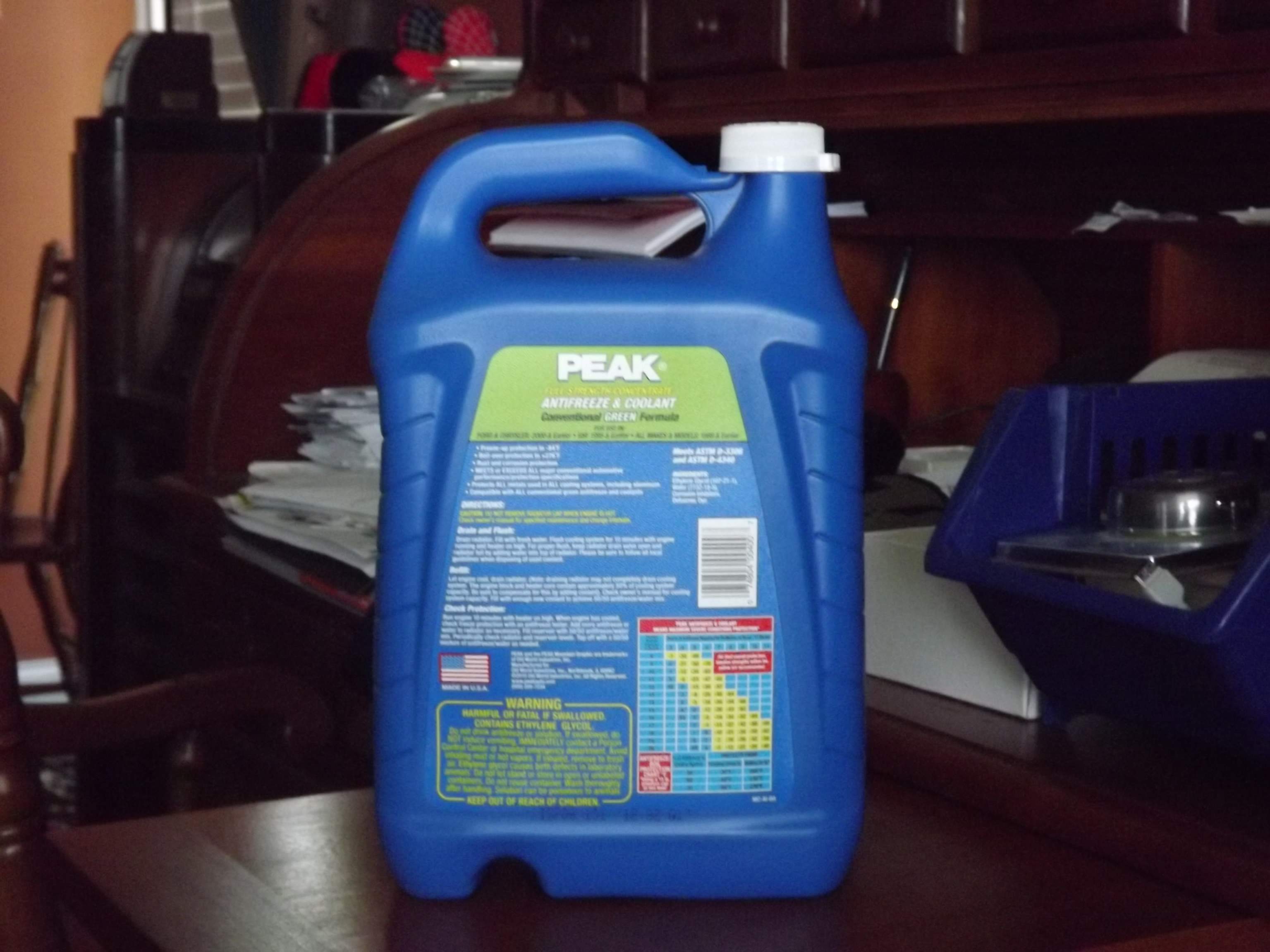

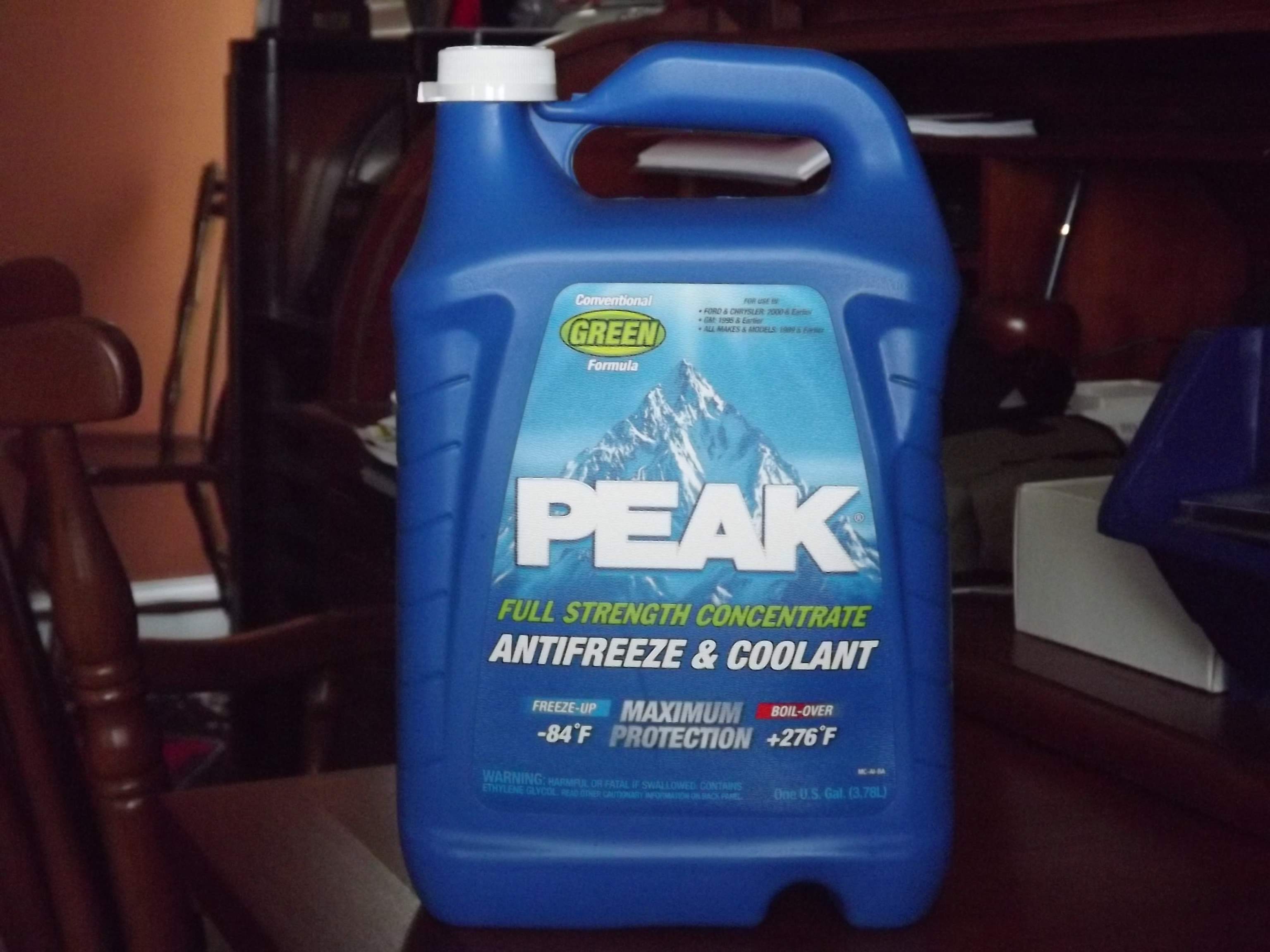

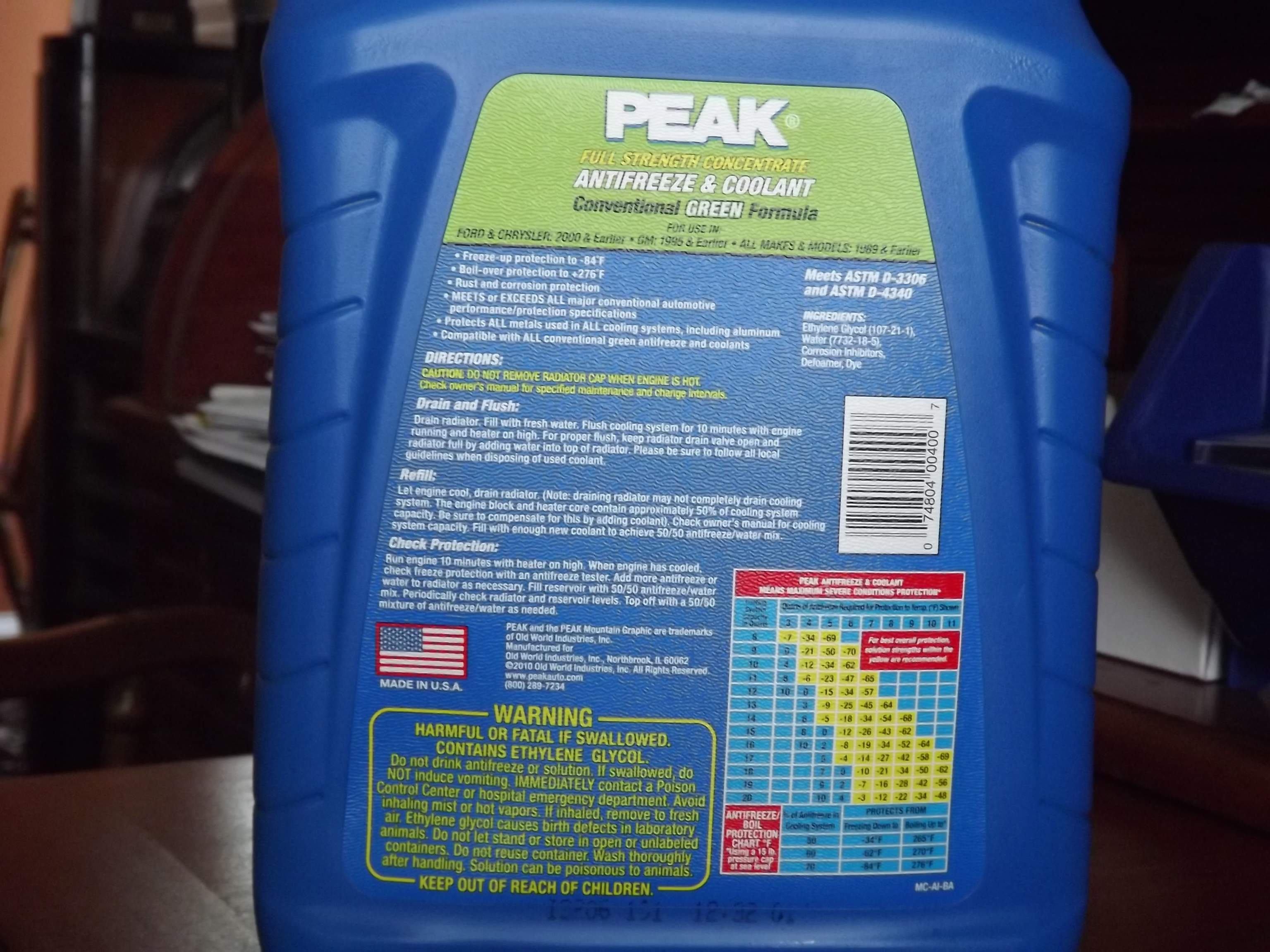

I picked up my 4 gallons of Peak antifreeze today and asked about the SCA stuff. Advance Auto had a small bottle for around $14 but I passed on it until I talk to Gary again at Barlows. I told the guy at Advance about my big concerns with cavitation since I'd been told about it and he just grinned and didn't really push the sale.
Including pics of the antifreeze I bought. It claims 5 years and many miles of useful life but you know they got to be lying, just promotional advertising crap. I'll do like the SUDT changers 5 times more often than Kubota recommends and change it every month to ensure I'm OK.
The cavitation noise only bothered me and not neighbors since I live pretty far from neighbors and when I was close to their homes, they were gone and my brother was mowing next door but he wears ear protectors when he mows to protect his remaining hearing. I have had this ringing in my ears all day.....Oops, I always have that ringing so not sure cavitation noise caused it.
Anyway, here's the pictures.....let the roar begin!!!! DSCF1501.jpgDSCF1502.jpgDSCF1503.jpgDSCF1504.jpg
