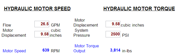

I have a toro 150 snowblower with pto drive and need to covert it to haydraulic for a college project. Im attaching it to a 2410 bobcat front end loader with a 26.7 gpm Where do i start.

How much HP did the snow blower require using PTO?
If you use a hyd motor, it will have to spin the rotor at a similar speed.
And of course you need the torque.
Assuming the snow blower took 20 HP to turn the rotor at 540.
20 GPM flowing through a 8.5 cu in hyd motor will turn it at 544 rpm, and the torque would be about 3384 in lbs or 282 ft lbs
The pump that pumps the 20 GPM, at 2500 rpm, at a 2500 psi potential, would use about 34 HP
26.5 GPM would require about 45 HP, and
You could run a larger hyd motor and obtain more torque.
