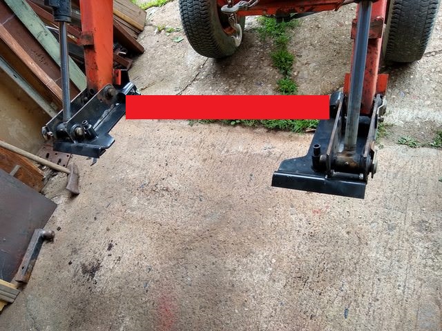

You should weld something on to connect the two new quick connect plates. This can help with both hyd cylinders moving together too. Not just what ever one has the least pressure on it.
I think it would add stability, looking at what ATI, WR Long and others offer they usually have a connecting bar. FEL-qa2.jpg
   / Converting my pin on loader to a skid steer quick attach system #22
Seams to me whatever the those quick connects are hooked to that becomes the connecting bar tube brace and or plate to both rams.
#23
With all the threads on here about twisting the connecting tube, I would not put one on.
If you retract the curl cylinders all the way before you hook up the attachment, it should work OK. If one side moves first, it will stop when it contacts the attachment plate. When the other side contacts the attachment plate, raise a little and curl back to seat the quick attach, then latch the levers.

My buddy has twisted his tube on his Kubota, I do not plan to put anything, my Massey 1540 I had didn't have anything and it worked OK, I think you have to get used to not moving them much once unhooked.

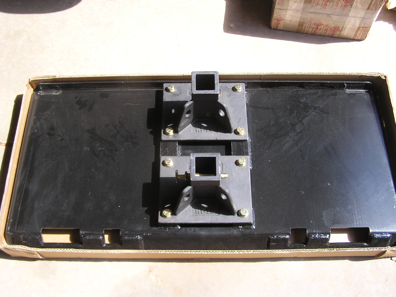

It's too hot for me to be standing bent over welding , it;s time I don't have right now. I will eventually do something with the spare plate I have. Any ideas? LOL
   / Converting my pin on loader to a skid steer quick attach system #25

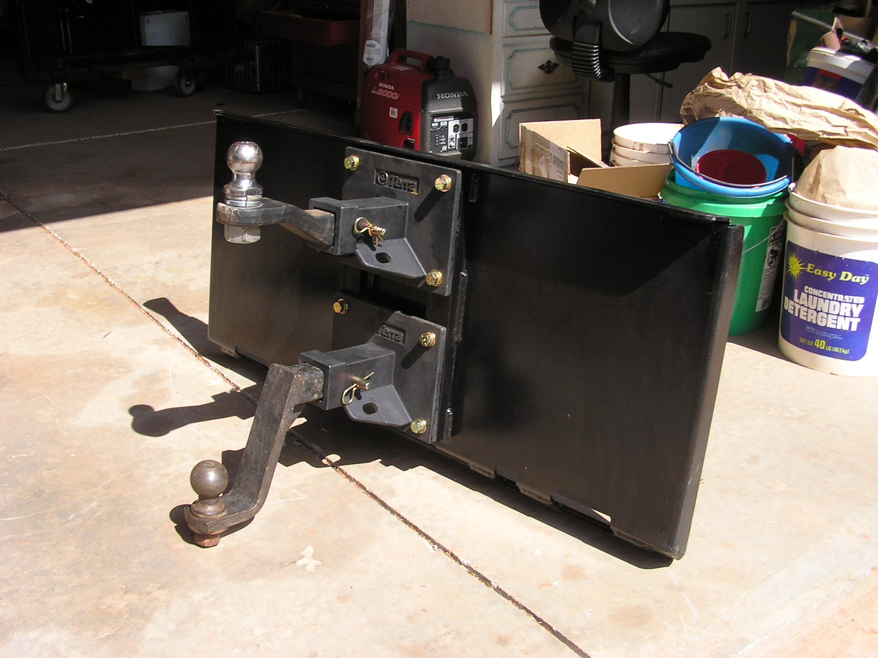

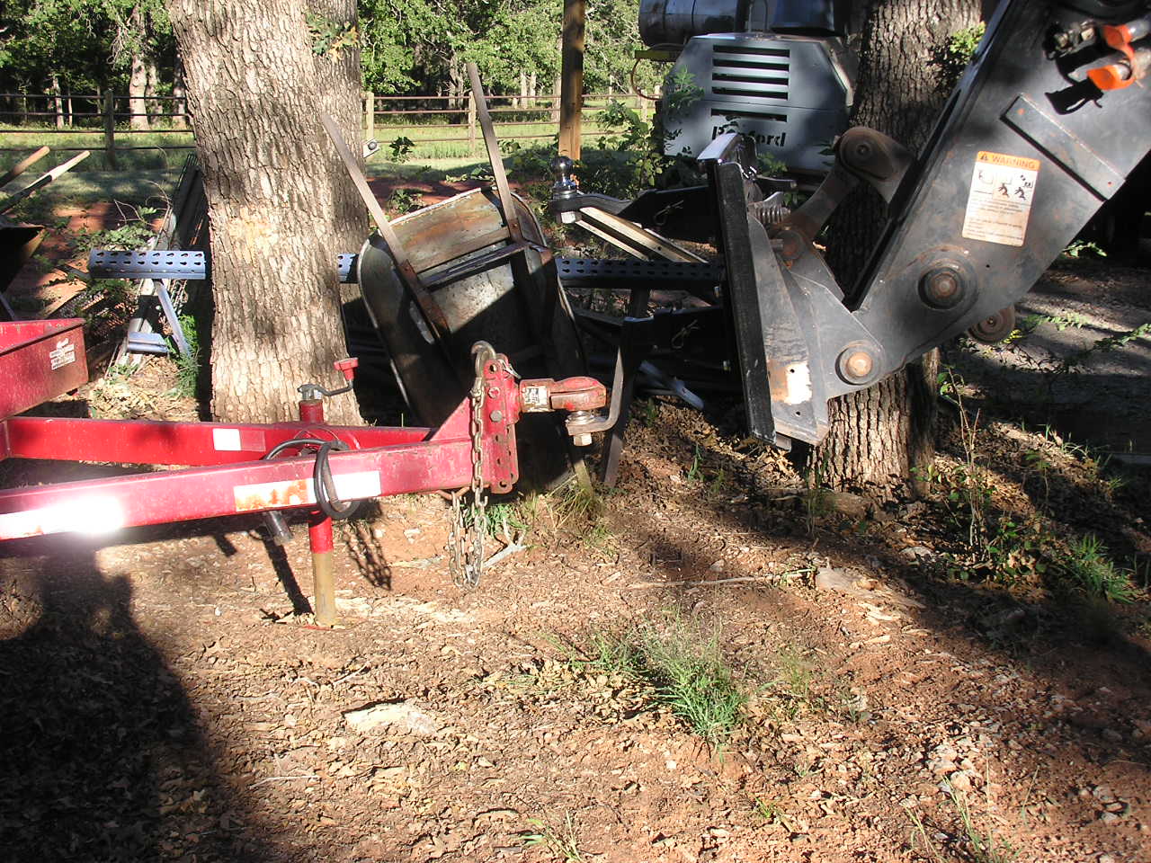

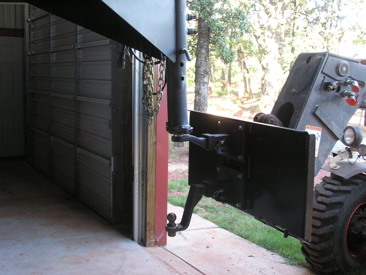

How about a trailer mover:
   / Converting my pin on loader to a skid steer quick attach system #26

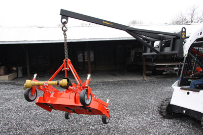

My ssqa trailer mover is very handy. Likewise my ssqa mobile hoist. Those would be my suggestions.

Thanks for the props and suggestions. I don't really need a trailer mover. I'll come up with something. I do know where there are some new old stock bucket that can be had fairly cheap, I didn't really want to do the work to convert one of them but since I have the plate and want a wider bucket...hmmmm
I only have a 60" and would like a 66". The farm store has a pile of nos pin on buckets.
