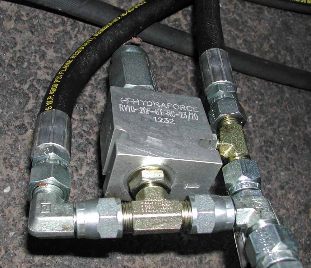

Sure. Here is a crossover RV that I installed inline on the work ports, limited to 2000psi. Not the same
as in a motor spool valve that connects both work ports to tank when off. But the pressure spikes of shutting
a conventional valve off are avoided.
Adding a crossover relief valve, similar to yours, is what I am planning to do. I'm looking at this Prince model:
Prince DRV Relief Valve DRV-4HH - Dalton Hydraulic
The implements I have and plan to build have no momentum issues so the valve should protect the hyd. motor and circuit. For any furure implements that have heavy spinning iron, I'll run a separate set of hoses and use a rear remote.

That Prince valve should work fine, and it has adjustable relief pressure. It serves to limit the pressure to your
hyd motor while driving it and kill pressure spikes when stopping it. It is also a large valve that allows flow-
thru for the work ports at high volume (30GPM).
The reason I went the direction I did with the Hydraforce valve is that it is considerably smaller and does
not have to be mounted anywhere. It also was less than 1/2 the price of the Prince. It has fixed RV
and no flow-thru.
Note that when making custom implements that use hyd motors, the most economical motors
for sale will usually be design-limited to 2000 psi (e.g. Charlynn S). To get motors that can
handle the full pressure of your tractor (usually 2500psi for the latest iron), you will need RV
protection like this. Hyd motors that can handle 2500psi and more will be a lot more expensive.
I ran my hyd PHDs slow, as I said, but I waited a while to get a good large hi-pressure motor at
a decent price (7ci White 255). I loved the instant-stop and reversible features.
