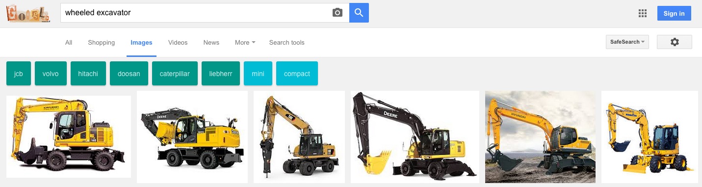

I keep eying them thinking of getting rid of the ford myself. But 90% of what I do is fixing field tile all within a mile of home. Would take FOREVER driving an ex there. And even if I trailered. Sometimes we get in a ~30 acre field that has 4-5 problem areas. Driving betweet each one would take forever as well. Thats the only thing I dont like about the excavators.

Those are pretty rare around here. And it defeats the purpose of getting a tracked machine IMO.
Tracked makes sense because its faster trenching because you dont have to raise the outriggers to pull forward, less ground pressure, lots more drawbar pull, better in mud, and NO CHANCE of flats.
I wouldnt want a wheeled ex for what I do. (fixing tile). I'd have the thing burried for sure. And I wonder how effective the backfill blade is is muddy situations?

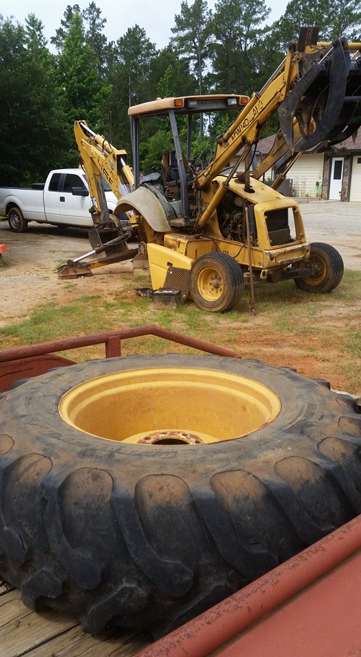

This happened during the week. My plan was to fix it Saturday, but the storms where pretty bad on Friday, so I let it sit a day before starting on it Sunday morning. I blocked under the axle so it wouldn't settle any more. Usually with a rear flat tire, the outriggers hold it up long enough to get the tire fixed and back on. But since a big hydraulic hose burst at the same time, I couldn't start the engine to raise the backhoe to get the tire on until the hose was installed.
To get to the hose, I had to remove another larger hose. This one was bigger then my largest wrench, so I used a pipe wrench to get it off. That hose went directly to the massive hydraulic filter and the hydraulic tank. It's been a few years, so I replaced the filter and drained the tank while I was at it. There was also another smaller hydraulic filter above those hoses that is very hard to get to with the hoses in the way, but easy with them out of the way.
The new hose was a little thicker then the original, so it was harder to get into place. The clamps didn't fit either, so I rebent them and was able to get them on without the washer. Just a nut.
Once it was all back together, I decided to change the oil too. Might as well.
15 gallons of hydraulic flied and 6 gallons of oil later, it was up ready to start up and install the tire.
Once that was all done, I drove it over to where my round bales are and I took off the grapple and installed the hay spear. Then it wouldn't start. Totally dead. No clicking, no power to the starter. I guess leaving the battery out during the storm caused the terminals to corrode enough to not get a good contact. I sanded them all clean and re did how the ground cable was hooked up.
It fired right up. I then drive about ten feet and it went out of gear. It starts great, but it wont go forward or backwards. One of the things I did when it died on me and wouldn't start was check the fuses. They where all fine, but since that's the only thing I touched other then the cables, I guessed that one of them blew on me. I checked them again, and then made sure to give every one of them an extra push to make sure it was set properly. That must have been it because it went into gear and ran great.
After feeding the horses their bale of hay, I took off the hay spear and installed the grapple again. Total time was six hours Sunday morning to get it running and feed the horses. I was so happy to park it and not have to fix anything else that day!!!!
