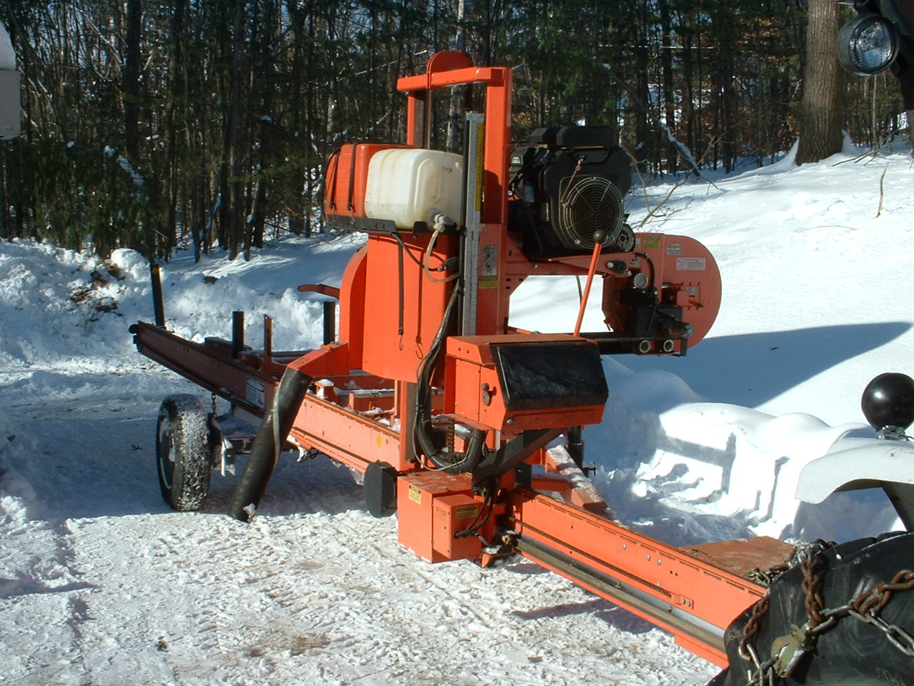

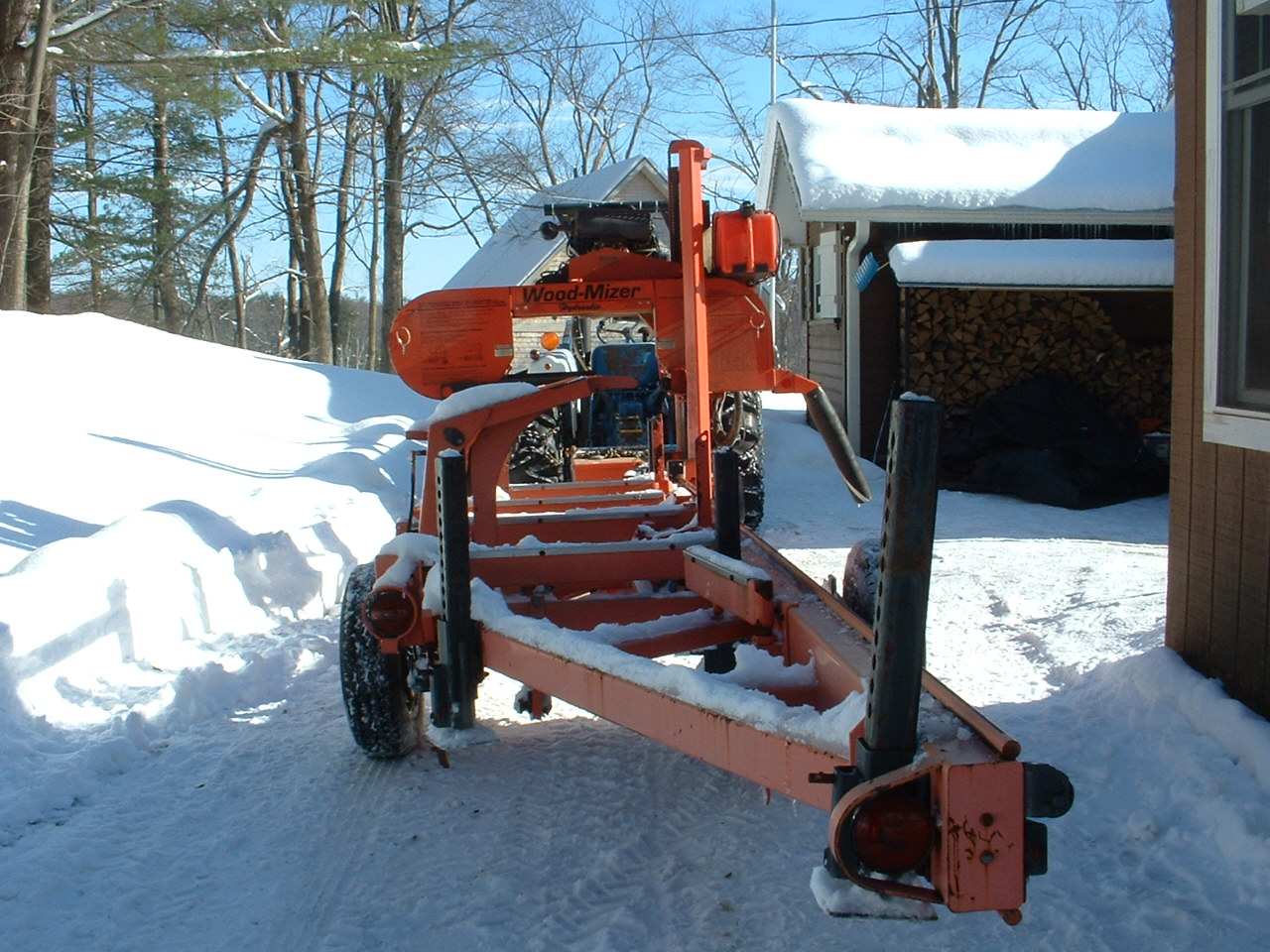

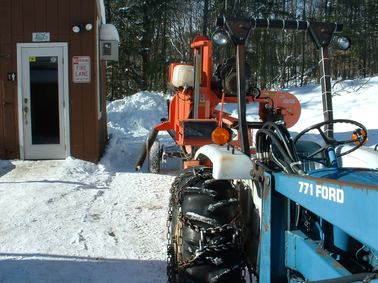

Thanks for the replies all, What I am proposing to do is cut customers wood to their specifications at the customers location. I think at this point there are more opportunities to saw other peoples wood than there would be trying to purchase raw logs and market finished products. Sawing at the customers location also reduces alot of logistical problems and prevents the need to store both raw logs and finished material on our property. I am not opposed to sawing small runs at our place but large jobs would be best done at the customers location as space is tight here (Unless we can purchase the 5 acres abutting ours,then we'd have a ton of room....Fat chance). The mill was purchased new in '95(?) by our neighbor for a project he finished many years ago and has sat idle since.......here are some pics of the mill...thanks again, Rick
