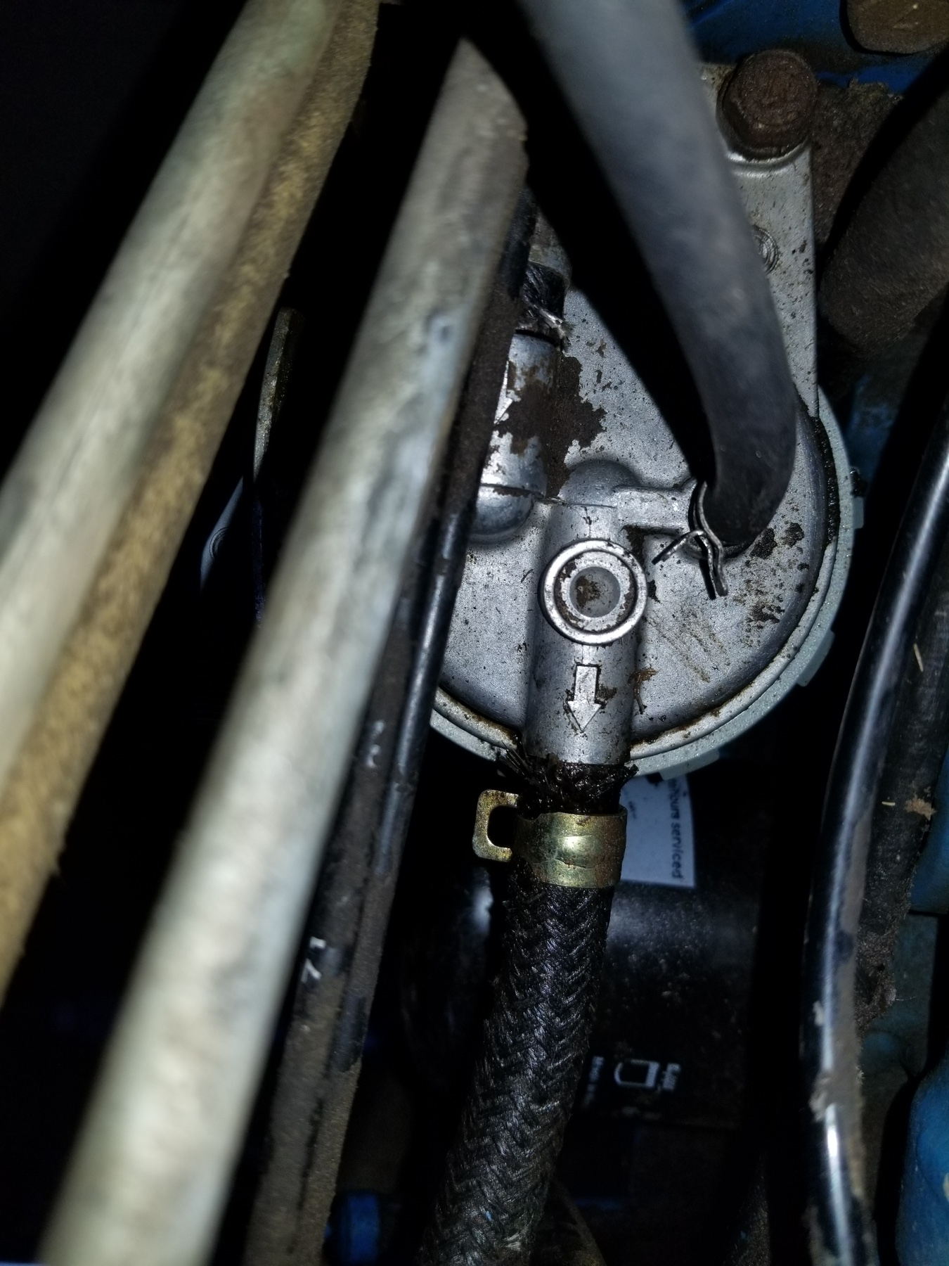

That my CNH dealer sent me the wrong hoses after we talked it thru twice confirming exactly what I wanted while looking at the same diagram is just SO frustrating!
I’m missing one of the low pressure return lines that goes either from the pump (?) or sediment bowl. NAPA said on the phone they had no such fuel line and I think I may have been talking to a moron so am taking the old one (replacement for which was not sent) there to see if in fact they have this low pressure fuel line in stock for sale by the foot. CNH charged like $20 for a simple rubber tube with no clips (“that’s extra”)

Just found this: TC29D stalling when hot
SOLUTION -
Drained fuel from tank. No water was seen in fuel in tank. Filled tank with 2 gallons of Methanol attached a rag to a stainless piece of 2.5 foot by 1/8 piece TIG wire and scrubbed the tank. There was a considerable amount of varnish and debris in the tank. This explains why the system would prime but when a suction was put on the tank it would suck the larger pieces of varnish into the 90 deg elbow on the bottom of the tank and clog it up.
Tractor is now running non stop.

I agree and am changing all fuel hoses this weekend. Already finished the returns and tested but no luck…

All hoses replaced and same issue. I never mentioned this because it seems so unrelated but I did put a new battery in tractor right when this started. Got the new battery in after it sat half full of fuel for 3 weeks with dead battery, installed new one and whammo—my problem began. Like I said I never mentioned it cuz it seems so irrelevant and the fact the tractor sat outside in 90 degree humid weather for 3 weeks seemed like a much more likely source of my problem. Note though I always use additives designed to avoid stale/bad fuel. I dunno.
