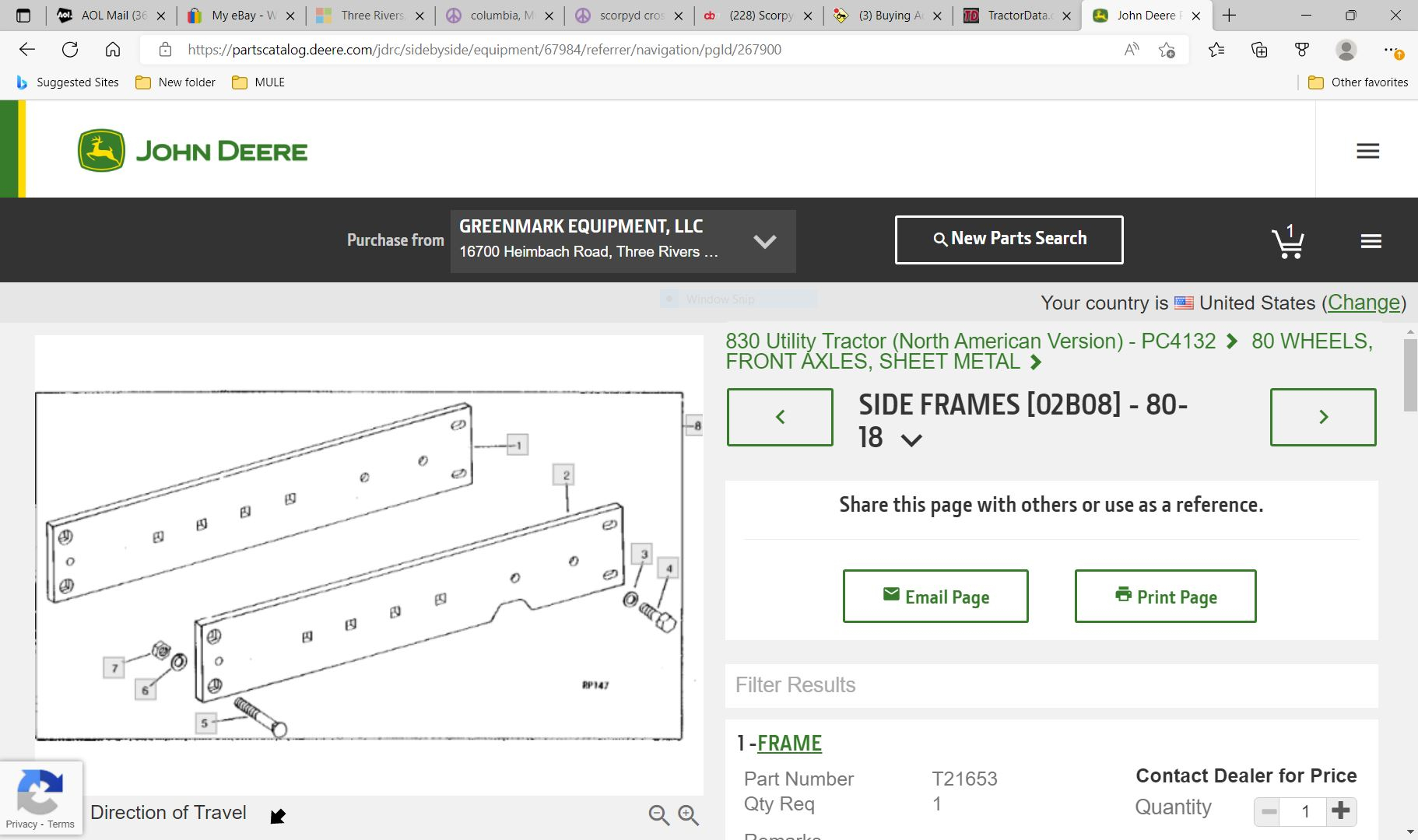

Thanks. I found that and found operating manual. I've read pretty much everything I can find. It's hard searching for it since there seems to be a bigger following for the late 50s early 60s 830. Plus I don't think there were all that many produced.

Steering could be manual or power. If you want a loader (or it has one) you will want power steering AND side frames. Side frames connect the clutch housing to engine and the front frame support (mounts to front of engine, front axle mount to it)
