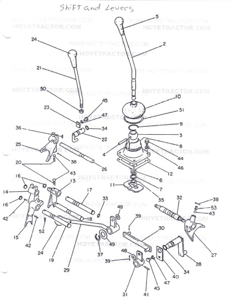

This may help and Tractor data Shows YM2500-YM3000. Many hours seat time on the YM2500 And I'm wondering if it actually has 2 PTO. shift levers. 4Spd. Easy to get stuck in between gears or Neutral. I'd check that and if not you can pull out the Whole Pto. Assembly unbolting it from the back and slide it out. Here's a Yanmar 3 Speed PTO. Dia. which my guess the problem is the shifting lever that has a pin that gets sheared.

Ym3000 Videos I watched a couple and remembering the setup and it does show 2 shift levers. L. side of the seat 2 PTO shift Levers and the R. side High low range Trans. Shifter lever. I can't remember the gear selection but I seen a Fredricks YM3000 tractor also. The YM2500 I was refering to was from Spalding tractor and a Fredricks Refurbish tractor. That's who I would be talking to about parts Etc.. The Pic. of it is in the Fredricks lot. No doubt about it! Been there! ;)

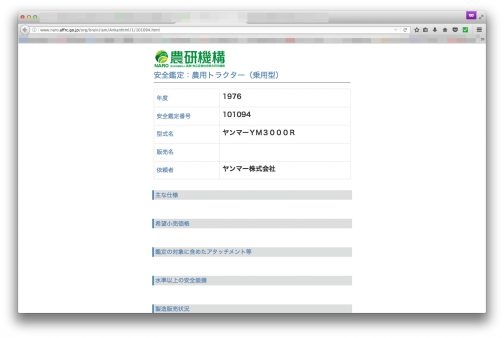

From the YM3000 parts manuals, there is a dual clutch in the YM3000R models. Just like some of those ODD JD850/JD950 machines with the dual clutch.
The YM2500R, YM3000R have the same bell housing for the dual clutch setup. Over on the MyTractorForum and on the GreenTractorTalk sites, there are a few threads in the past 2 or 3 years on the dual clutch issues. Either finding the parts or figuring out the right parts.
If the normal clutch was installed, then yes, the PTO will not turn anything attached to it.

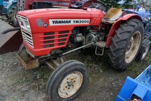

When the YM Gray Market machines arrive here, those restoring them repaint and apply the new model decals. All the time the "R" is left off causing troubles just like this.
Posting manuals here is not allowed. However, on the YTOG, you can snag them for free. Ideally you would want all the YM2500, YM3000, TM1192 Deere siblings to sort all of this out. If you are OK to split the tractor and spend about 4 to 6 hours going slow and checking things with the right replacement parts, the machine can be up and running once again.
