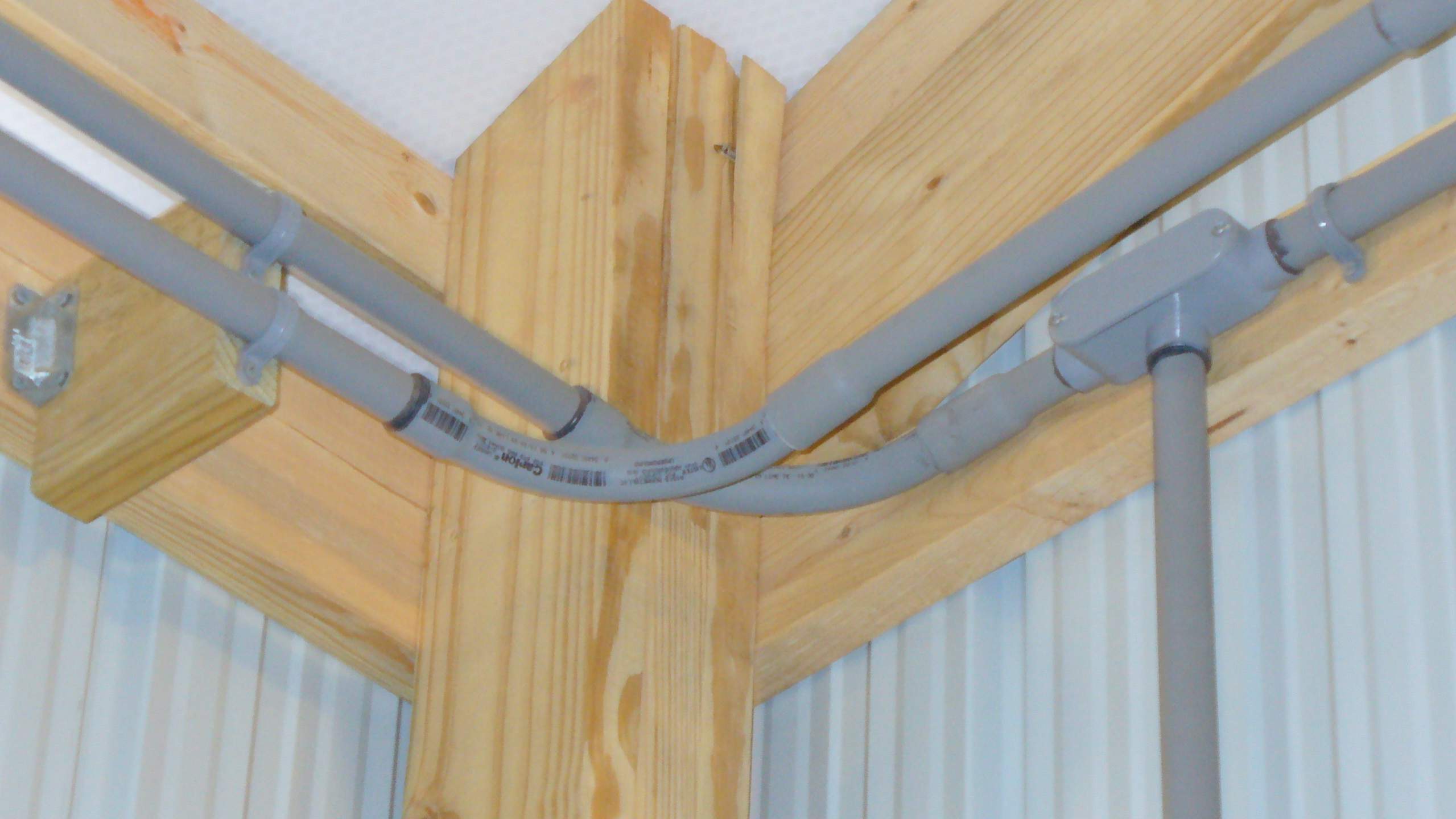

I've deceided to use plastic conduit for wiring the rest of my pole barn. I'm trying to figure out how to neatly get around the 4x4 in the corners. I'm running the conduit up from the panel and along the top of the wall and on top of the posts There is just room for 1" conduit up there. I'm going to use a "T" every few feet to drop down an outlet. But how do I take the conduit around the 4x4 in the corner. Putting a 90 in moves the conduit out several inches from the wall. I'm sure there is a part/piece are something I need to do. Suggests? Thanks.
/ Conduit in a pole barn - corners? #2
Heat up a section and custom bend it.
You say the 90 will bring it out to far, you mean the sweep 90? They do have what's called LB (line bend, I think) 90's that are short and have a screw on cover to help with pulling wire. Might take 3 of them with short stubs between them.
Maybe a couple of sweep 90's cut short as possible and a LB between them?
Another way would be a 45 on each side wall and go across the corner at 45*, that would not be as tight but might not be bad.

I second the 45 degree connections. you can always take out a tiny notch in corner of 4x4 for the conduit when doing a 45 to tuck it in further and neater so you can put things in the corner and not touch the pipe.

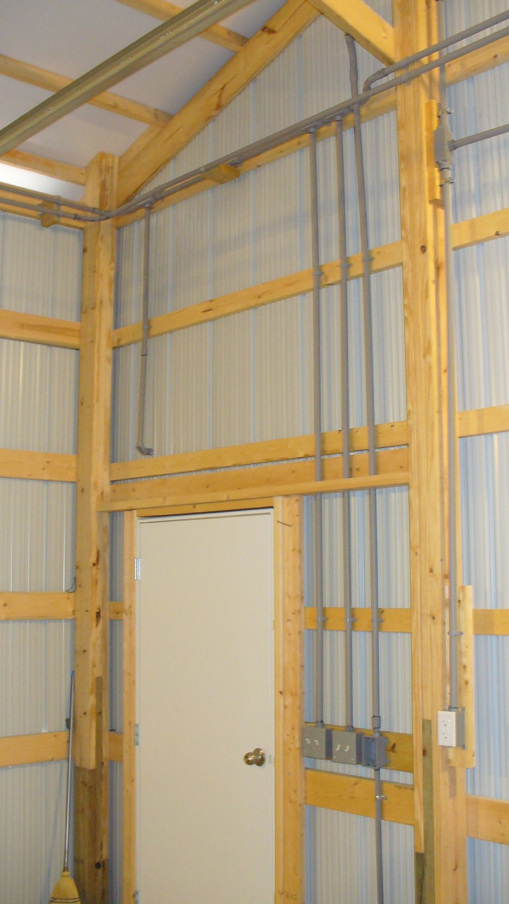

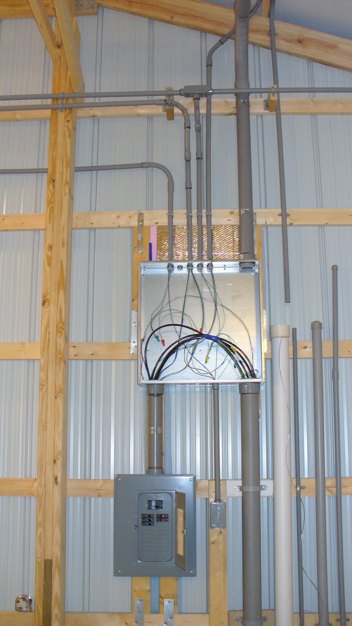

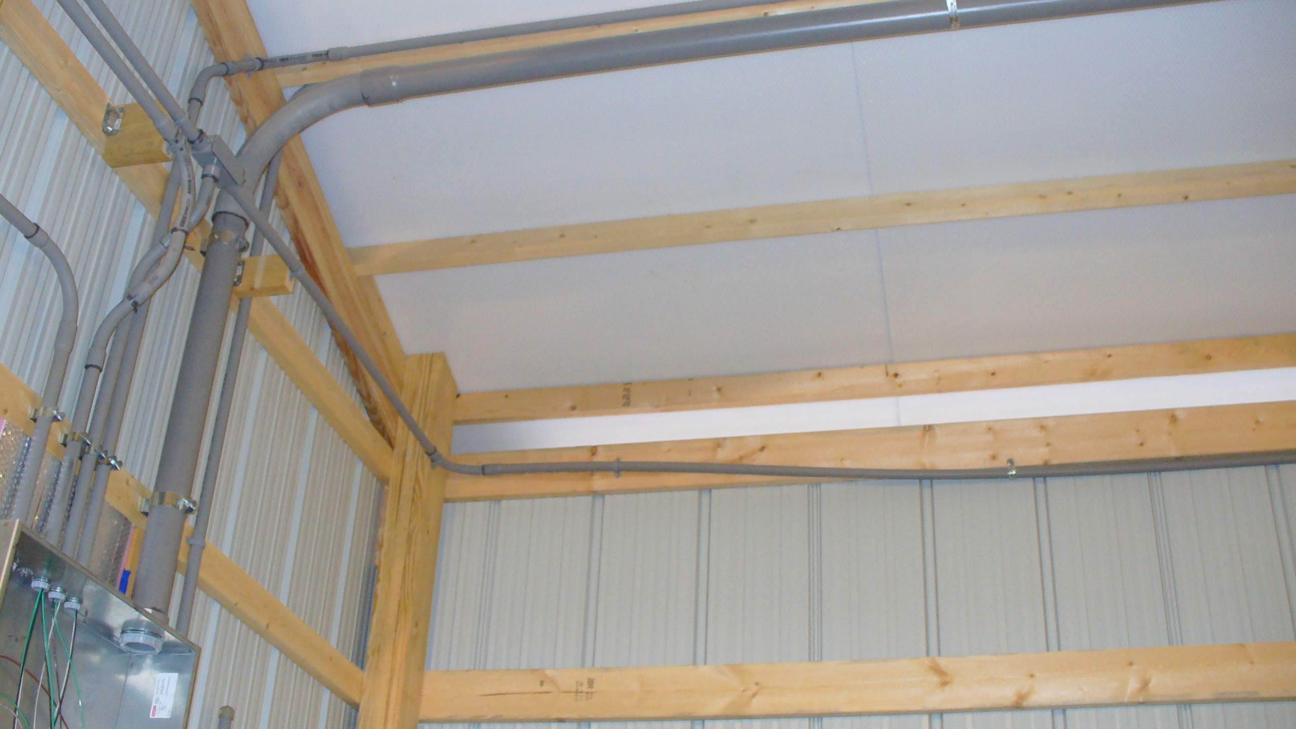

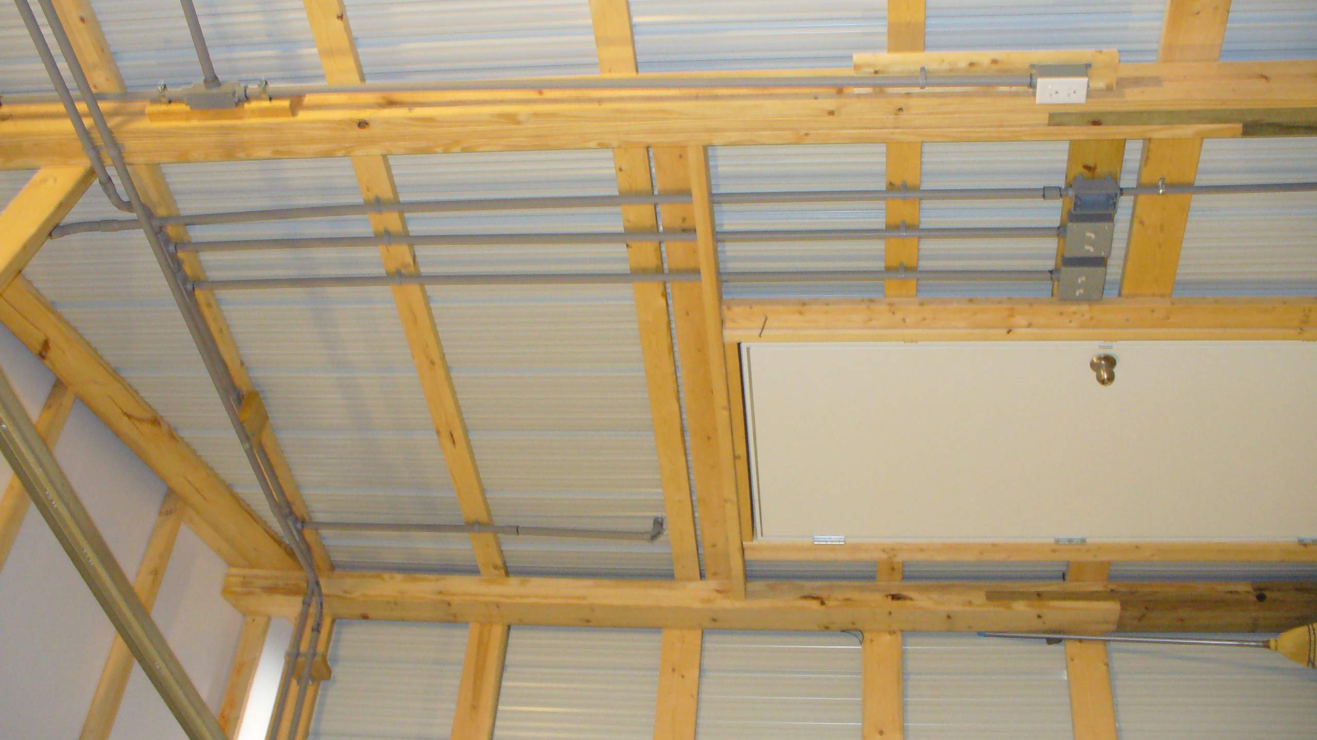

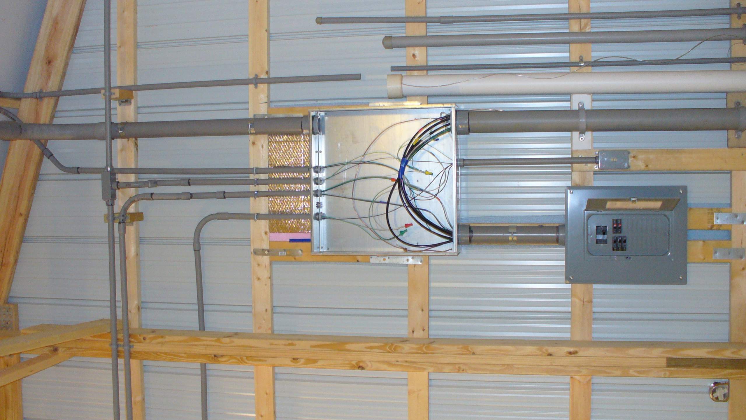

I'm a little late to the game on this thread, but I just got some pertinent work done. So here are four pix of how I did some conduit work. I've left these as BIG images so they can be zoomed in on.
The almost done tractor garage is 65 feet from the house. It is 30' x 40', with a 10x10 door and a 12x8.5 door and a people door. I have a 100 amp sub panel in it that is fed before the transfer switch for the whole house generator. I also ran a 15 amp circuit for the lights that is on the generator side, and a 20 amp circuit so that I have one outlet when the power is out. That outlet also powers the outlets for the garage doors.
Currently I have three 20 amp circuits on the panel for a total of 4 20 amp 120V outlets in the garage.
There is also conduit for an air compressor that runs to a small adjacent structure (so I don't have to listen to it). So eventually there will be air, water, phone, security, and video surveillance. I've got lots of pix and will make a small web site when this is all done.
But for now, here are 4 big pix that show some conduit being run in a pole barn. The main idea is to keep all horizontal runs at about 12' in the air and drop down vertically to switches and outlets. After insulation is done, I can put up 4x8 plywood to the 10' level to protect all wiring and insulation (both from physical damage and UV exposure). 1st two pix looked OK on my machine, not sure why they are rotated here.
You can also see where I ran some runs behind the poles, and the last picture shows a transition from inside to outside of the poles.
Hope this helps and gives some people ideas.
Pete

Lets see if those 1st two pix are oriented correctly now...
OK, guess the site didn't like the 1.2 mbyte size, and when it squished them it lost the rotate. I cut the size back and it kept the rotate OK If I'm missing something on being able to edit, delte, or modify thumbnails attached to post let me know.

tommu56: No particular reason I used couplings. It was a 90 degree world, and I kept the bells pointing in one direction. Also, this was 3/4" conduit with either 1 or 2 #12 circuits or 1 or 2 #14, so there was lots of room.
There are a few places, like coming out of the big 2' box where I used two 45's to get up off the wall, and then a 90 where I could have done a bend.
I was also a one man band, so using the pre-bent pieces allowed me to stack, plug, and try my way through to approaches. Sometimes it's easier to try a few things then to think and get it right the 1st time.
Bringing the conduit in from the ground, I did bend some 45's and 90's to get a custom fit. this was on some 1.5" pipe and 3/4 pipe. I did an outside flood light this afternoon, and I really should have done a custom bend. But, by the time I realized it I was 80% of the way done. Tomorrow I do the other light, and will probably custom bend it.
I did try to custom bend a 2 1/2" piece once, and it did not go well. I suspect if I did more of this type of work, I'd bend more (and have more tools to do it). And of course only when you finish a job do you really understand how to do it ;)
Pete

I was so focused on the conduit I forgot to mention something about the wiring. Where you see the wire nuts in the 2' square box, the wires are tightly twisted together, then soldered, and then the wire nuts make a colorful decorative insulating cover. I've never been a big fan of them when currents could get high or when in outdoor environments. I did use them when I wired the lights up, but remember that each bulb (compact florescent 23W, 1300 lumen, equivalent to 90 watt incandescent) draws about 200 mA, so where I had three of them it's still .6 amps. Even a wire nut can handle .6 amps :)
