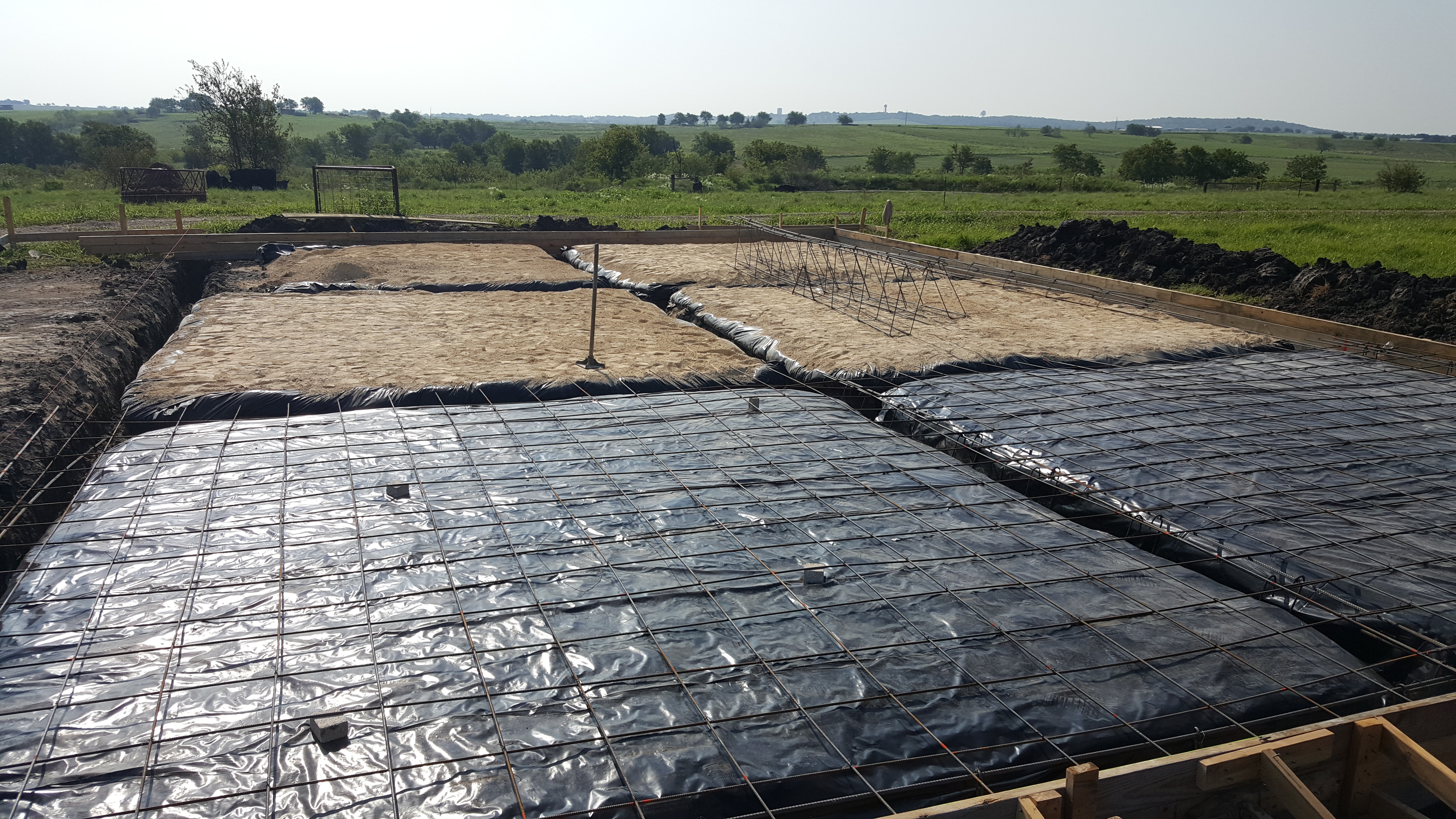

Last year i had an engineered slab, 40 x 60, poured. 4 loads of material for the pad, 4 ft perimeter beams, #5 rebar in the beams and #3 in a 1'x1' grid. 100 yards of concrete.
$24k
Black land is great for growing crops, not so good for concrete.
-Plowboy 57--what he said...I am on the same black land prairie. I have had 3 engineered slabs don (one for the house, one for an addition and one for my shop). They were all stamped. All of my foundations are pretty much as joeu235 said. I am only one of my neighbors in 17 years who has not had foundation problems.

Your soil is famous for being some of the worse there is for building on. You really need to talk to a local pro that has a lot of experience building on that stuff. It's super expansive when it gets wet, and when you have a freeze, anything is possible. Then when the land dries out, you end up with massive cracks in the ground and foundation failure.
From what I've read, you need massive beams in your foundation, which are similar to footings, but bigger, deeper and running around the perimeter and more importantly, through the interior of the base of the slab. Cost for a slab there can easily be twice or three times what it costs for me in East Texas on red clay.

Here is a pic of my shop slab.

Interesting problem with the shifting ground. I wonder if you could do what is done when laying tile by floating it over a flexible substrate.
So pour two thin slabs and let the bottom one move around without effecting the top one.
/ Concrete slab cost #26
The 6 center sections in my above picture are very similar to what you describe with tile work. The contractor put down 6 mil poly, a foot of compacted fill, a layer of poly, another foot of compacted fill, and then a final layer of poly. The fill and poly were put in in such a way that the looked like giant pillows.
