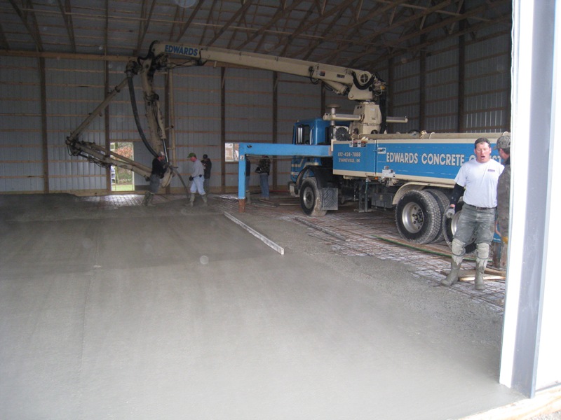

Nope, I didn't do the form work. There are many compound curves and I didn't have the forms; especially for a 6" (not 5 1/2" most get when they say 6") driveway. I did clear all the sod and use my laser level to level and compress the #11's used for a base though. ;) I even cheated and used them to get to the far reaches inside my barn to save my back since it was a 10" pour. The wire matting was sat on little plastic "top hats". The picture was just before the pumper backed out of the barn and the 1/4" mesh was put on the top hats and the rebar added.
They came back and cut the joints in rather than form them in during the pour. I honestly have no idea which is better. After a couple of years of running heavy equipment in and out I do have a few 'cracks' in the floor, but they have not moved apart nor vertically; just small cracks you can see when the floor is wet. My other barn was done the same way about 15 years ago and once the few 'cracks' appeared, nothing more happened, so I'm happy.
WOW - I am having a bad case of Barn Envy! What a super space....
Cracks - If you are parking heavy equipment on this slab and all you have are a few hairline cracks, you have done well. The fiber additives are supposed to control that issue, but I am not convinced that they do very much good.
Cutting control joints - Cutting them after the pour or using pour-in-place joints are two ways of getting to the same end...creating a stress riser to allow expansion forces to crack the slab in a place of your choosing, or building in enough movement room to prevent cracks from forming....in either case there is an "interruption" in the surface of the slab.
I have used the pour-in-place control joints as surfaces to screed...one advantage of that technique...
