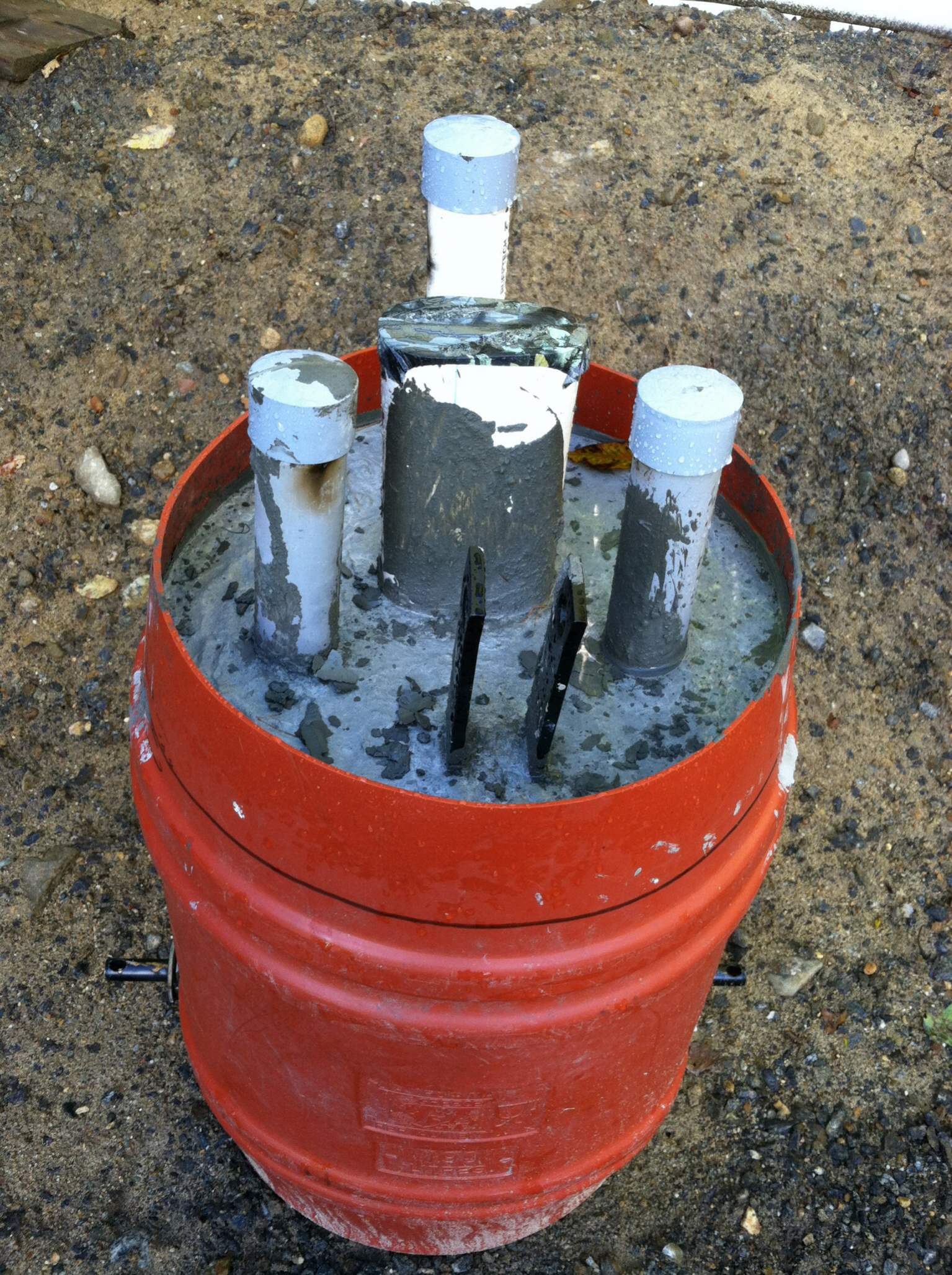

Hi all, I'm making one of those concrete filled barrels as a counter weight for my tractor - an opinions on filling it with concrete - do it all in one go or do it in stages and let the concrete set up in each stage?
Thanks,
E.
/ Concrete barrel #2
One go, make your mess all at one time and you're done although it makes no matter for a counterweight. Structural you want to have it in one homogeneous mass with no areas of lamination....Mike
/ Concrete barrel #4

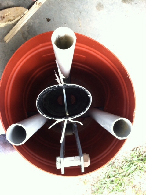

Agreed, all at once. Be sure to add some PVC pipes for rakes and shovels. I even heated a 4" pipe and made it elongated so I can either put in my D-handle snow shovel or my chainsaw.
I also added a 2" receiver for any trailer I wanted to pull around.

^ this, as above. I put in 3 two inch PVC pipes, I wish I had put in 4. The two inch receiver hitch welded in is good too. I wish I had throwed in the mix a couple hundred pounds of old steel nuts and bolts or some such for the bottom to make it heavier while being able to leave some space at the top for carrying things. (chains etc.). Of course it depends on how heavy you want it to be. I made if for my previous tractor, and it was about perfectly weighted, but my current tractor could use a bit more weight.

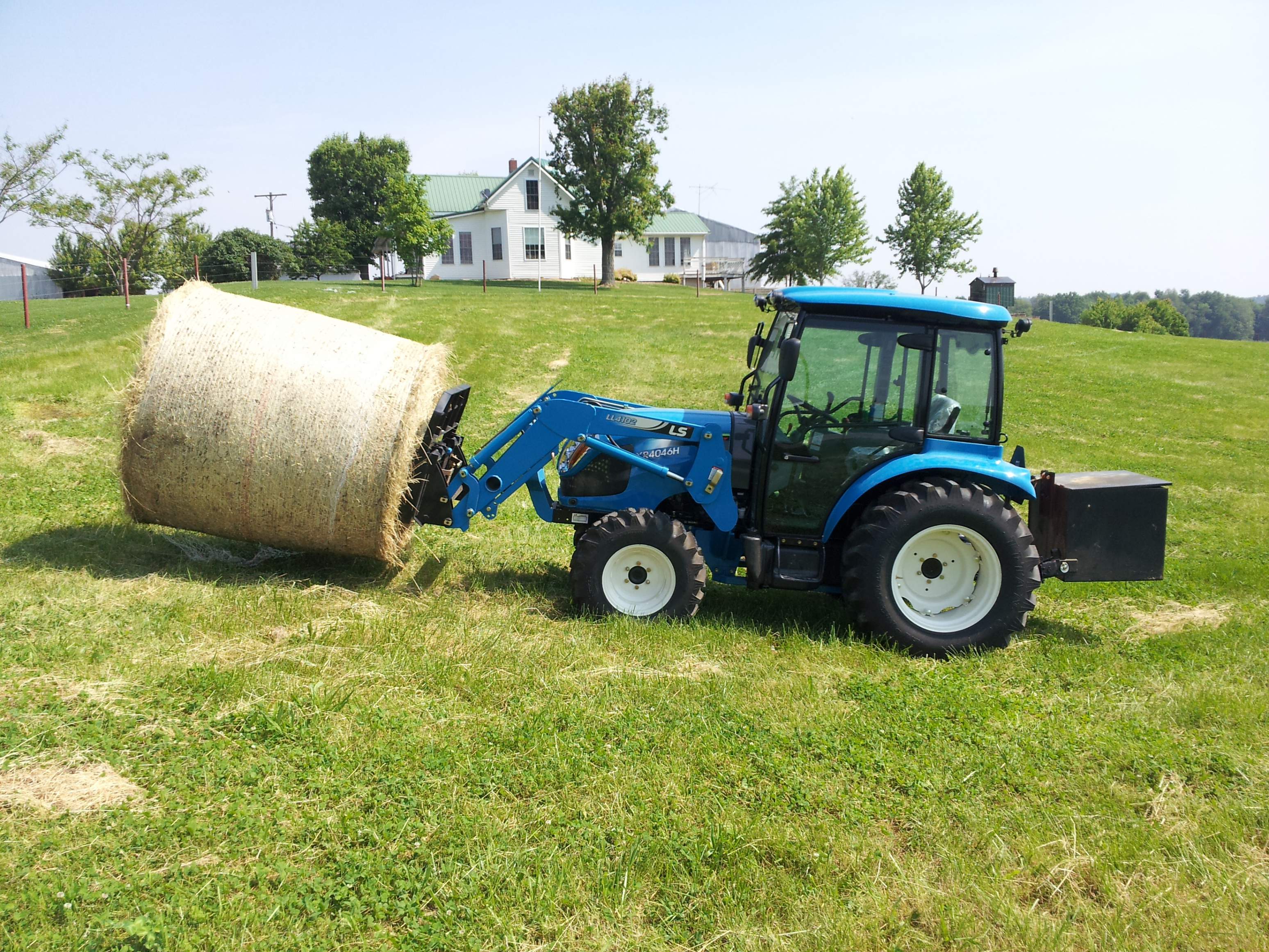

I did like most above and added pvc. Even though I keep it parked under a roof, I did drill drain holes in the bottom of each for "just in case". Rather than a barrel, I was very lucky to find an actual ballast box for next to nothing. With the steel inside the concrete, mine weighs around 1500 pounds.
