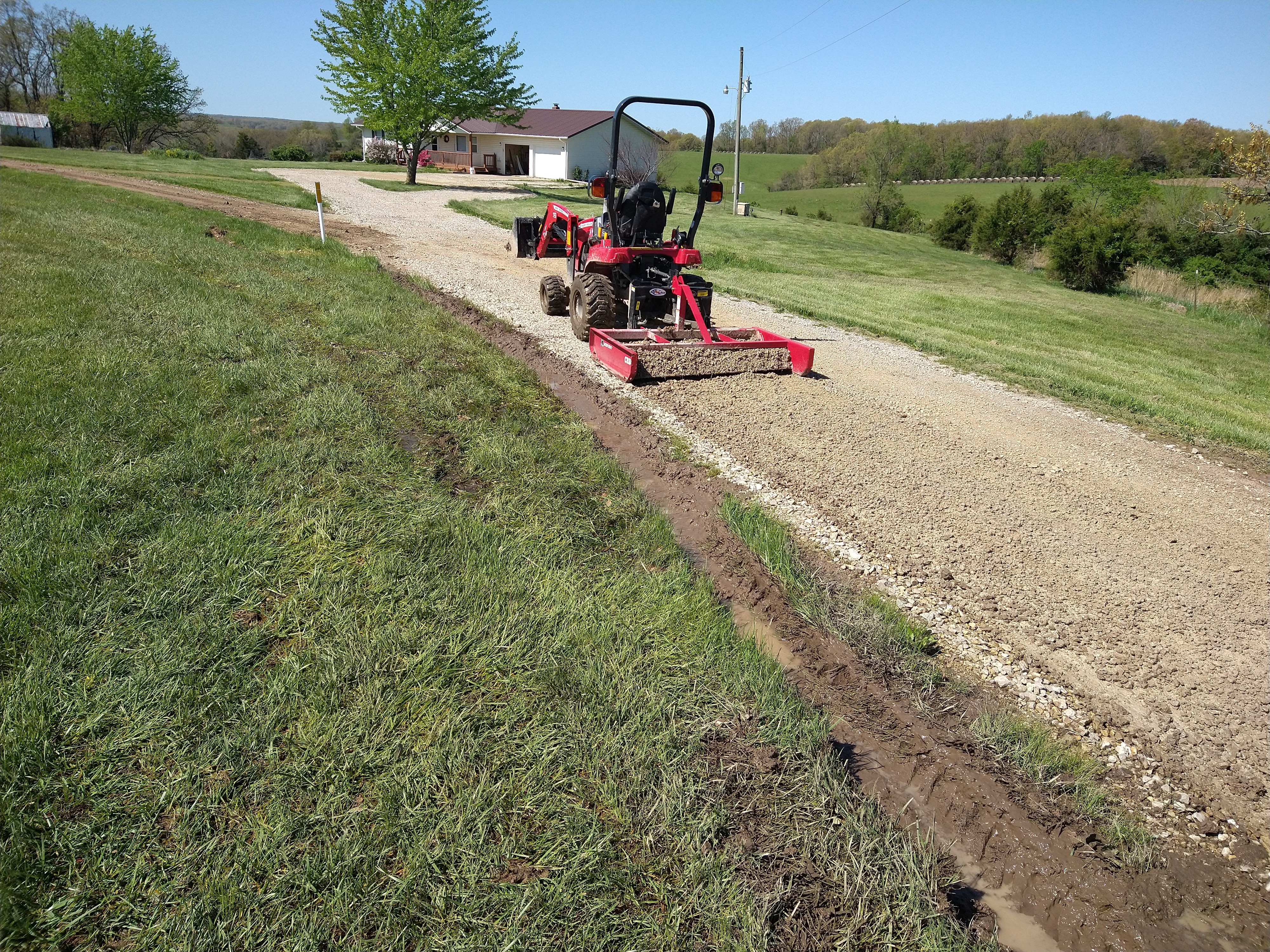

If you are looking for something to dig out the ground for the curbing, like was suggested a single "bottom plow" like farmers plow and turn over there field could work, or maybe a "potato plow" kinda like a wide sub-soiler ...
My suggestion would be to not have the concrete any more than an inch higher than the ground, less is better ...

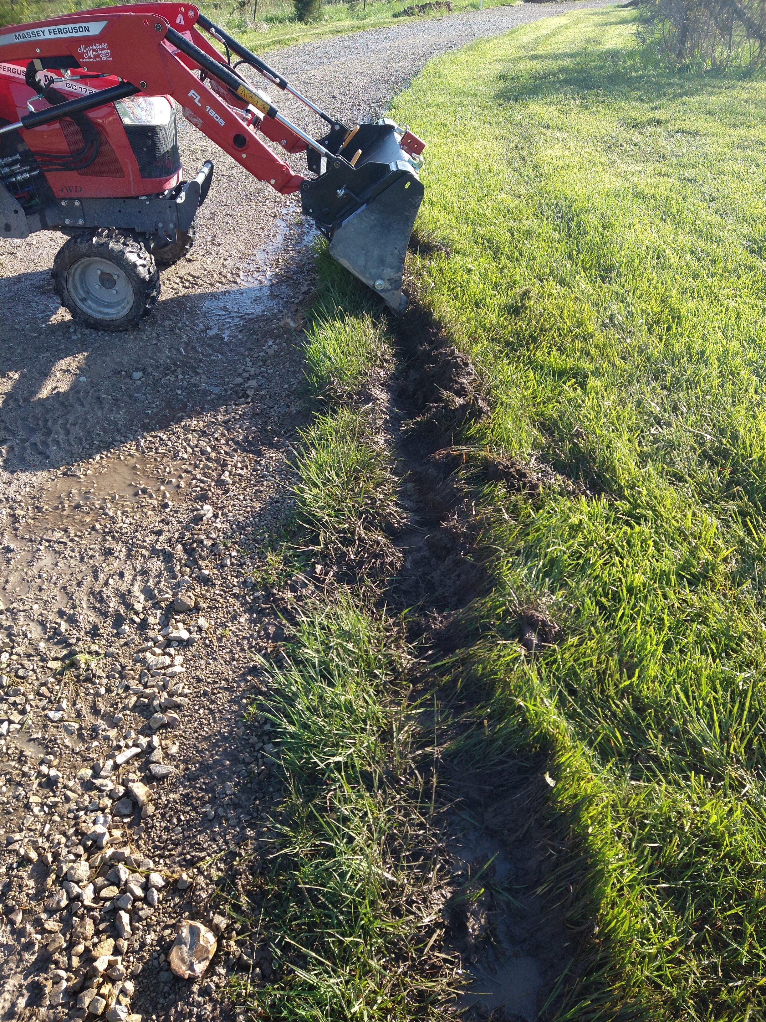

I used my loader bucket for a little ditch ...
Then drove my tires up it to even it out ...

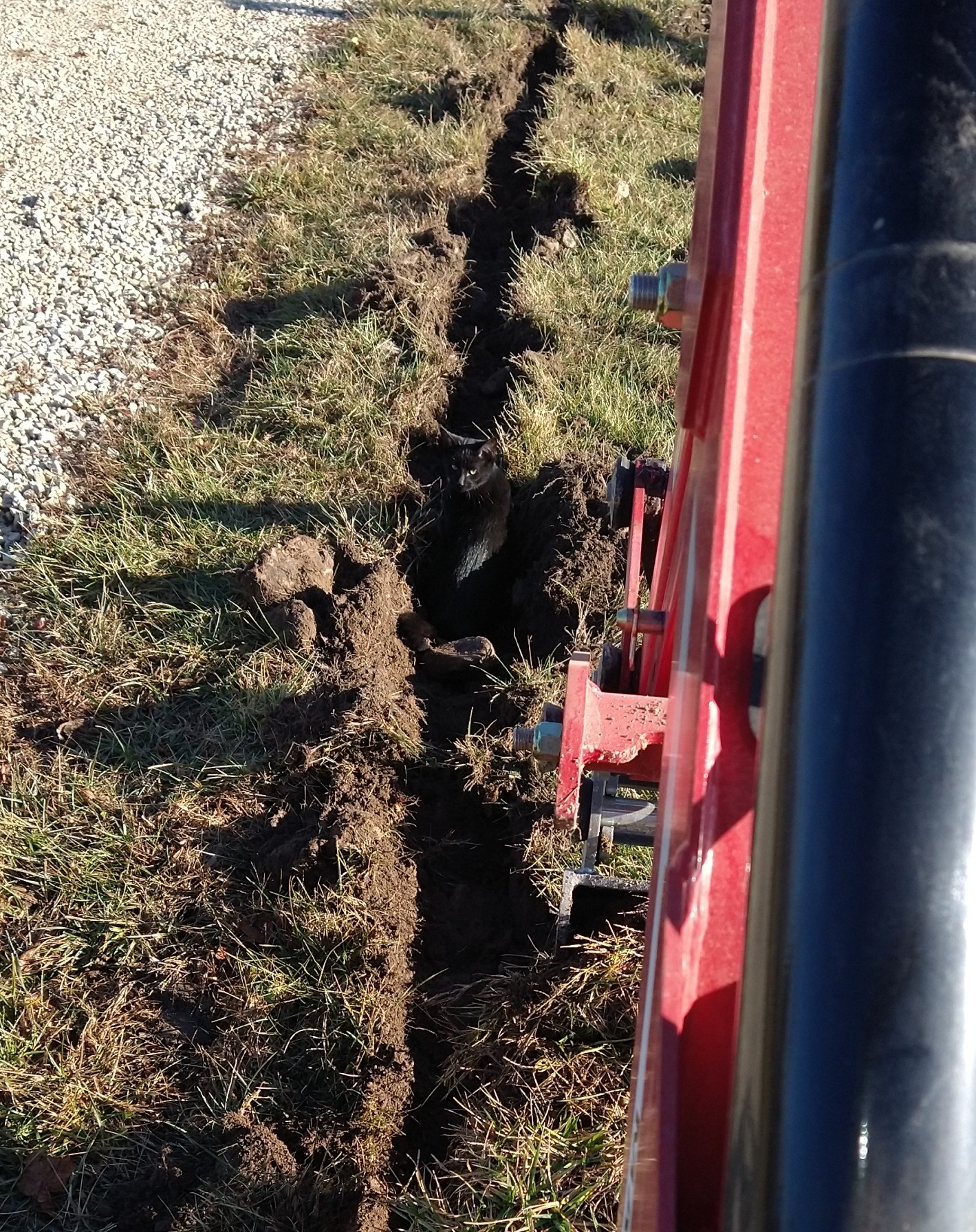

The next year, I re-did it with the backhoe ... Even had a "inspector" go down and check it out!
Always good to get a cat scan of your finished work.
I get a lot of lab inspections... LOL

I've used single shank subsoiler to loosen dirt for manual removal with a shovel. Getting a nice straight and narrow line was tough. It was straight enough to bury 4" PVC but I guess it would be too sloppy for your application.
