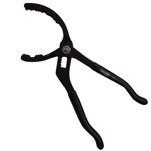

I bought one of these before starting my 50 Hr service. Filters came off without a problem, wish I had gotten one a long time ago.
Craftsman Adjustable Oil Filter Pliers
Sears Item# 02820520000 Model# 20520
I have one of every oil filter wrench know to man kind. The filter in my wife's CRV was a real dog to get at and I tried everything. Sooo, I have one like in the picture and they are great - at times. But be very careful using them. Some filter cannisters now adays are thinner than a beer can and can be easily dented and torn. Then if it doesn't come off you are in a pickle. Don't ask how I know.
