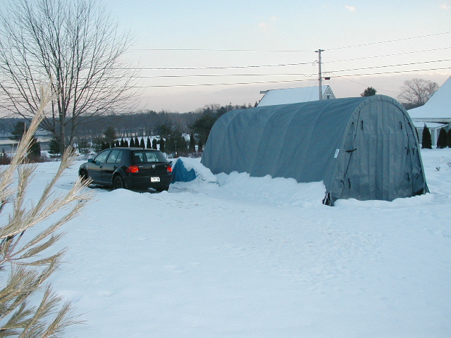

Still undecided about which 'orange' tractor to get. Went back to local Kubota dealer today, I really like the dealership. The Kubota dealer is 25 minutes away :) and the closest good Kioti dealer is 2.5 hrs away. :( Try as I might, I just couldn't find a machine that felt right to me. So I am back in the Kioti camp, I will just have to resolve myself to dealing with a dealer 2.5hrs away and no way for me to transport the tractor to them... not the ideal situation. On the other hand.. I did manage to get a TractorPort put up to house whatever tractor I get. :) I have it narrowed down my choices to a new CK25 or a one year old CK30 already set up exactly like I want, prices are similar.
Here is my TractorPort. :)
