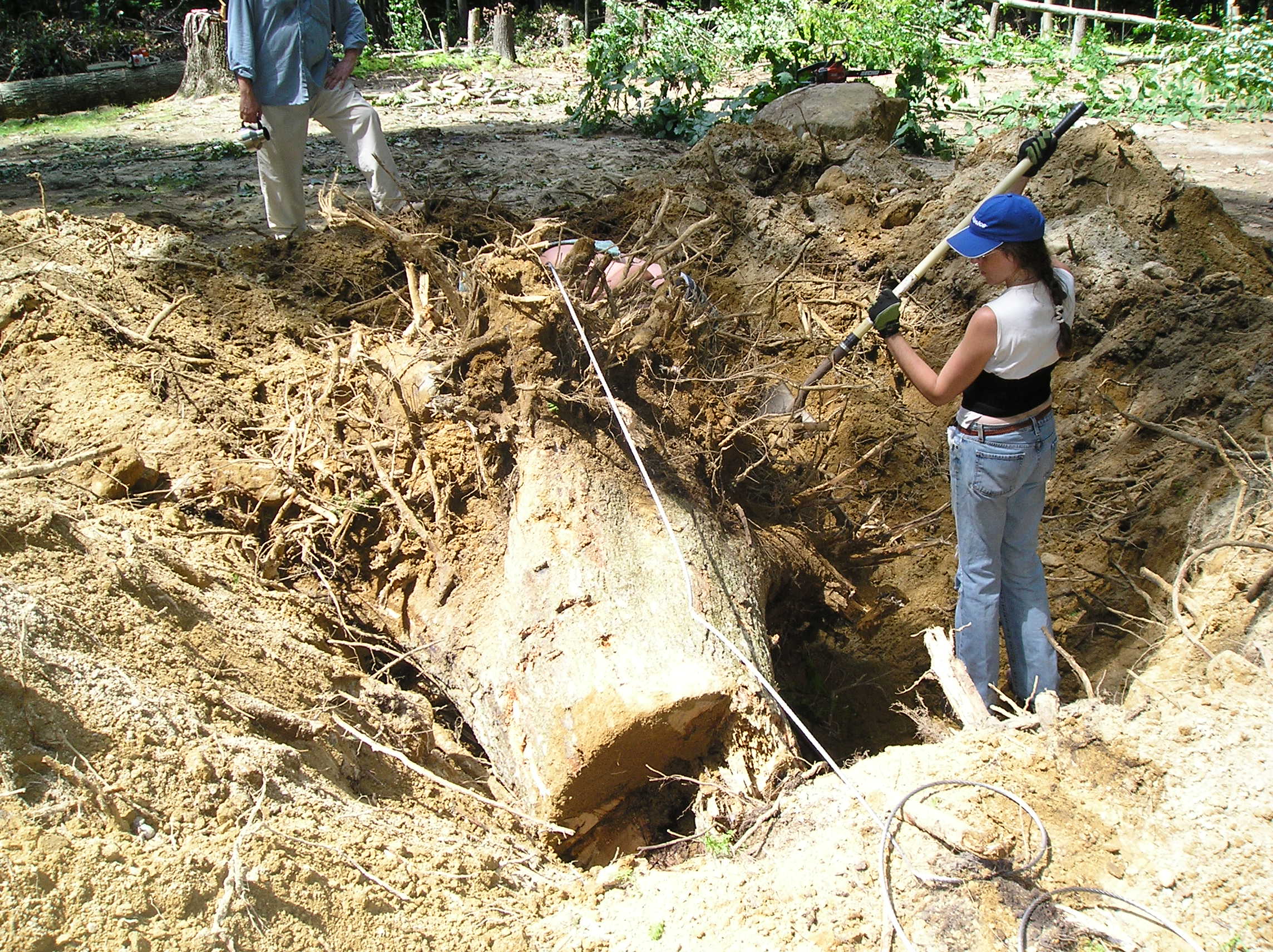

/ Compare L35 To A B21
I can see that baby being a little difficult. For the most part I would be leaving any tree that big alone. I used a full size excavator when I built my house to clear the lot along with a ford b455 backhoe both of which had the hydraulic thumb.
