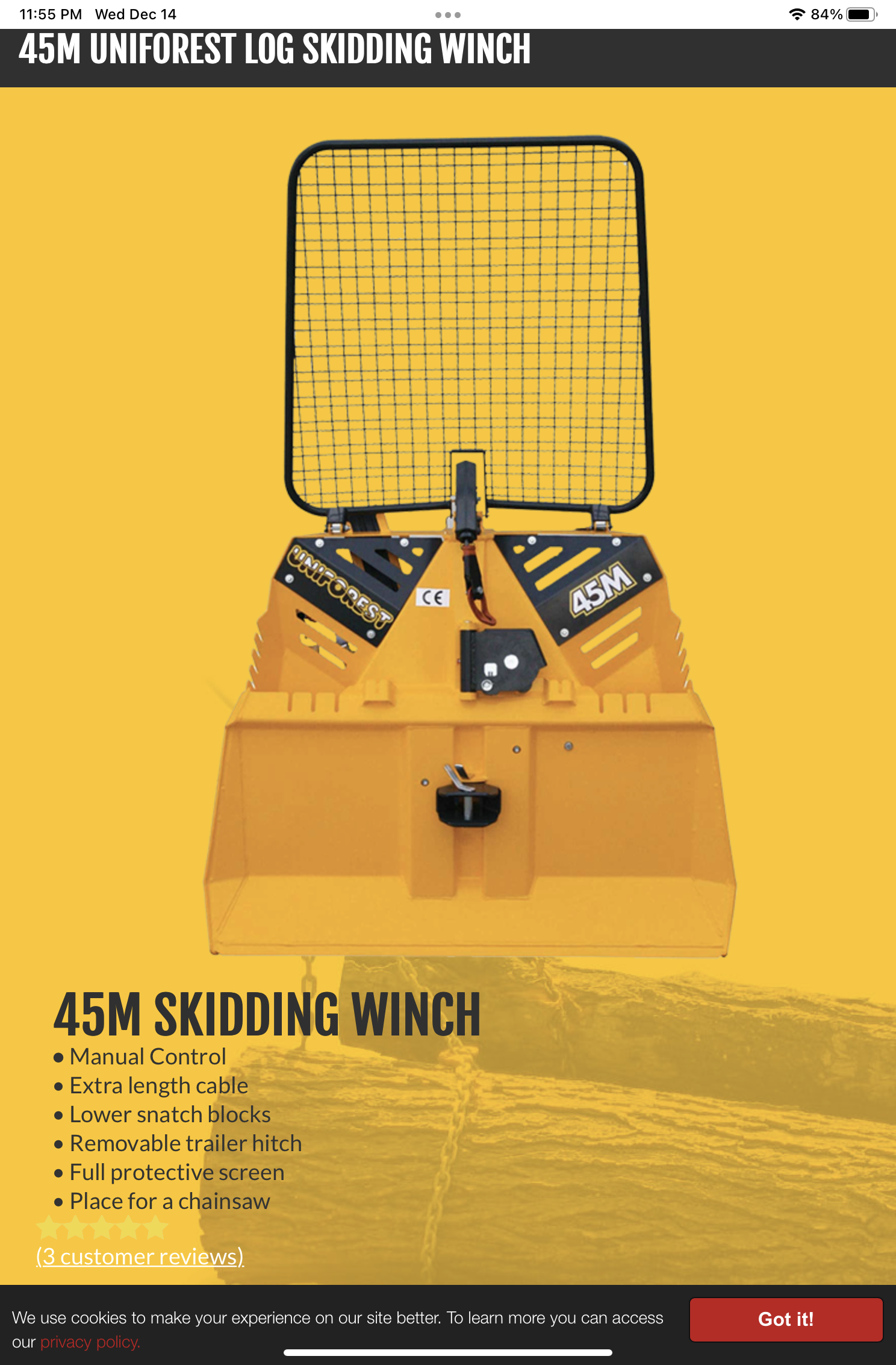

For dragging logs and saving roll overs on you tractor.
