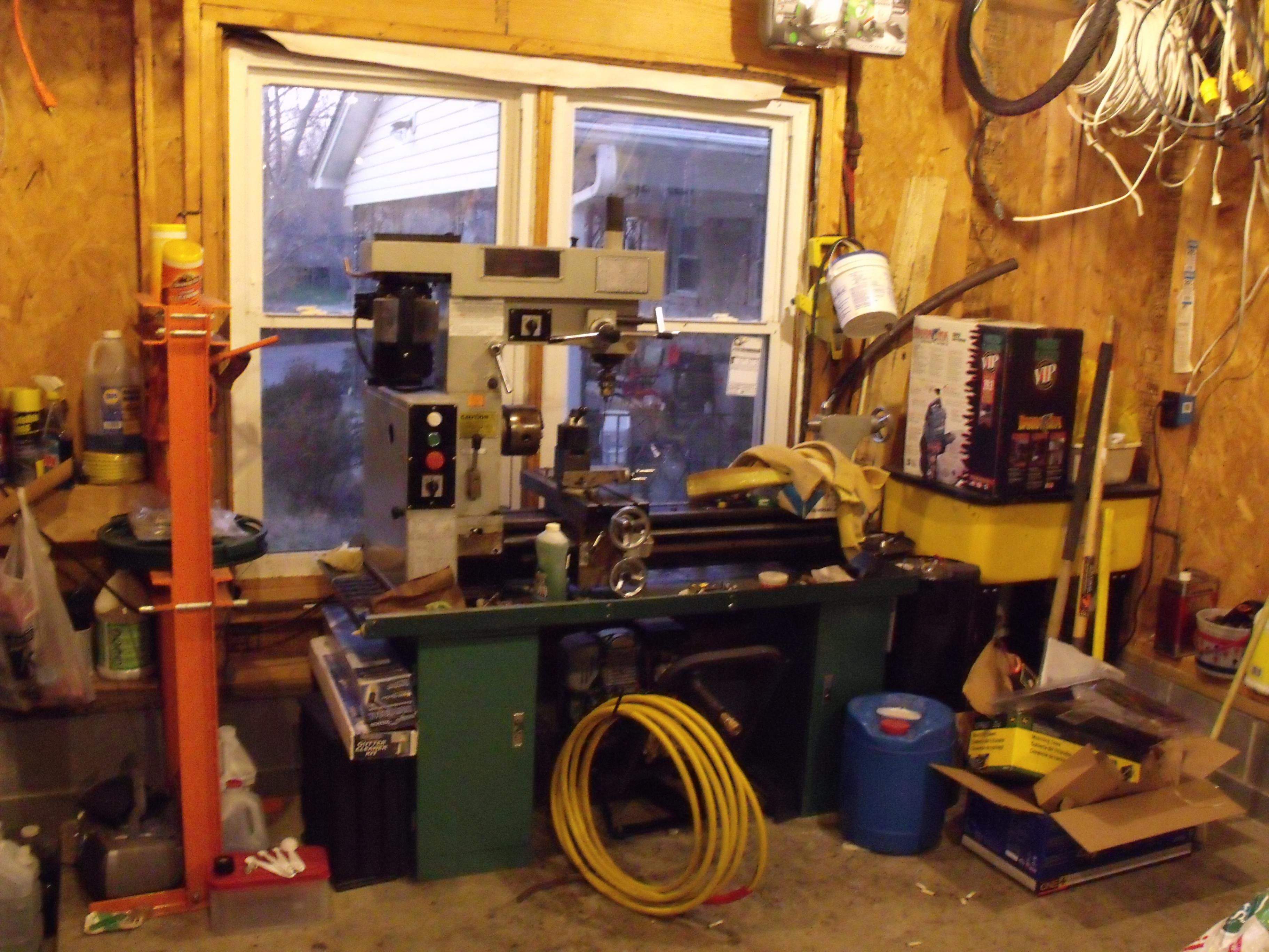

I sure hope this does not post twice..I lost my first post before submission.
I bought the 3 in 1 shown below, and it has/had the following issues:
The ways were rough enough from the factory that if you tightened them for stability, they would not move when cranked. I resolved this by releasing all the moving works so I could slide all ways by hand, and then with lapping compound, I lapped and slid and slid an lapped until the machine and I had quite enough. Left behind were tool marks that would hold oil/ but not effect functioning.
Problem two...there is no knee like on nice milling machines, so when using short bits (such as all small diameter bits) the work needs to be elevated in the vice for the bit to touch the work. However, most large diameter drill bits are so long, that they will not clear the work, or in some cases, they will not even clear the table. So, I have to use my collet set for these, since I can hide some of the bit length in the collet. But as you can imagine, this is a pain if one wishes to start with a pilot bit, and progress through larger bits...painful.
It truly would make a much better lathe than it will a milling machine. The milling part does rotate clean out of the way of the lathe, and in a pinch, I hoist the milling head upwards and put spacer shims to try to deal with some of my drill space issues.

I have the HF 3-in1 posted here and paid about $300 off Ebay for it from a freight recovery company...pretty easy purchase. If I had the choice, I would have a larger shop and the biggest separate lathe and mill I could find/afford. I don't have that much shop space and at the time I had zero luck finding one of those $400 Southbend lathes w/tools rumored to be floating around ;). With a little tweaking and time spent, the HF will do small things with Ok accuracy, I'm sure a more knowledgeable machinist could get more out of it. However, we have used the snot out of it and it has paid for its self many times over.
I didn't want to spend much when I started looking for one and eventually will put some money and effort into upgrading. If I was going to plan on spending $1700 plus tooling right now, I would start searching for an old larger separate lathe and mill that would definitely be better quality And comes with some tooling. I think this would be the best money spent.
