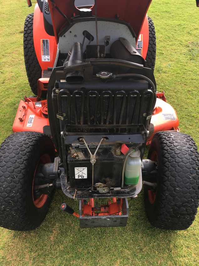

Radiator screen had a fair bit of grass in it (photo taken after it was given a quick clean).
Air filter had a fair bit of grass and dust caked on it.
So it looks like it's spent the first 150 hours of it's life being unloved. I doubt it's ever been serviced and it looks like it's air filter and radiator screen haven't been cleaned, possibly ever.

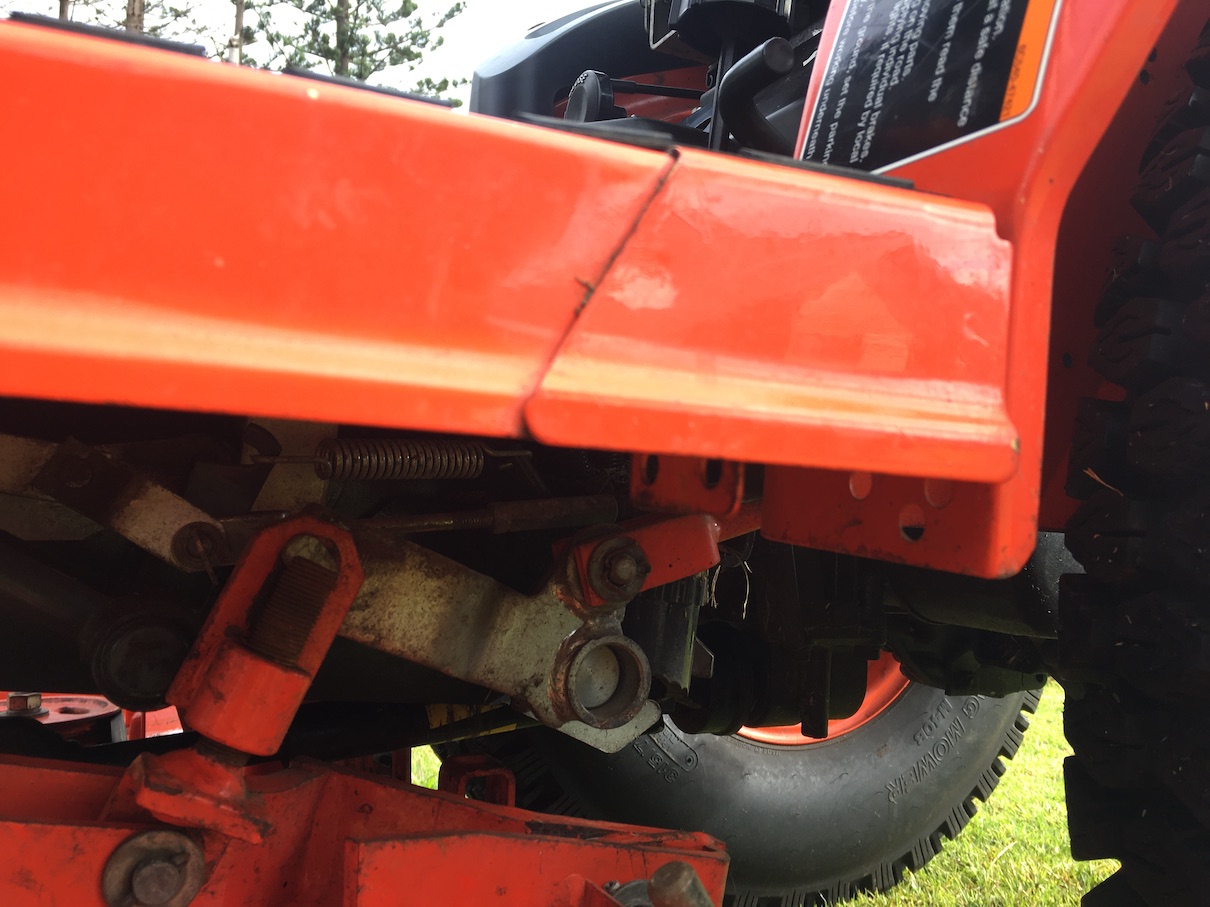

It's been bumped into a fence post so the front headlamp cover and grill is cracked:

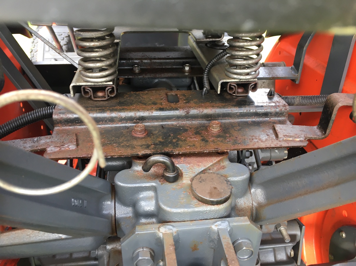

We live in a coastal area, so rust can be an issue if not garaged. The owner claims it has been, and I can't see much rust on it, except for this plate just under the seat...?

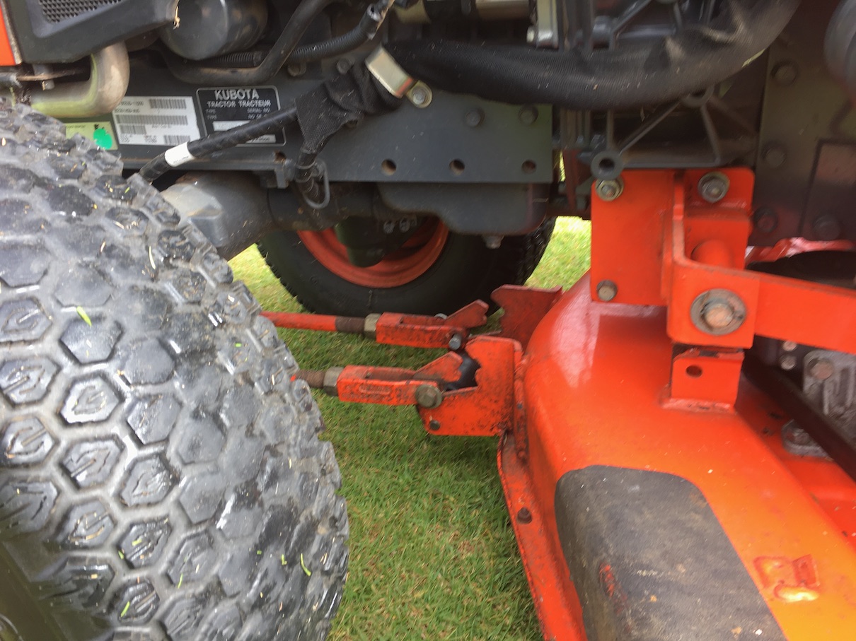

Those front tires sure looks worn for 150 hours...... Good luck....
/ Compact with 150 hours on it, never been serviced. Avoid? #3
It always helps to have a general location in your profile.
By "plowing" I assume that was pushing snow. It would explain the wear on the front tires, operating in 4WD on asphalt/cement, and the rust from salt (it may have had a salt thrower on the 3pt.). When pricing, include the cost of an FEL if you want to add one latter, it can get expensive.
Sorry, have updated profile now. We're actually in a snow-free part of the world, so by plowing I meant plowing soil, with some kind of home-made tow-behind gadget the owner said.
/ Compact with 150 hours on it, never been serviced. Avoid? #5
By "plowing" I assume that was pushing snow. It would explain the wear on the front tires, operating in 4WD on asphalt/cement.
Or filled rock hard with air and only wearing down the center.

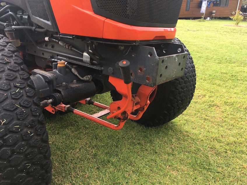

By the rust around the bolt holes, I would think there’s been something attached to the front frame.
/ Compact with 150 hours on it, never been serviced. Avoid? #14
Rust around bolt holes on front frame suggest something mounted on the front.

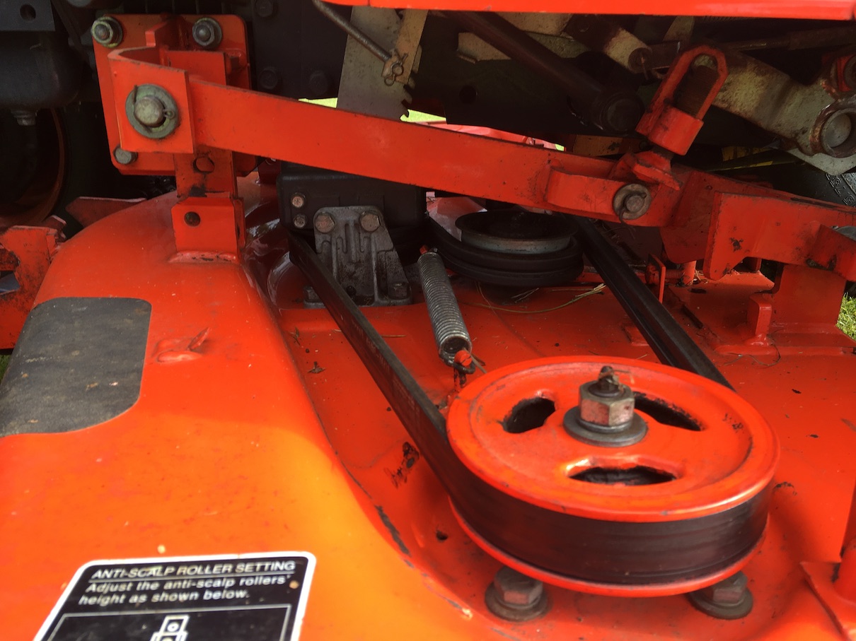

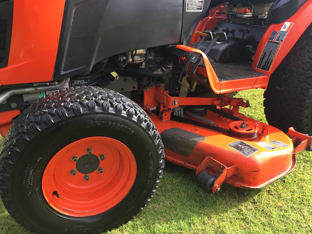

Mower deck pulley covers missing.
Side discharge cover missing.
Top half of ROPS missing.
Cross brace behind set bent.
Looks like it was rode hard and put up wet.
He said he has the rest of the ROPS, and I think he mentioned something about some deck covers he has set aside. I will check.
It does indeed look like it's been knocked around a lot in its short life. Quite a lot of scratches and dings in the paint work.

The previous owner had to drive it along a bitumen road a lot, to get to other properties, so I'm guessing this explains the tyre wear (?)
/ Compact with 150 hours on it, never been serviced. Avoid? #17
Well there's your answer... turf tyres + bitumen = more tread wear than usual.
Very simply put; R1 (Ag tyres) have the 'deepest' tread and are designed for pulling traction and are ideally designed for 'field work'. R4 (Industrial tyres) have a not-so deep tread, are wider and 'softer' than a R1 and can handle asphalt/bitumen surfaces better. The tractor you're looking at has R3 (Turf tyres), the softest of tractor tyres and the least 'aggressive' tread.
So, you need to be honest with yourself and what you want to do/accomplish with the tractor you need. R1 tyres do not fit R4 wheel rims. I can't honestly say that R3 rims would fit an R4 tyre, but I doubt it.
