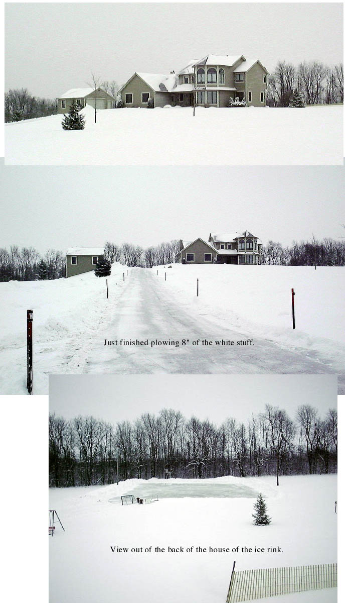

Here are the <A target="_blank" HREF=http://www.tractorbynet.com/cgi-bin/compact/showflat.pl?Cat=&Board=photos&Number=38643&fpart=1>post</A> of the snow we got during the 2000-2001 season.
