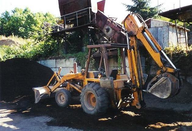

JCPjr, there's a lot of good info, discussion and debate going on around here and I figured I'd add my 2 cents. I decided to buy a used TLB a couple years ago to do a variety of tasks on my 100 acre place after using an old 580C on our ranch during the 1980's. Trying to stay with mainstream brands like Cat, Case, JD or Ford, I wound up with a 1984 555A that I bought from a local municipality with only 3000 hours for less than $10K. I considered 4x4 for about two seconds but easily decided against it (and its extra cost/maintenance) when I determined I wouldn't be using the machine in muddy conditions because I don't want to tear my place up, my land is mostly flat, and because I didn't intend to use the machine for tons of loader work where the added traction "might" be needed. To date, I've used this machine for so much more than I ever could have imagined. I won't bore you with details, but once you get one, you'll realize how versatile it really is (I think I'm over 1000 uses and counting). :) Also, as far as maintenance is concerned, to date all I've done is general/routine maintenance and a couple hydraullic hose replacements.....knock on wood.
Now to my point, while a $30-40K machine I'm seeing in the above links would probably do your job a little quicker, don't discount an older machine for much less cost. The way I figured it, if I want to eventually sell, I'll easily get my money back because these things tend to "bottom out" down around the $10K level for a clean machine, BUT if I want to keep it for many years to come, I won't feel bad because I'm into the deal for so little money, I can easily afford to let it sit idle while not worrying about it paying for itself on a jobsite. Additionally, I'm not out the high rental fees and not under any time constraints as I would be had I rented one.
By purchasing the lower cost TLB, I now have a very handy full-sized TLB and a brand new 55 HP NH farm tractor for less than $24K total investment. It's funny, when the NH dealer was delivering my new tractor, he looked at my backhoe and commented that I would have to be crazy to get rid of that good old 555 (we'd briefly discussed adding a front-end loader to my new NH) but that if I ever did, he always has three or four guys ready to buy.
Good luck with your decision.
