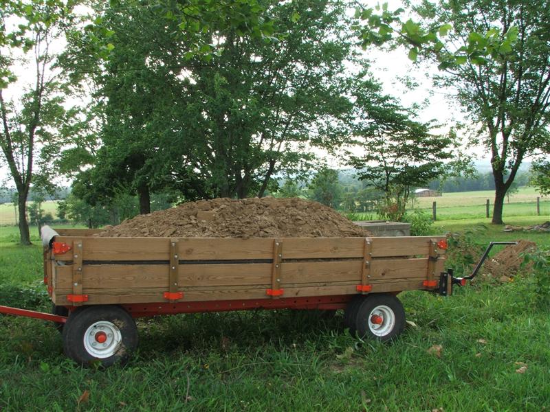

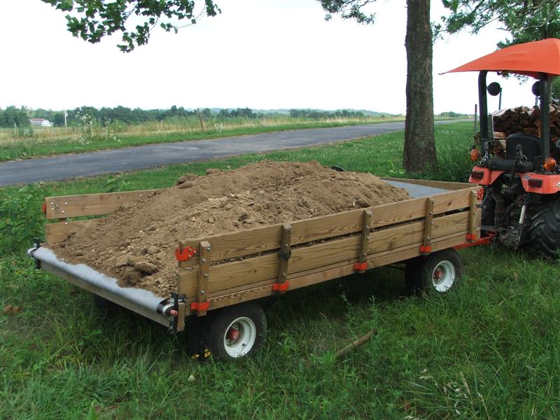

mjfox6 said:
If all you are worried about is emptying your truck easier, maybe you should consider this (and save yourself $1900).
Welcome to Loadhandler.com
Another testimonial for the Loadhandler, sure fooled me, works really well and is fast unload, lot cheaper than some of the alternatives. After I got my wagon and attached the Loadhandler, I found a KK dump trailer at an implement dealer for $1450, I would pobably bought that, although it is smaller, had I not already had my wagon.

There have been instances when I definitely could have used a device like the Loadhandler. Doesn't allow me to skip the dump trailer (I need the trailer to move materials between narrow vine rows), but for $100, it's a cost effective way to make unloading the truck much easier and faster. Thanks for the reminder.
