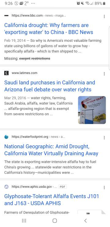

Well the most famous and well known are the alfalfa export farmers in California that are exempt from all water restrictions and emissions. Let the state burn so they can water crops!
/ Common rail vs mechanical injection #152
Not buying any claims about farmers being exempt from emissions requirements, especially in California. It ain't happening and I challenge you to back up your claim. Emissions requirements follow equipment, not end users.
Or I could refer you back to post #57.
Now water rights are something I know next to nothing about.

And were are they "exporting" too.
Arizona were all their cows went???
And I'd like to know what water restrictions they are exempt from, what irrigation????
Many of those have their own purchased and improved water rights.
/ Common rail vs mechanical injection #154
The alfalfa goes to china. It makes headlines every year internationally.
They are exempt because they are Federal farmers, they are not farmers for the state of California.
WTF is a Federal Farmer?
Emissions regulations are federal regulations administered by the EPA. States are allowed to pass more stringent regulations but cannot bypass, exempt or otherwise circumvent Federal regulations.
Still no link, verification or documentation of your absurd emissions claim.
