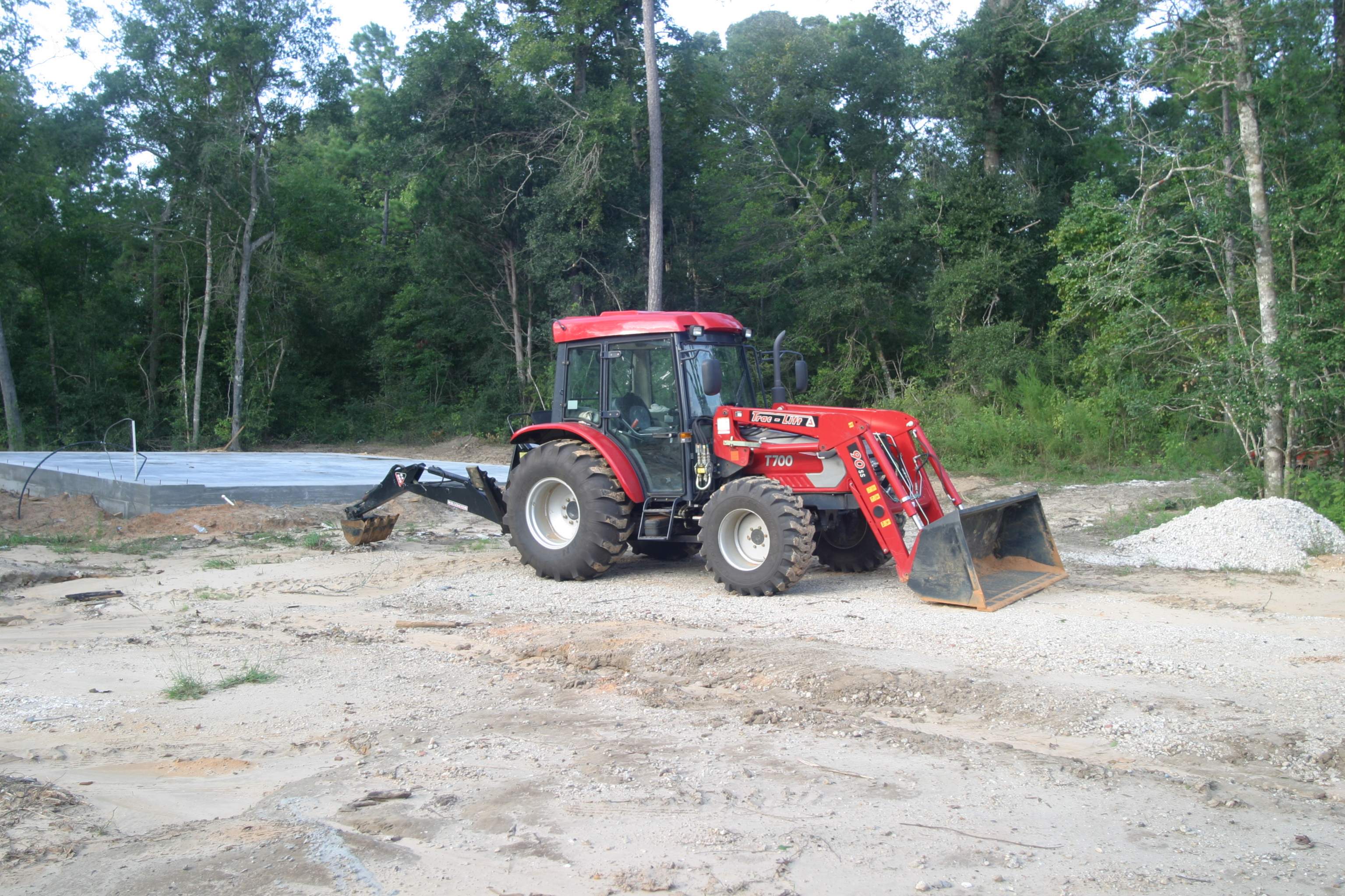

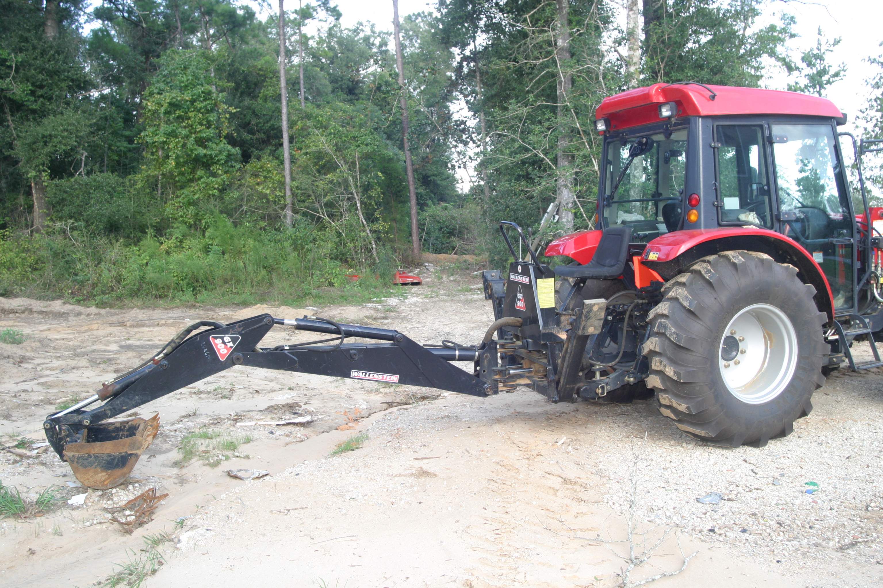

sorry i did not get back to the person who asked for info on my backhoe (wallenstein) it is a three point mount no subframe mount at the time was available for this size machine. if iwas a contractor using the backhoe all the time i would have been sceptical but for small farm use i have had no problems and it does a good job digging footers and all around use. i have been travelling their website is Welcome - Wallenstein and some one asked if the john deere engine was turbo charged and yes it is

I would be very weary of a 3pt hitch backhoe with no subframe. Too many instances of broken tractors. Is this backhoe available thru TYM or just one you added on your own?

i again did a lot of home work before buying. first as i said you could not buy a sub frame mount for this tractor by any company. i had my dealer call about three point hitch mounts from the tym company and was told if i installed a tym autherized backhoe the warranty would be honored in the event something happened they were alot more than the one i bought so after examining the rear axle and three point mount and knowing this is a real heavy duty tractor for those that own one you know how ruged these are i have used this tractor with a road grader,back hoe and other implements for almost 2 years easy to change out by my self and never a problem. i to was real leary of the three point mount but after having used it i have no regrets. does any one out there know of a back hoe with sub frame mount that will fit this tractor??? i would like to know myself.
