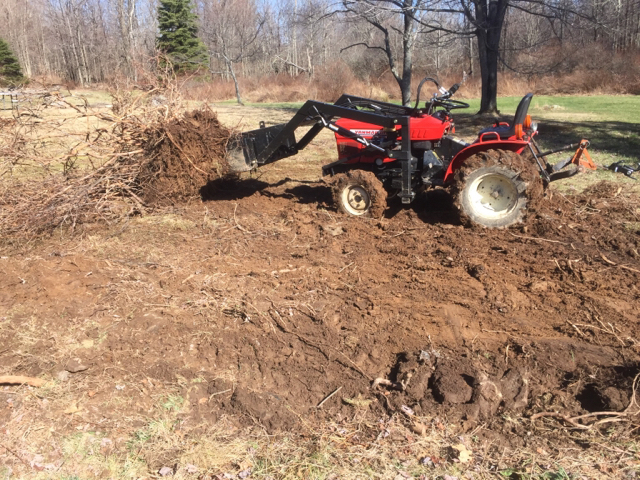

After a few years of this (photo) while searching for a YM186D, I finally found one. Then a couple of years later, finally, one with a loader.
/ ColdWater tractor loader install
#44
Boom! First thing demolished lol. Loving this loader

Got to say started digging my pond and it's pretty much scary getting out of there with a load of dirt. It just wants to tip over and scare the crap out of me.
/ ColdWater tractor loader install #54
The smaller Yannies are like that. You have to stay aware of what you are driving over, weight in the bucket and angle/ slope of the ground too. I have come so close many times to tipping it over with a bucket load. I keep one hand on the lever ready to drop the bucket at a moments notice. Try and keep it as low as possible and this help greatly. I am going to make a new bucket for mine but make it narrower than it is now, the same width as the front wheels which should help heaps. Have you set your wheels to the widest position and loaded them with liquid?

No I have not. Just flip the front rims? How do I load the tires?
#56
Just watched some videos on the liquid fill. That should help some
/ ColdWater tractor loader install #57
Not recommended to flip the front wheels. Really doesn't help and puts additional stress on it.
#58
Anyway to widen the tractor if you can't flip the wheels?
#60
I did see that. Also anyone have any tricks to keep clay and mud from sticking in the bucket? Extra 100 pounds stuck in there each scoop and takes forever to scrape it out. Banging the bucket on a stump does nothing to remove it.
