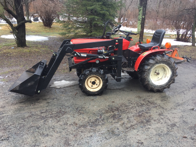

Does anyone know if they made a roll bar for this model? The bar that bolts by seat and goes around over driver.
/ ColdWater tractor loader install #22
I am sure a ROPS is available for your tractor as it was a popular model. That said, they aren't cheap. Hoyetractor.com might have them available.

Yes I hear you ! That will be the next item I will be saving for.
#27
I am so surprised on how much I can dig with this! I will be digging my pond. Probably take all Sumer and lots of diesel but worth it.

Has anyone taken there dash out on a 186? I am trying to get it off to replace my hour meter/rpm cable. Do I really have to take my steering column off ?
/ ColdWater tractor loader install #29
Yes. No.
It's a nightmare to take off the cowl assembly. BTDT.
But I was able to detach the tach cable and oil it without removing the cowl. As i recall I used micro-sized Channelock pliers, and also pushed a lot of wiring out of the way to make room. Might have removed the turn signal flasher or ignition switch etc to make room, don't remember. If you have an 8 year old with tiny hands, give her the Channelocks and lots of encouragement.

Lol that's what I tried from the opening. I also tried taking every bolt and screw out of everything in that area and just can seem to get it. What a pain. I will get my son to try.

/ ColdWater tractor loader install #34
Yea they have them. Man there pricey.
I am surprised......I thought the 186D came with a ROP??? They were sold here in the states.....thought they had to have them?? Mine does.
/ ColdWater tractor loader install #36
I think OSHA says they are mandatory if you have an employee operating the tractor. But my second YM186D has a landscaping company name stencilled on it. The owner before me bought it from them. No ROPS. No way that was bought to be used solely by its owner. No ROPS on my first YM186D either but its history was unknown. Maybe the original owners removed them.
I mounted the YM186D adjustable rear hubs flange-out, and the wheels outside of those, contrary to what shows in all Yanmar photos of this model. That additional width and water ballast in the tires seem sufficient. And I chose this particular model because it runs on little 16" rear wheels. It seems pretty stable.
In contrast, the YM240 seemed tall, narrow, spooky. It would be impossible to climb off of if it started to go over. I was the first YM240 owner to order a YM2000 ROPS from Hoye. (fits perfectly, these models are twins).
