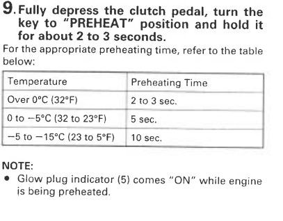

So, after nearly 20 years of ownership, I finally had a cold weather start problem on Sunday. It was -18F and I just could not get it to start. Let's see: after several years of mild winters, I forgot to fill up with winter mix fuel, forgot to change/clean fuel filter, and my battery was 11 years old. I wonder what might have gone wrong? Oh, yeah, and my owner's manual only has this to say about cold weather temps.
So if I read the manual right, maybe I am not supposed to try and start it below 5F. Ha ha. I would be laughed right out of the state.
New fuel filter, proper fuel mix, and a new battery installed, it now runs just fine. Maybe I should be good to go for a few more years, or at least remember to think next fall. Ha ha
