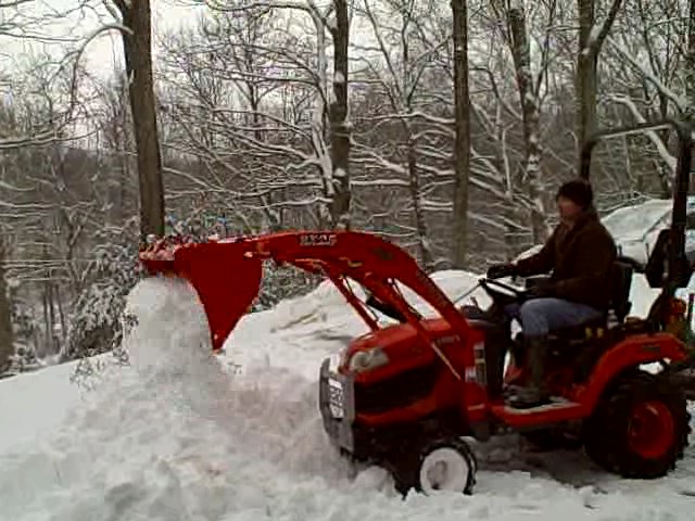

We might be gettin a good storm next Wednesday. Keep your diesel wet.

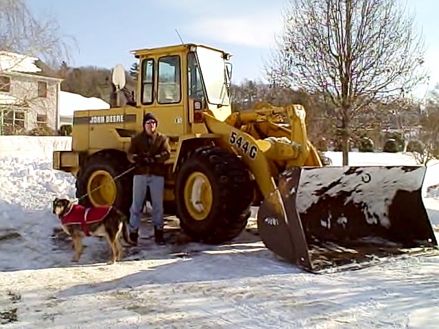

I was hoping to use my neighbor's big loader.
