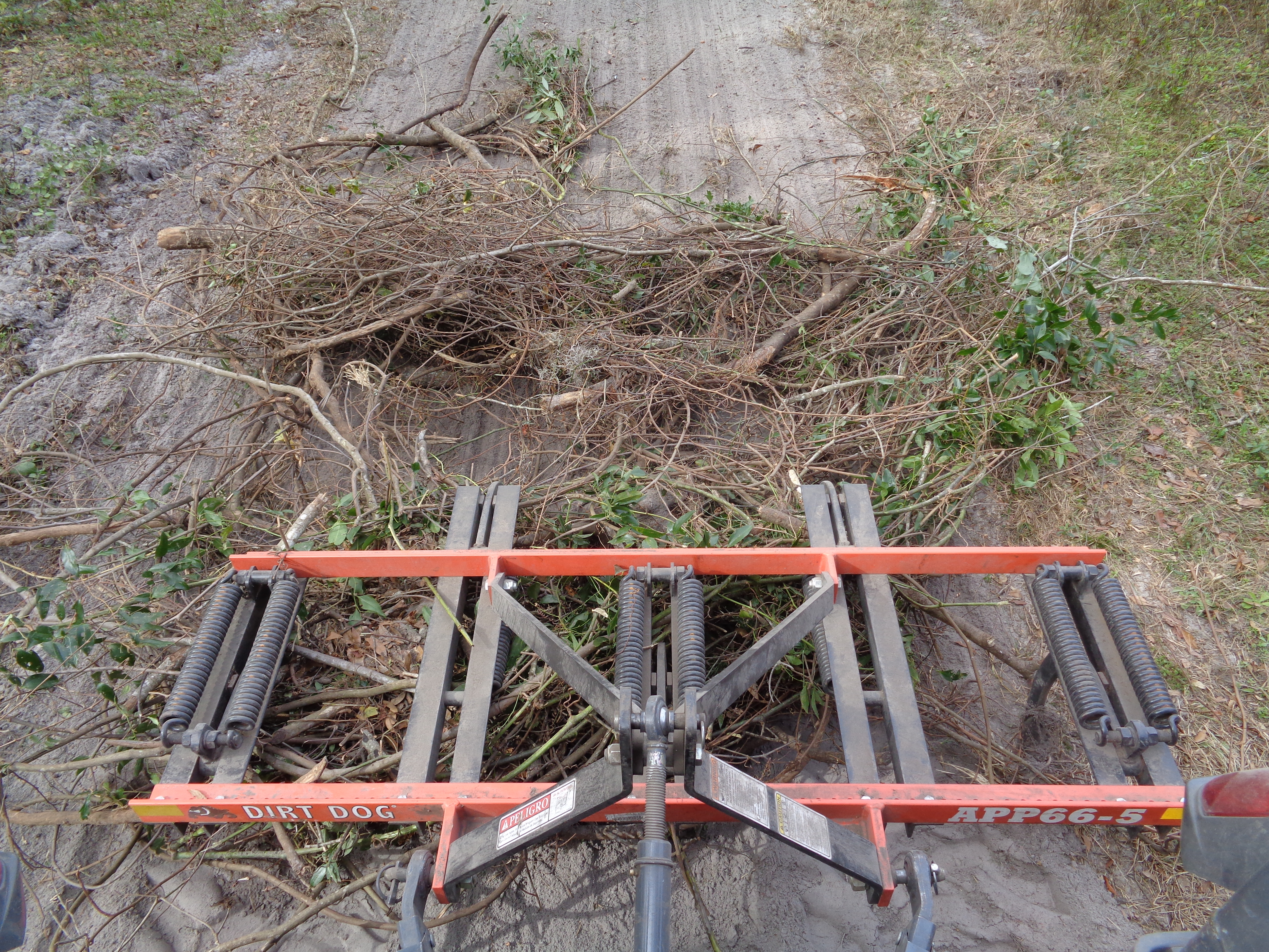

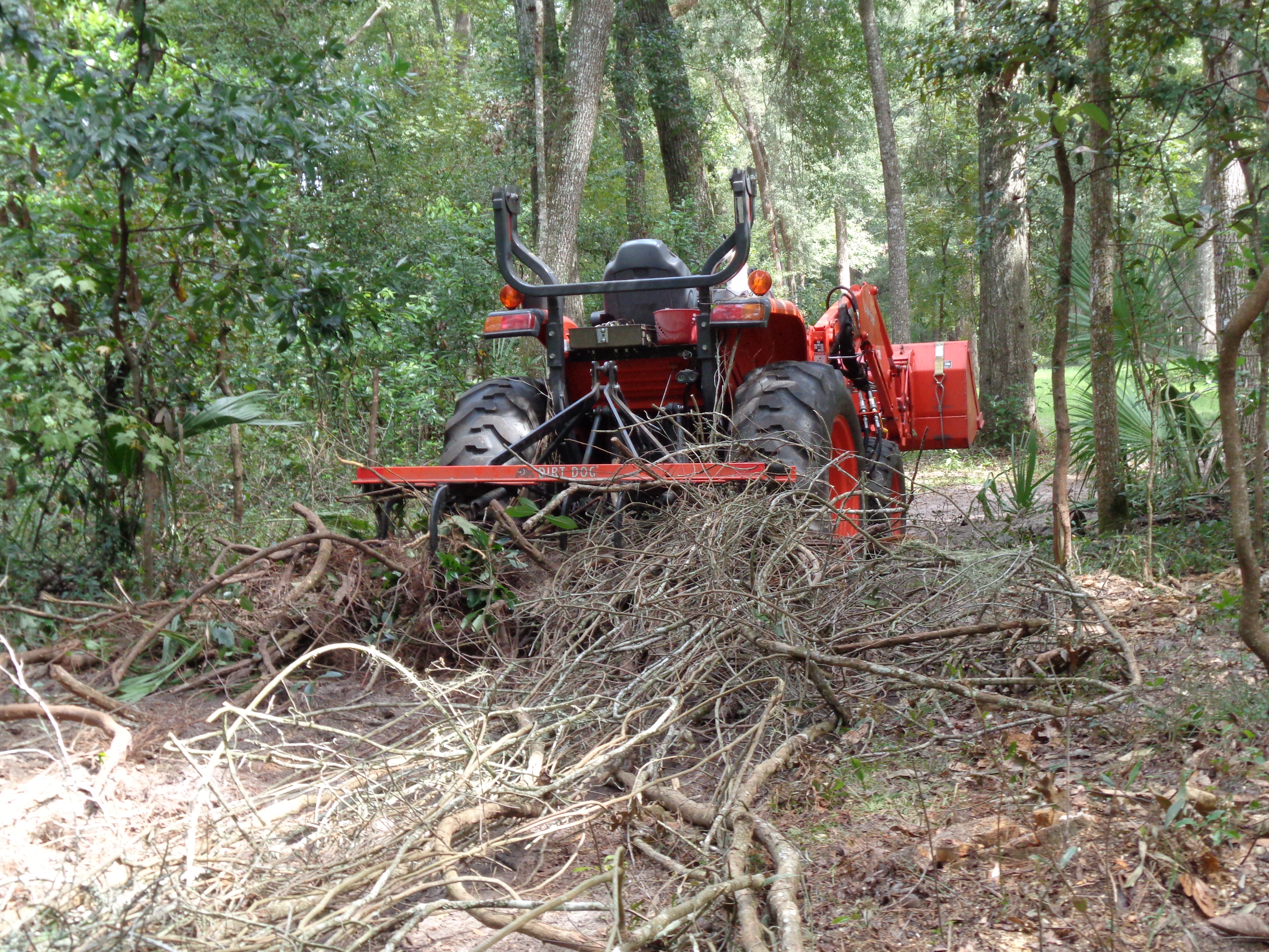

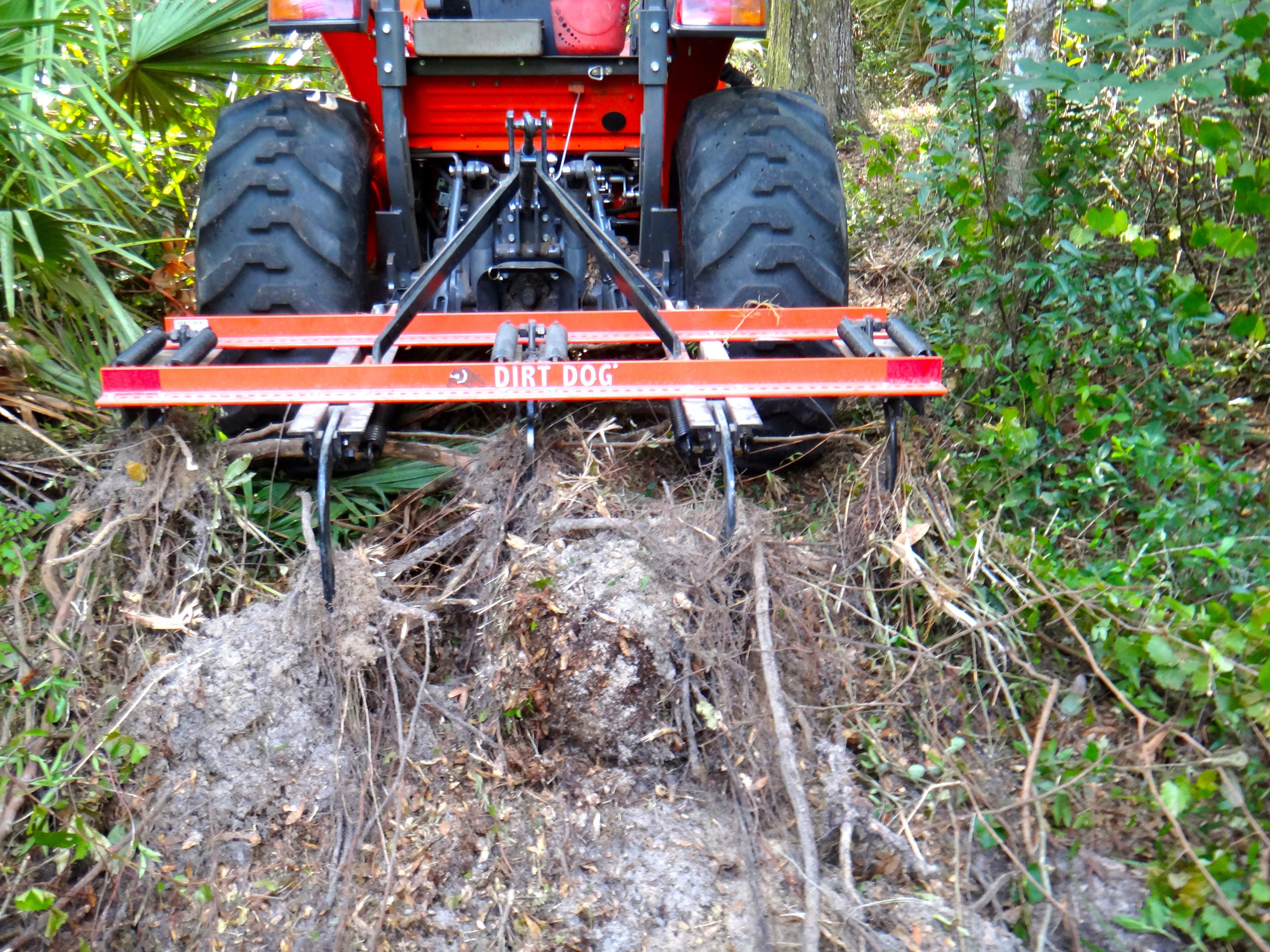

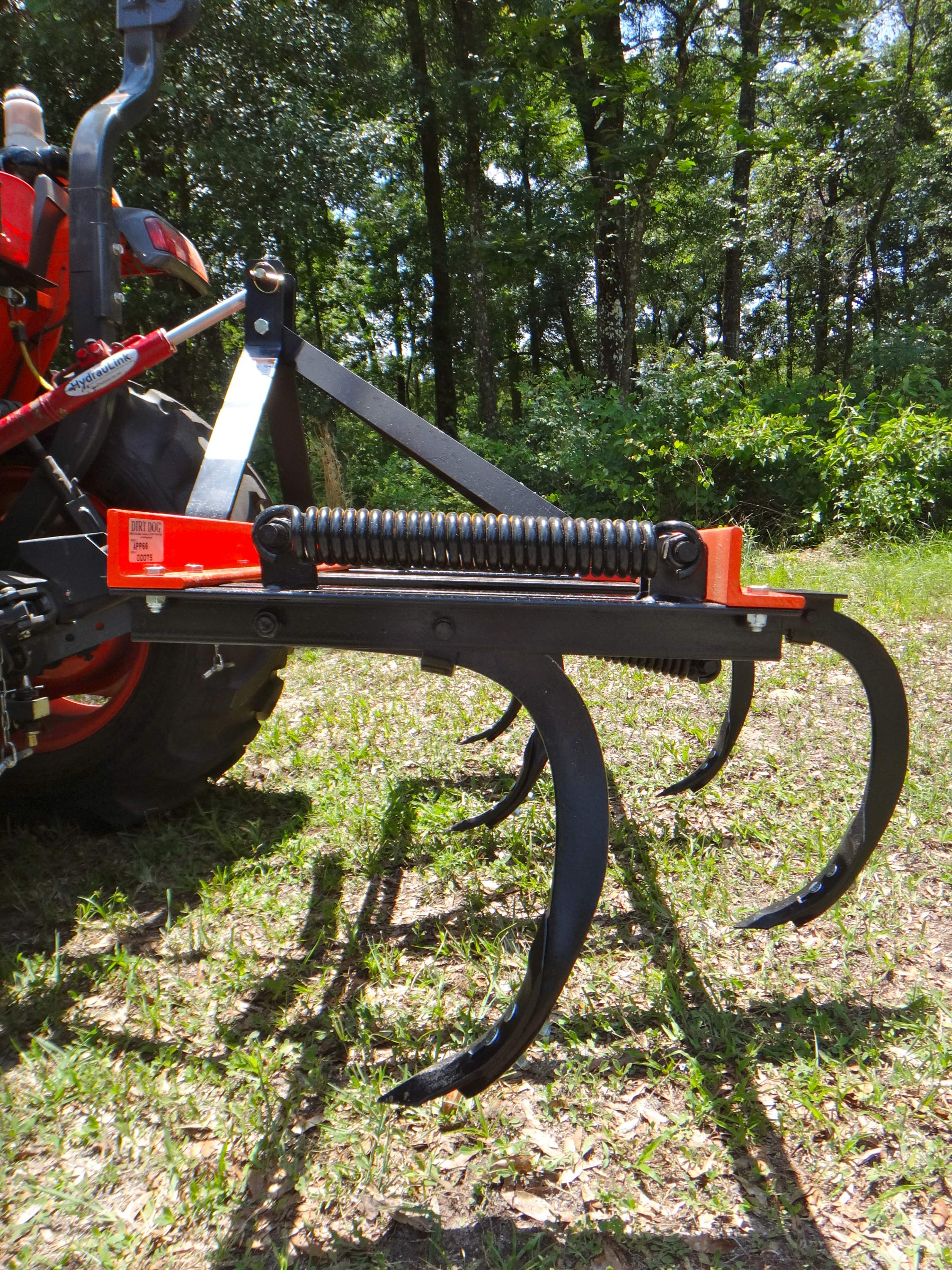

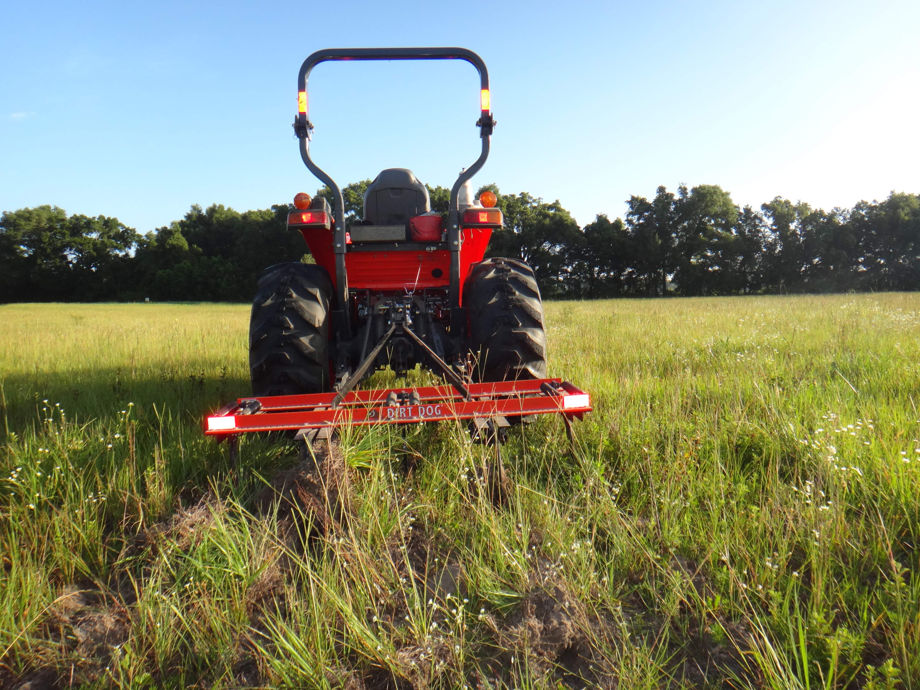

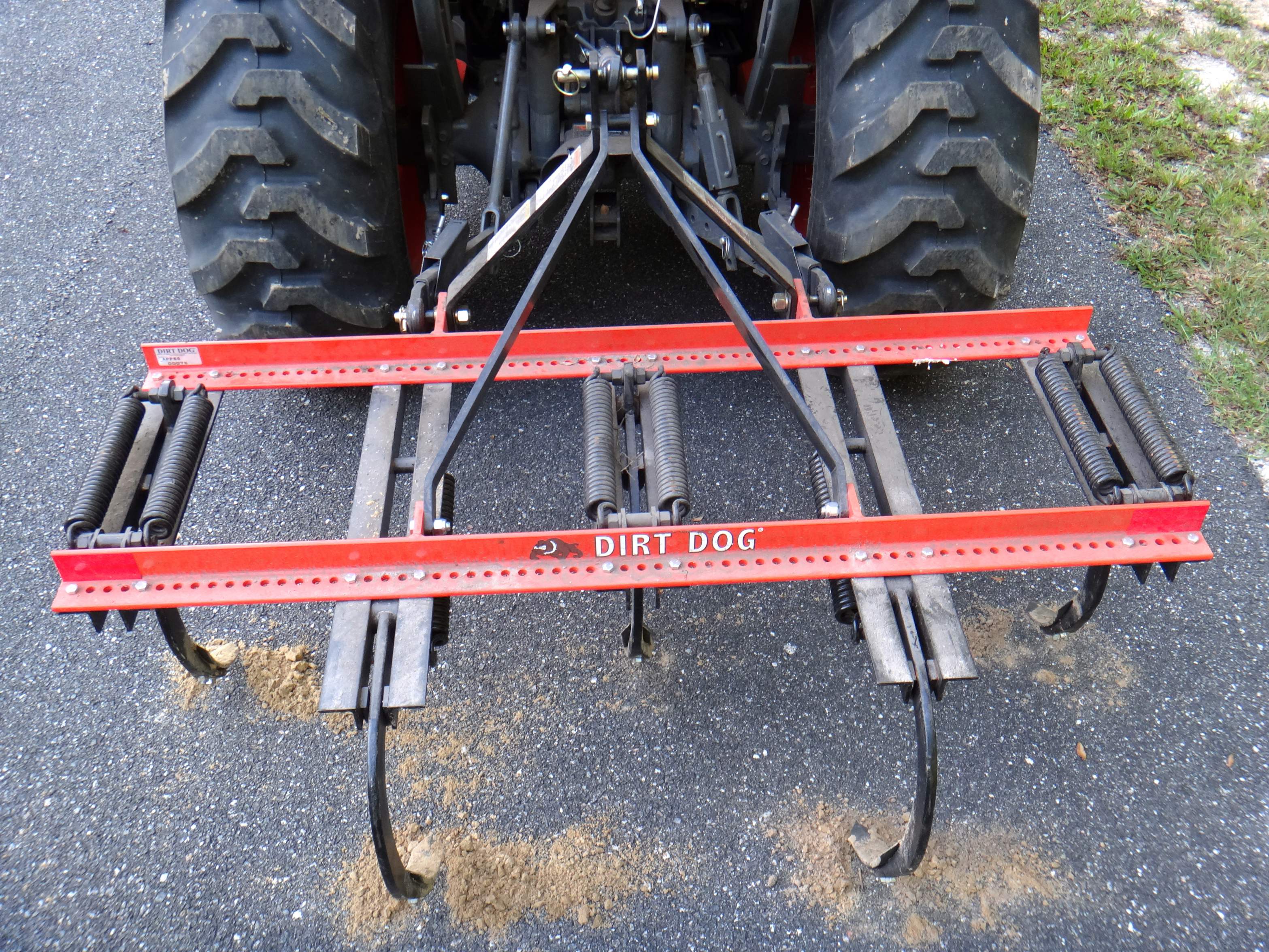

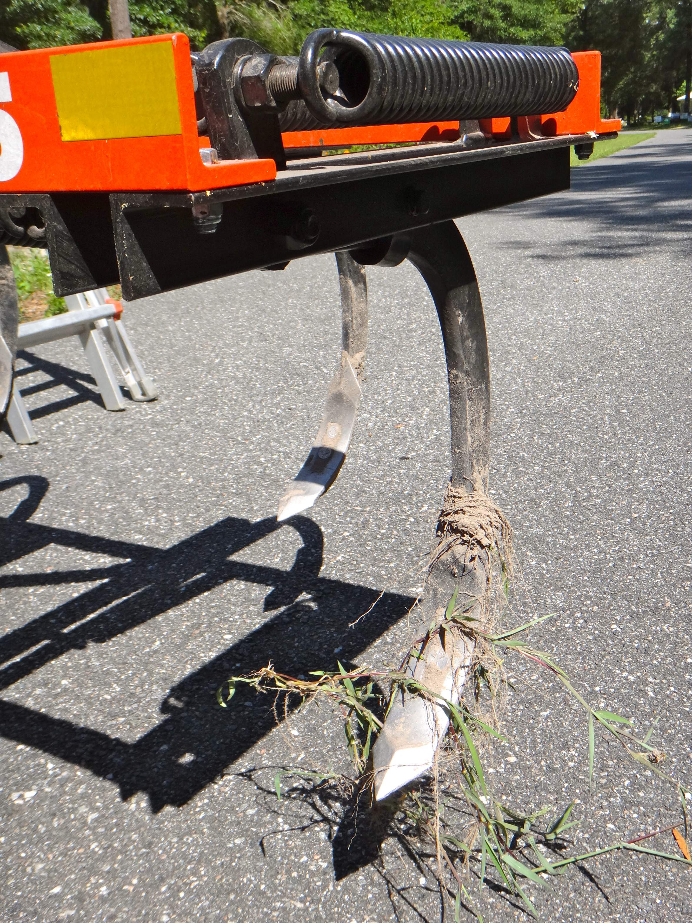

Loaders are not designed to push. Rake from the Three Point Hitch. I use a spring-protected Field Cultivator, also known as an All Purpose Plow. You can rake out a lot of roots and corms but you will never get your land 100% clean.
No surprise: Moist soil essential.
A multi-tine subsoiler is another possibility but it is hard to beat automatic spring protection on a Field Cultivator.
After you rake, let some time pass then spray sprouts with Crossbow, Rural King's Crossroad (exactly the same formula) or Gordon's Brush Killer. All three are enhanced 2.4-D based herbicides. Bathe and change clothes after application.
ARCHIVE LINK: https://www.tractorbynet.com/forums/attachments/339095-dirt-dog-all-purpose-plow.html?highlight=
VIDEO: tractor field cultivator - YouTube
VENDER: Fred Cain 9 Shank 3 Point Field Cultivator
