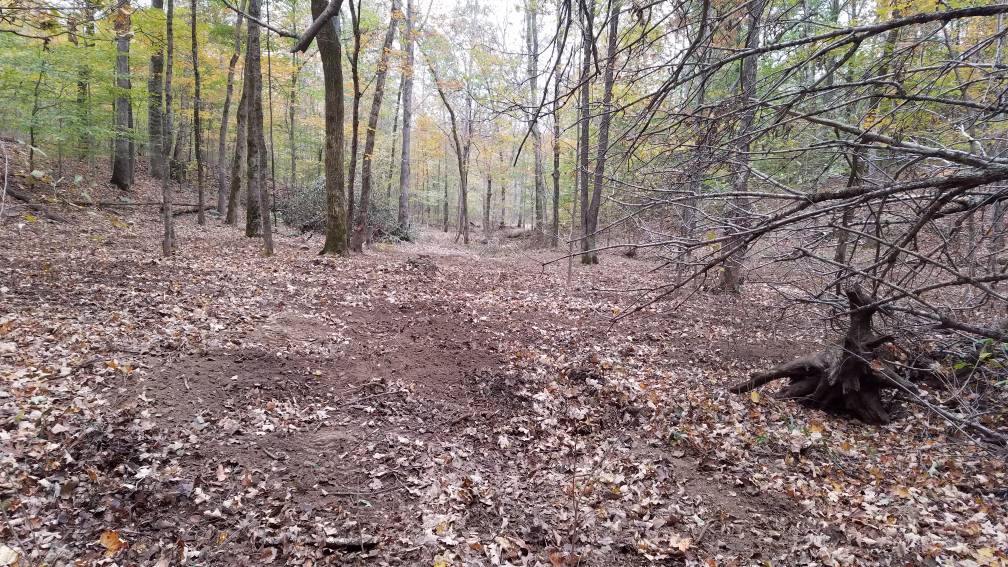

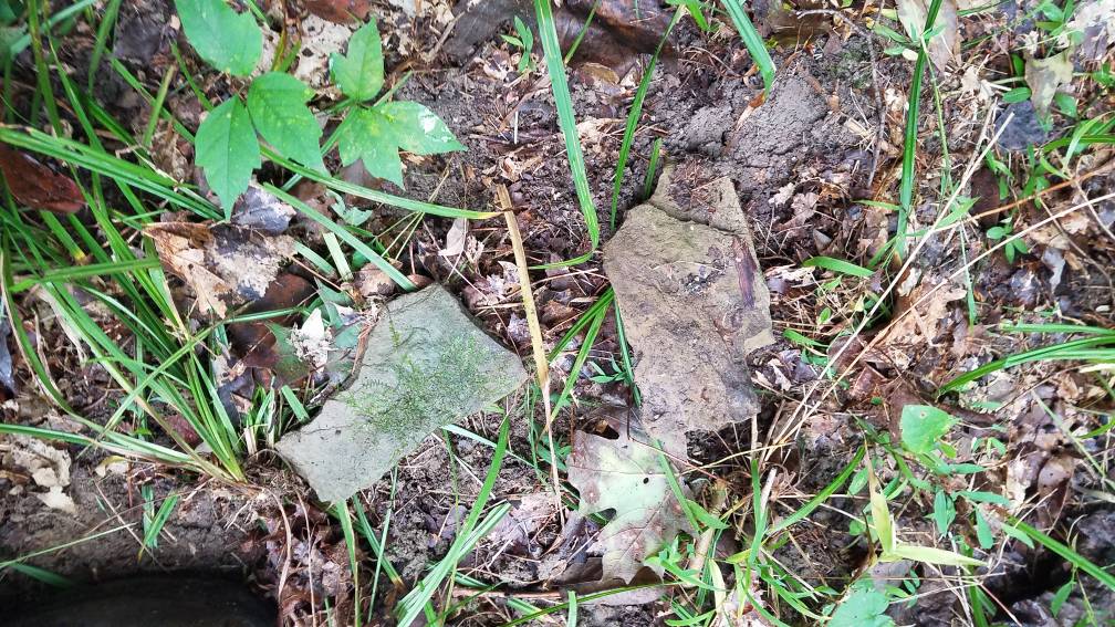

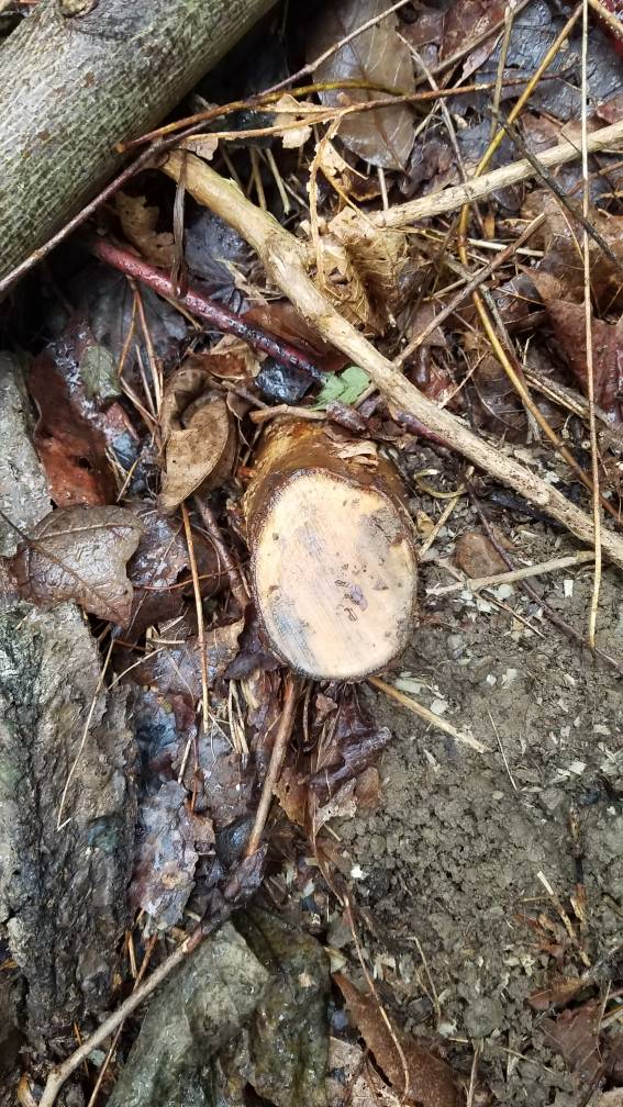

Been at this few months now. Clearing woods to run a tiller thru is feeling like an indefinite task. Considering a disc or bottom plow. Most my clearing is on a slight slope so when I removing stumps and rocks it's a little scary when the tractor picks up from the ground a bit on a slope. Don't mind so much on flat ground. So I'm wondering if I can just run my disc or a bottom plow over these stumps and buried rocks with decent results.
Looking to plant clover in one spot, native grasses like orchard grass/birdsfoot trefoil in another with dense shrubs. Rabbit and deer hunting. My clearings are like in the picture below but most are on a slope making it difficult. Picture of stump and rocks scattered throughout.
I can always remove trees with chainsaw not worried about lighting yet, just wanting it to be a fertile pasture.
My only other thoughts is to rent a mini excavator and rip out all these stumps.View attachment 629809 Screenshot_20191123-060715_Samsung%20Internet.jpeg20191025_123749.jpeg20190827_090607.jpeg20190827_090707.jpeg

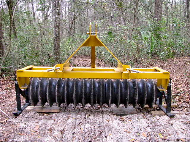

Clover is the major component in NO TILL food plot mixes, so clover does not require mixed soil. The seeds are very small and if covered so sun cannot hit them, germination will be poor. The best thing is to press them into the soil, rather than cover. If you want to buy another implement, a Cultipackker is dedicated to seed pressing. Clover fertilizer should be something akin to 0-20-20. Legumes produce their own nitrogen.

Get rid of the stumps or you will be fighting them for years.Rent the mini-ex and be done.Then plow and disc or roto-till.

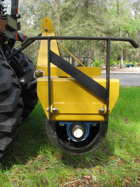

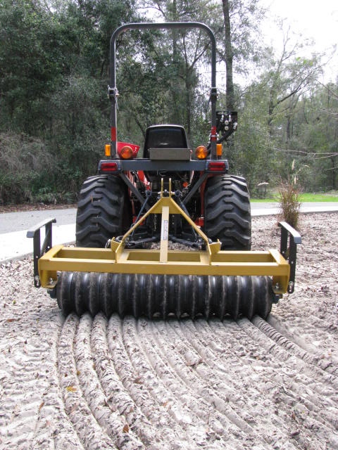

CULTIPACKERS: 5ft Cultipacker - Everything Attachments

With the 15 acres I bought 1.3 is open field. Old hay field, so I never done a soil test. May have been my downfall. I did get purple top turnips to grow in it as I mixed them together. Plenty of sunlight. I feel they didn't get in the ground far enough. Far as the wooded area goes I still think I'm leaning towards renting a mini excavator this week sometime.

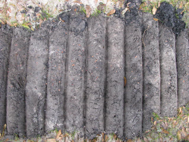

The functions of a Cultipacker are:
1. Press seeds into soil.
2. Extend moisture period for seed germination and perhaps reduce water and winds erosion is some cases via ridges pressed into soil.
3. Flatten dirt clods.
4. Flatten land through roller action, especially with towed Cultipackers, which articulate independently from the tractor. Ken Sweet, Sweet Tractors in Kentucky, usually has refurbished, very heavy, sometimes twin roller towed Cultipackers for sale. Usually too heavy to be Three Point Hitch mounted.
LINK: Sweet Farm Equipment - New & Used Farming Tools & Equipment | Tractor Equipment, Implements
BRILLION LINK: Pulverizer | Landoll ((CURSOR WELL DOWN PAGE.))
I cannot make a good recommendation on Cultipacker weight. If the Culitpacker manufacturers do not have the weight figured about right they would not sell.
In addition to pressing food plot seeds, I use my everythingattachments.com Cultipacker to roll my lawn periodically after a soaking rain. I will have a perfectly flat lawn after several more years of rolling and filling the the revealed low areas with top soil. The Cultipacker formed ridges are easily raked flat.
