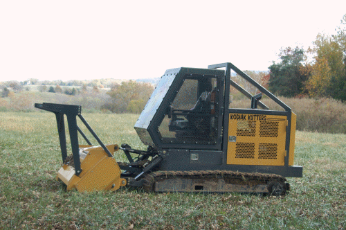

PM me dude and I will come clear it for you!

With my machine your 15 acres would be done in 3-4 days and you can rent the cat, follow me around grubbing stumps then I will run through grinding the root balls. Purpose built is the only way to go unless it is your hobby to get out in the woods.
