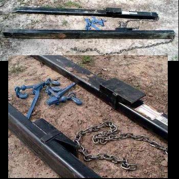

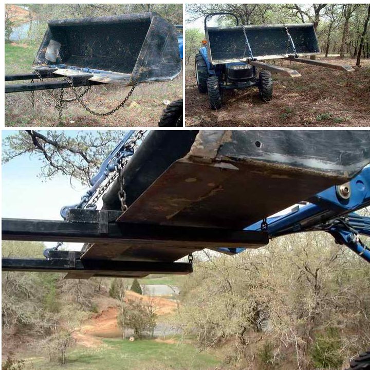

Today I just bought chain-on loader forks for my NH 16LA with HD bucket. There is a bracket which fits over the cutter lip and a chain goes behind and over the top of the bucket and attaches with a "boomer" for easy and quick assy/removal. These forks are rated at over a ton and are manufactured by a company in Colorado. At my New Holland dealer, the cost was $280. I tried them on brush (large tree trunks) and moved several telephone pole sections (5' to 25'). The hardest thing about them was getting used to being 4' longer and the magnified movements of something so far out in front of the bucket. I absolutely think they are worth the money and I can install and remove them in about 30 seconds. If you are interested, I can send you a digital photo attachment.

Okay Richard, I took some photos and I'll attach one to this message and another to the next message. I think they show everything you need to know about the chain-on loader forks I purchased for $280. There is one slight problem, the manufacturer's company name is Foothills (Foothill?) and they are in LaSalle, Colorado. It turns out that their name label was scraped off my forks, so all I could see was the city. I purchased the forks from McMaster New Holland in Decatur, TX. If you want to contact them about shipping you a set, their phone number is (940)627-2198, fax - (940)627-6671, or E-mail - mcmasternh@ntws.net. Steve McMaster sold me my tractor and suggested these forks. You might ask for him.
I hope this helps.
JimI

Richard, I have attached the forks to my loader in this picture collage.
JimI

thanks for the pics Jim. Those look like a good setup. My only concern would be that it would be hard to use the bucket if you had them on. However, the reason I haven't gotten any of the clamp on ones is because I wondered if the bucket would hold up to a ton of weight on the forks? With your setup it takes the pressure away from the lip of the bucket which I like. Thanks again for the pics and info.
