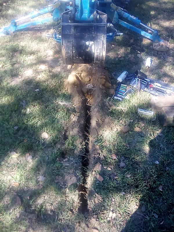

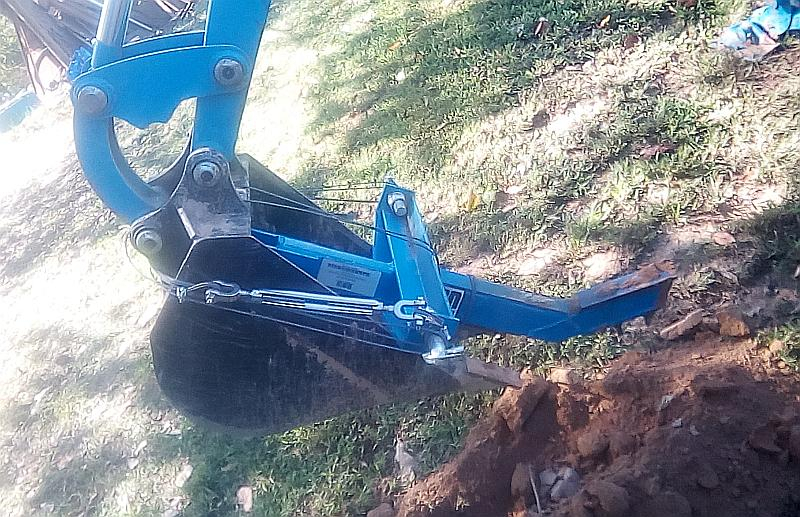

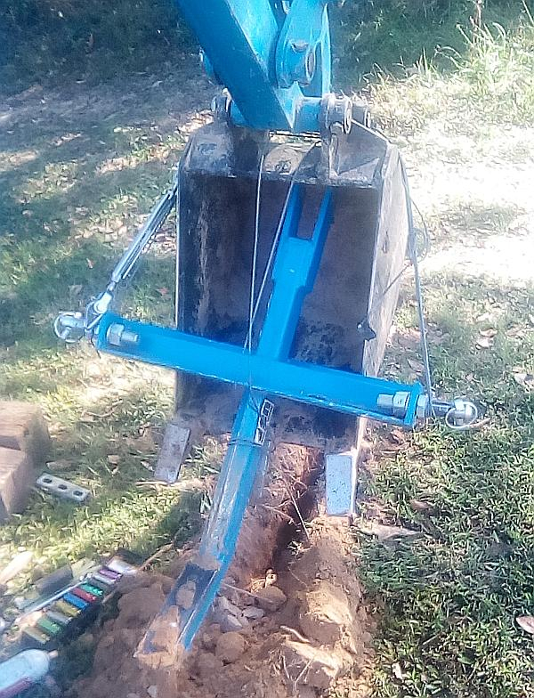

I had to see if the idea would even work at all. Subsoiler is just lashed to the BH bucket with steel cable. Worked better than I expected for a first try, but I need to find a quicker, simpler, more secure method. This would be annoying to do to snap a root or two while digging a stump.
I also would like to find a sawtooth edged wedge to bolt on, more like what some of the factory root rippers have.
This should also work for cutting a narrow trench for conduit in place where you can't really back in and drive out. You'd be able to set up and reach in between things.
Slot is almost a foot deep and I could have gone a bit deeper.

Side of the bucket would be a problem for offset torque and twisting, plus I don't want to drill any holes. The subsoiler is already sort of a ripper shank and can be centered and supported by that center tooth.
I just need to work out a faster, easier way to mount and dismount for temporary use. A sturdy muffler/exhaust clamp might work over that center tooth, but I still have to come up with a way to secure the top. I'm thinking about a piece of pipe or electrical strut cut to fit snugly inside the bucket. I'd rig it up to accept a toplink pin through the subsoiler and some 'L' brackets and large c clamps to the sides of the bucket.
