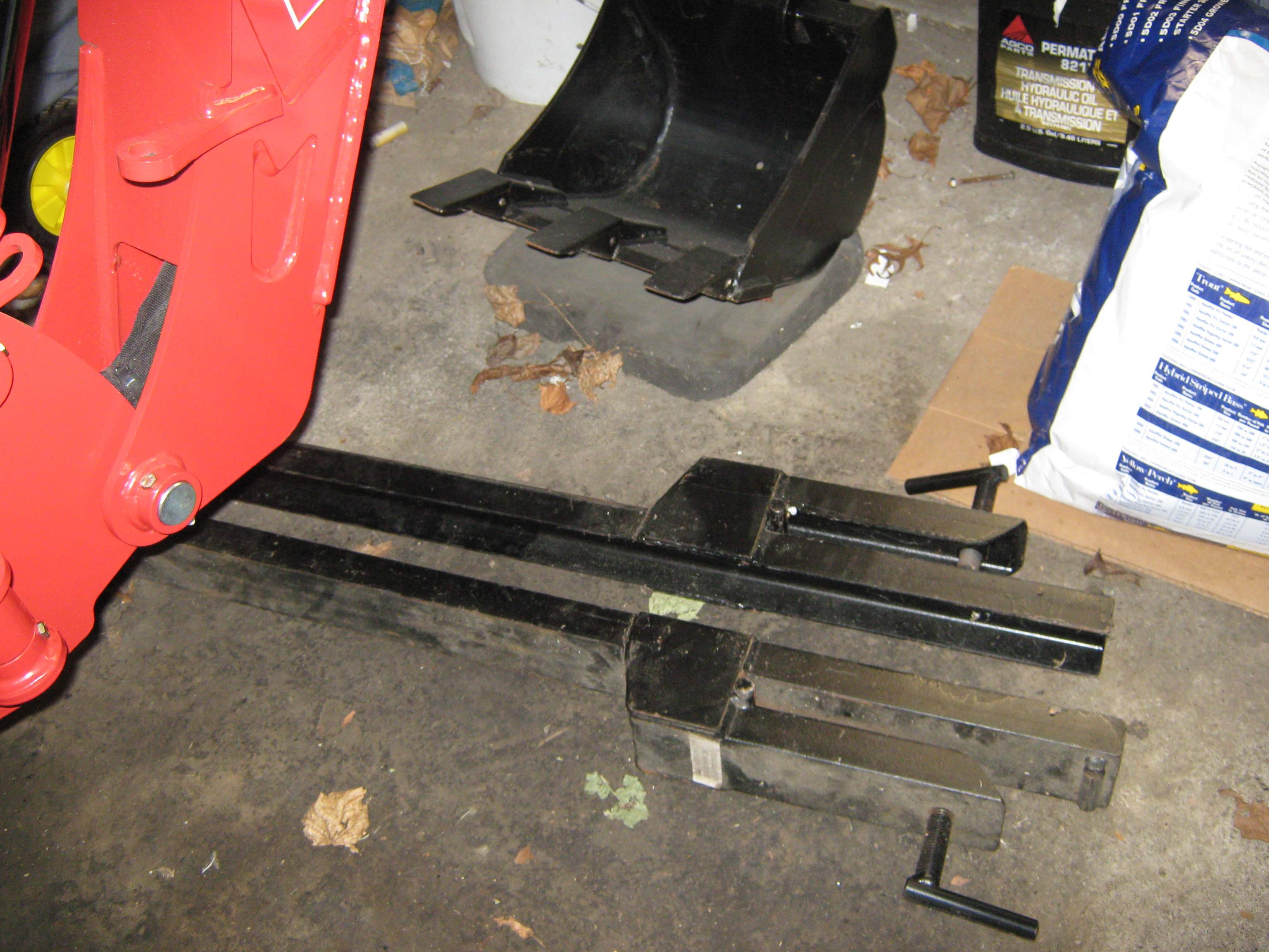

I took my backhoe off of my truck with clamp on forks, an did not bend a thing. Not even the bucket.

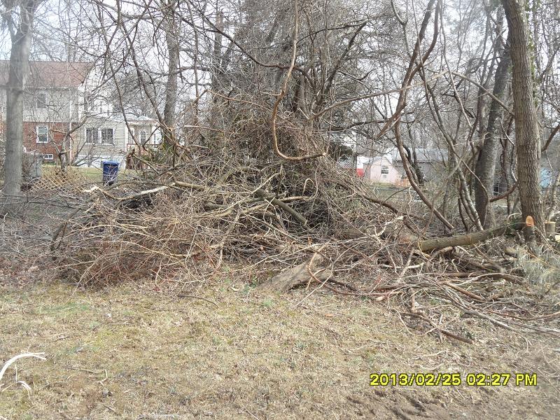

I originally bought a pair of the 4,000 lb rated forks for my M4700 w/ stabilizer bar, last year. We used them a LOT in Virginia. Their main use was as a root grapple and we piled a lot of brush and they worked rather well for the $240.
We quickly determined the stabilizer bar was essential, twisting is not fun.
We also used them for moving a bunch of HEAVY palletized equipment, the planer pushed 1300 lbs.

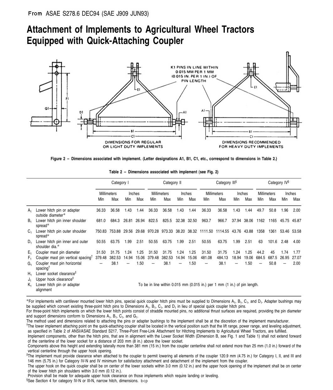

I just need some measurements for the three point hitch. What is the standard measurements for CAT 1 three point hitch?
Here are measurements:
Bruce
