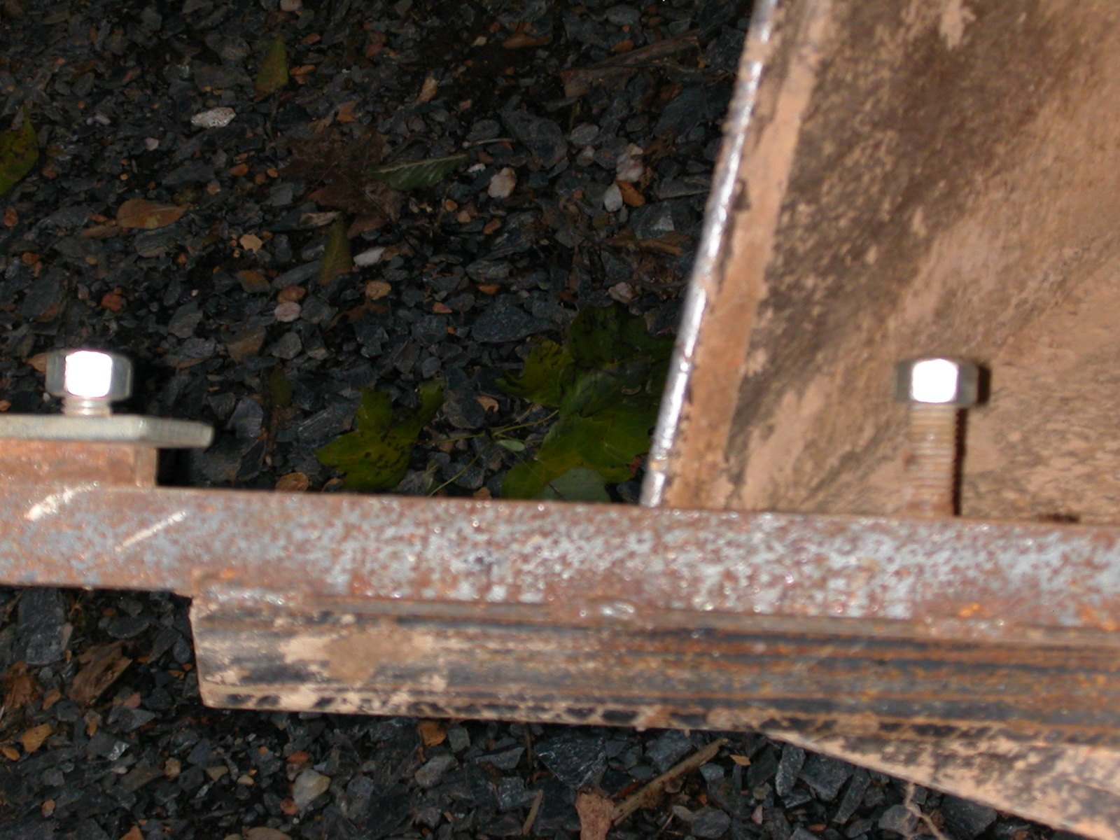

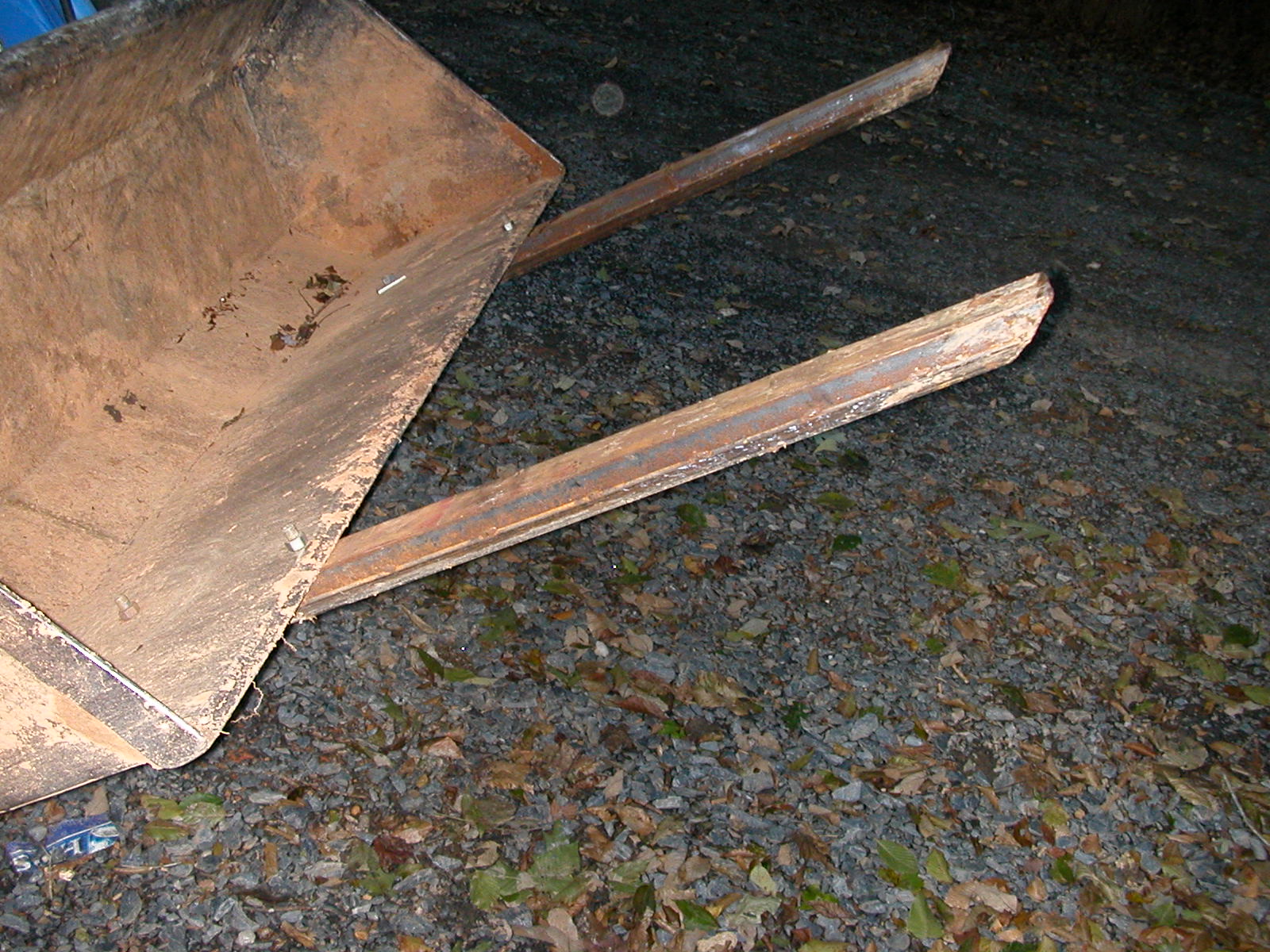

Some simple quick forks I made from scraps for my TC33 NH bucket. Made from 1 1/2 " channel iron and 1 1/2 " angle iron. I welded the angle to the webs of the channel iron webs. Angle cuts on the leading edge sealed with caps.
My bucket had holes already drilled for something so I used the spacing for the bolt pattern , Welded the bolts in the channel and added a 1 1/2" x 1 1/2" x 1/2" spacer on the back edge to level them on the bucket before closing them up with the angle and end caps.
They are about 20 in. long and bolt to the underside of the bucket, 2- 3/8 " nuts hold them in place.
I keep the forks attached to the scrape blade when not in use with elastic straps.
