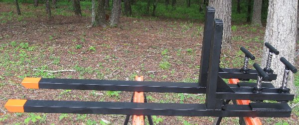

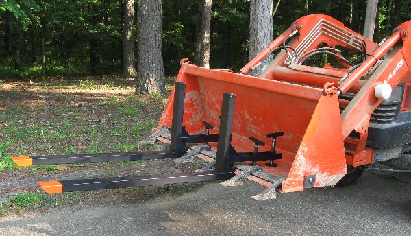

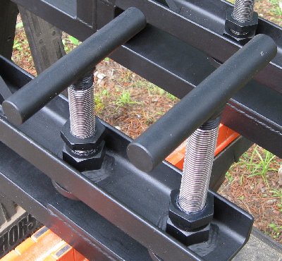

I've wanted some clamp on bucket forks for quite a while. In fact, I joined TBN so that I could send a PM to Madreferee and get his plans for building a set. A year later I decided to make it happen. I researched companies online and read lots of info on TBN to find out why people were unhappy. I thought about buying a set, but I could not find a set that employed more than one clamping mechanism. Also, for the price they want, I was sure I could fabricate a set cheaper (I'm scared to add it up, but I don't think I saved very much!).
Thanks to Madreferee for his initial plan wherever he may be. Some major redesign and lots of hours of fabrication and here is what I ended up making...

Any problems with keeping them straight?
I heard others complaining that the clamp on style would angle from side to side if you put any side load on them.

What did you use for the T-handle bolts?
That was the major complaint that I saw, that is why I used two clamps. I grabbed the tips and shook them back and forth without them moving. It's a major advantage over the one clamp version everyone sells. Wonder how long before someone sells a two clamp version now? Tell them to send me a check! :)
Vic
I tried to keep the number of materials to as few as possible. That meant I had 1" rod (where the lip of the bucket clamps), so I used that as the handle. I wanted 1" all-thread to match, but decided to go ahead and spend the extra money (and it was A LOT extra) and buy ACME threaded rod. It works better in dirty environments.

Did you get the "Acme" threaded rod from your local steel supplier or what was your source? And What is the female portion for the rod. Gene

The acme rod and the nuts (welded to the channel) were both from McMaster-Carr.

Really nice job. I wanted to build a set myself but did not have time and purchased a set of Paynes clamp on forks. The double clamp should help keep the forks straight never thought about that approach. I was going to attempt to increase the contact area where the fork fits to the cutting edge. My thinking was if I could lengthen this contact area the forks would be less likely to move...

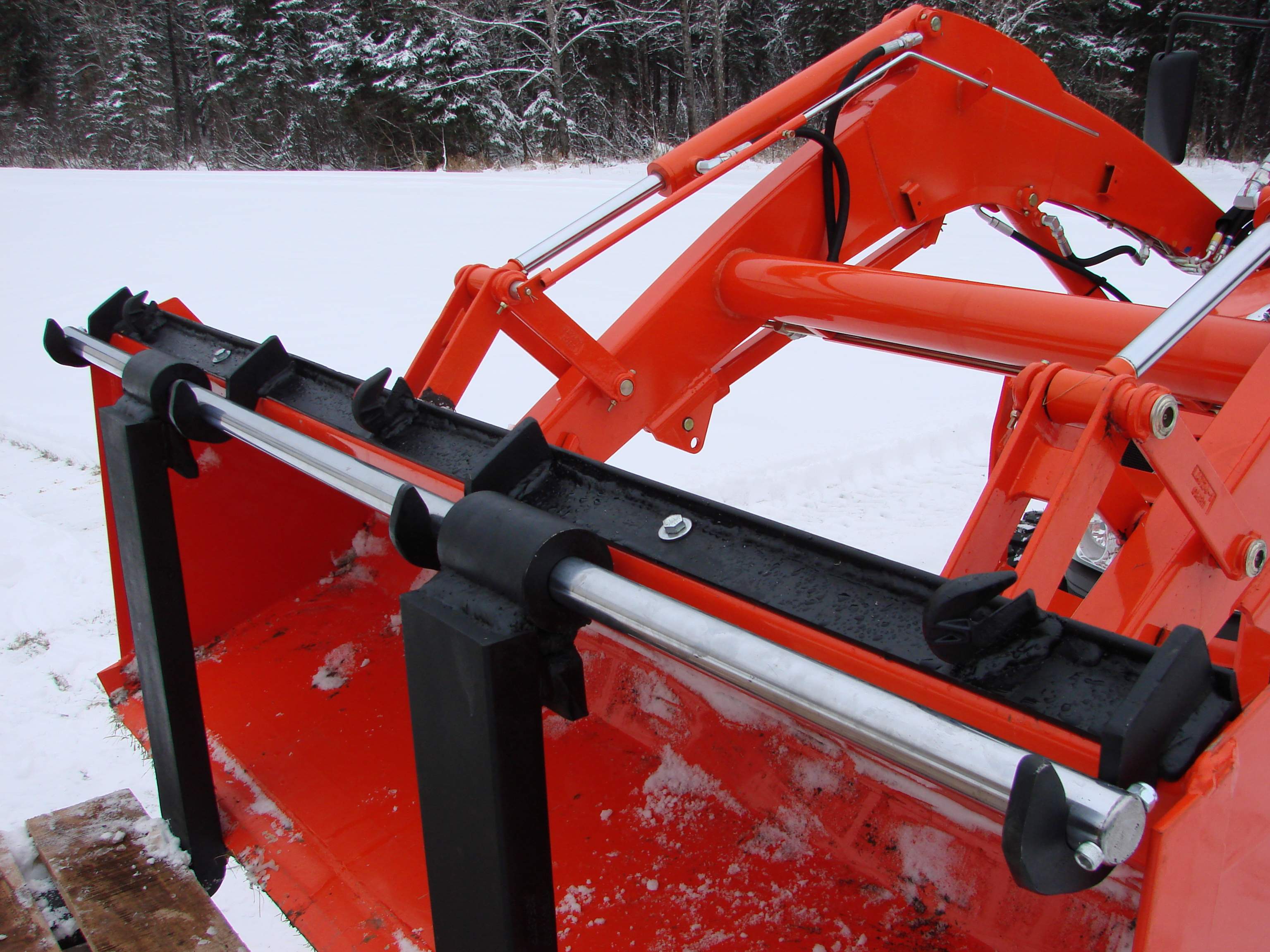

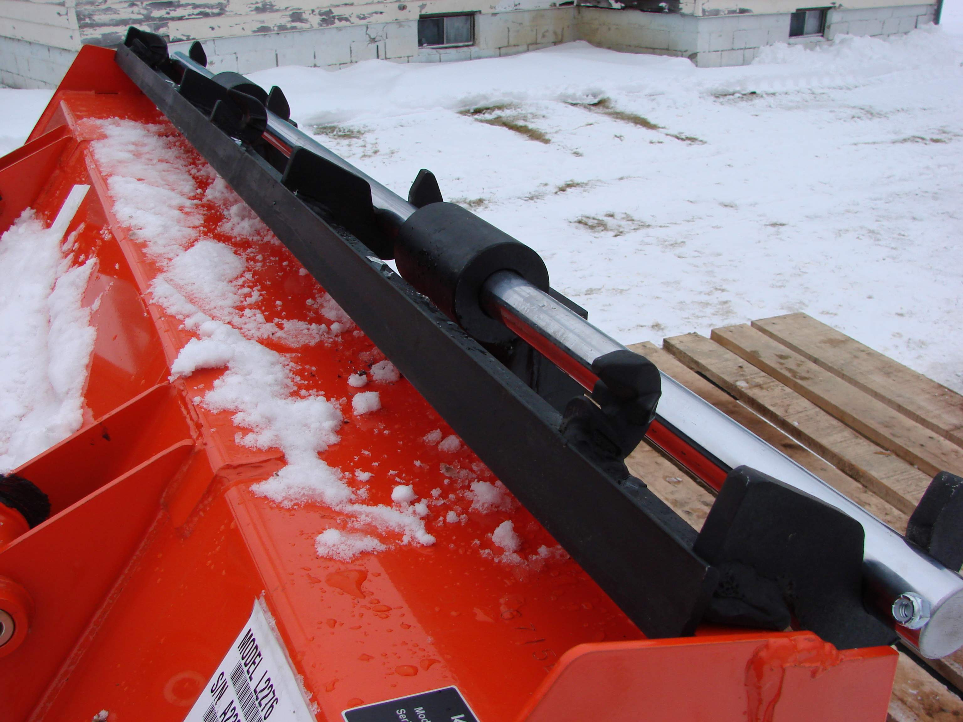

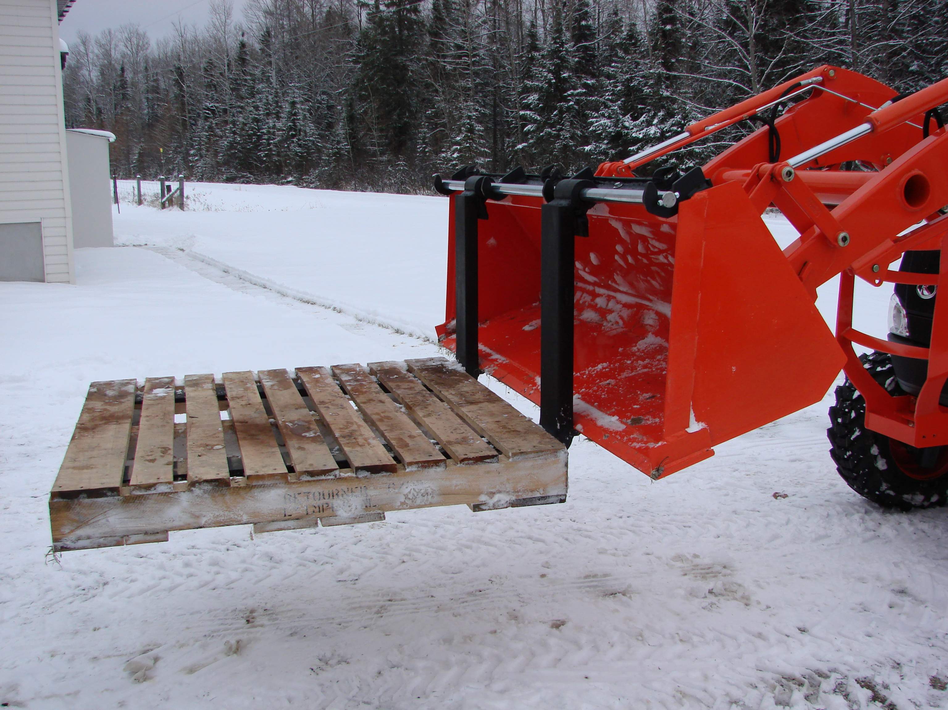

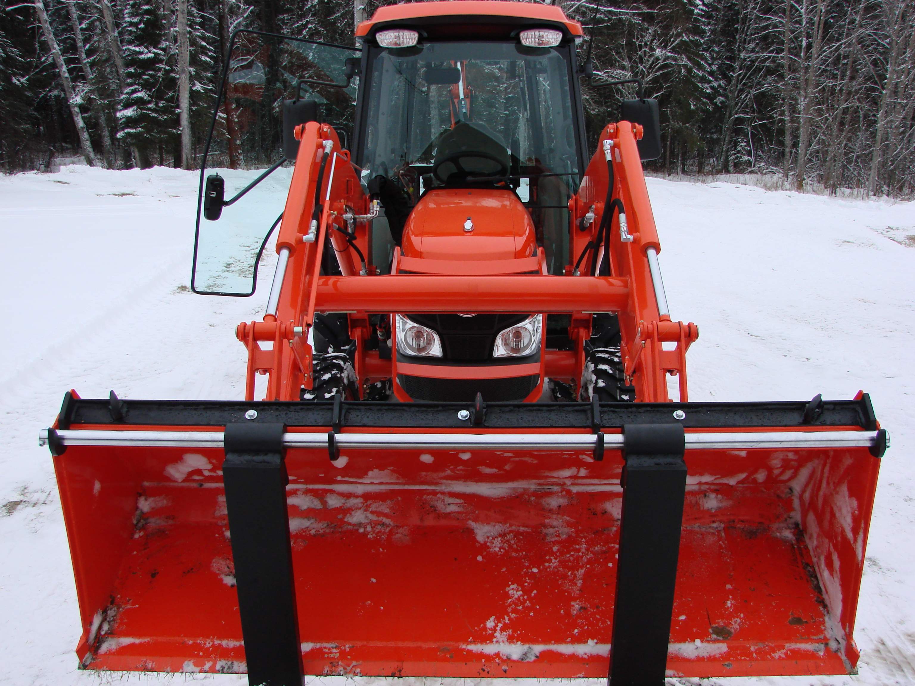

Love This Site.. enjoy sharing some of my experience and ideas...
Here's my custom bucket fork attachment, simple quick connect and welded on chain hooks. easy to build... enjoy
