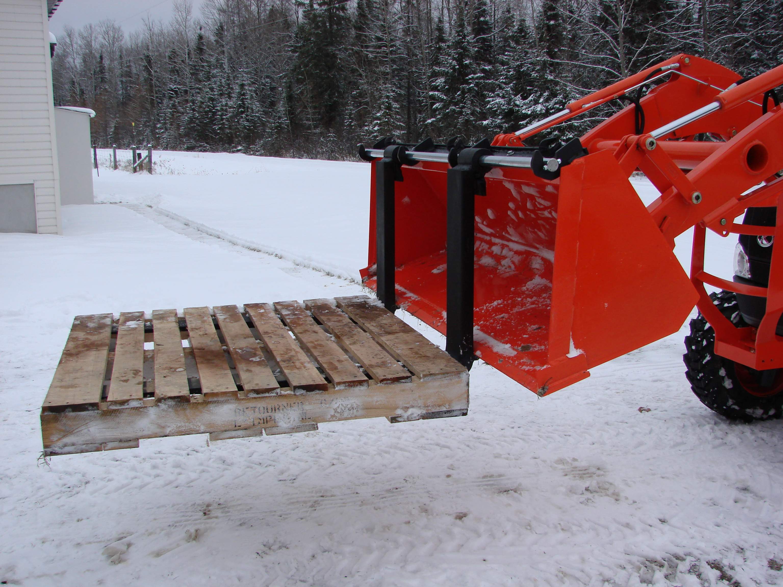

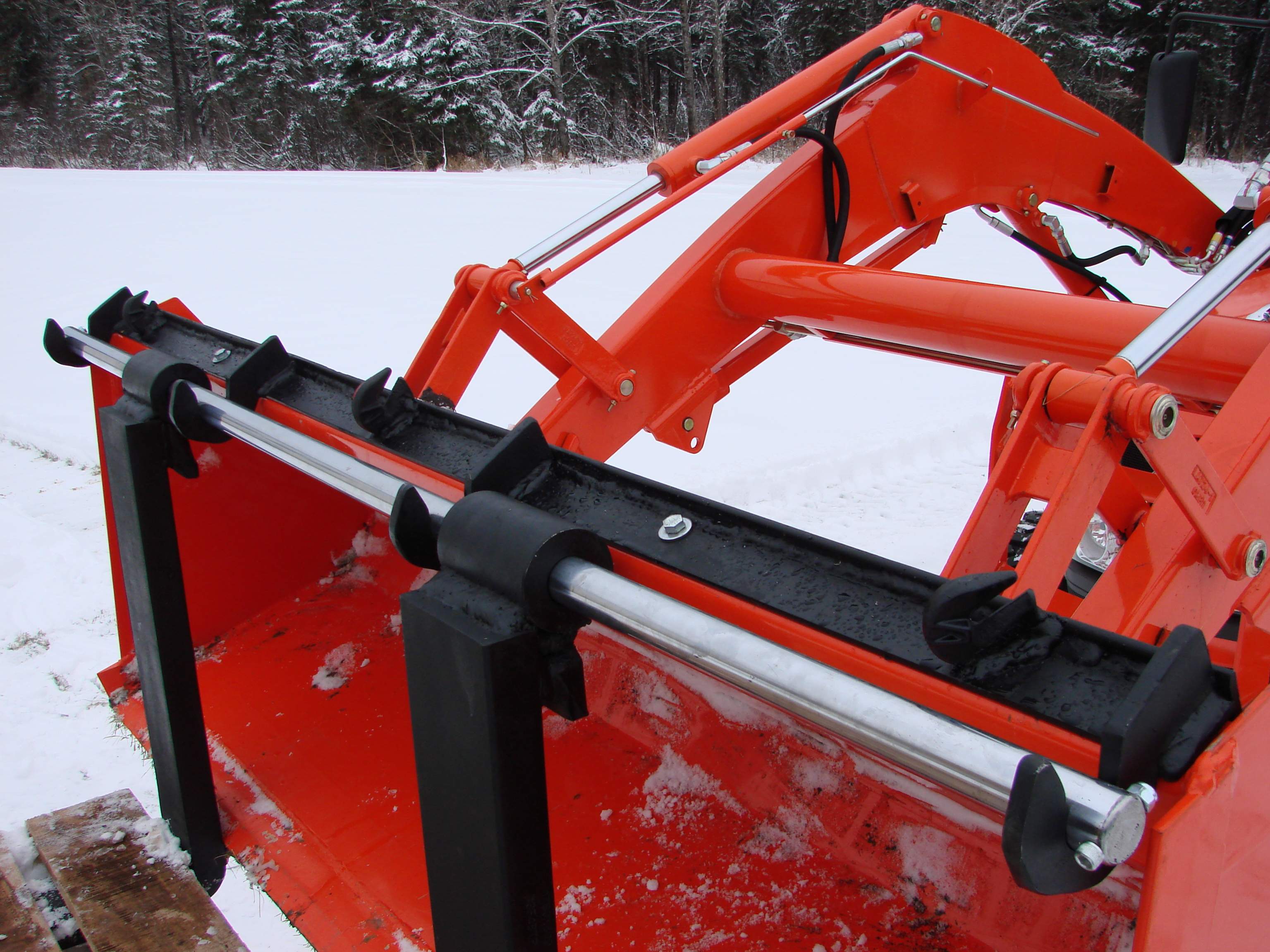

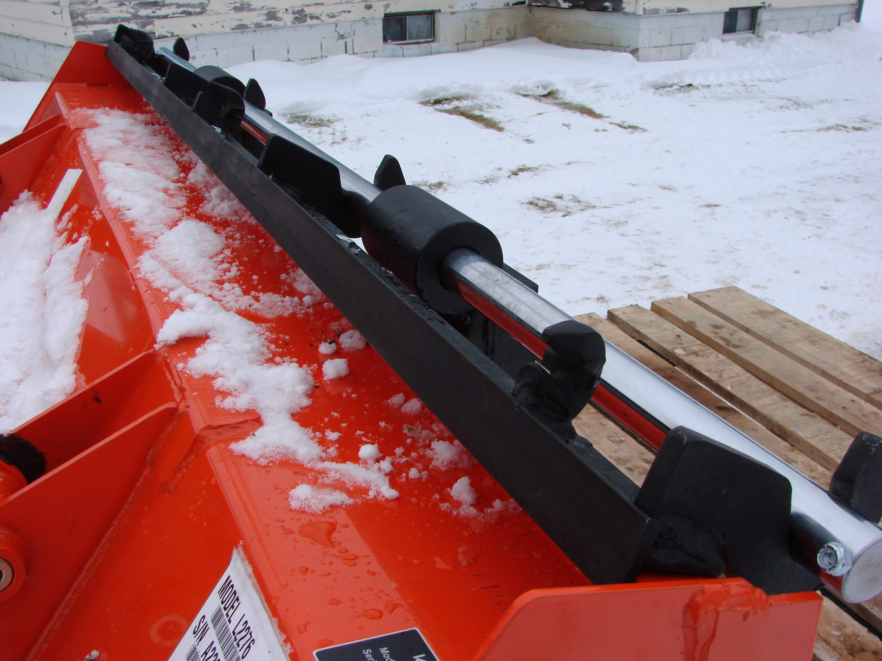

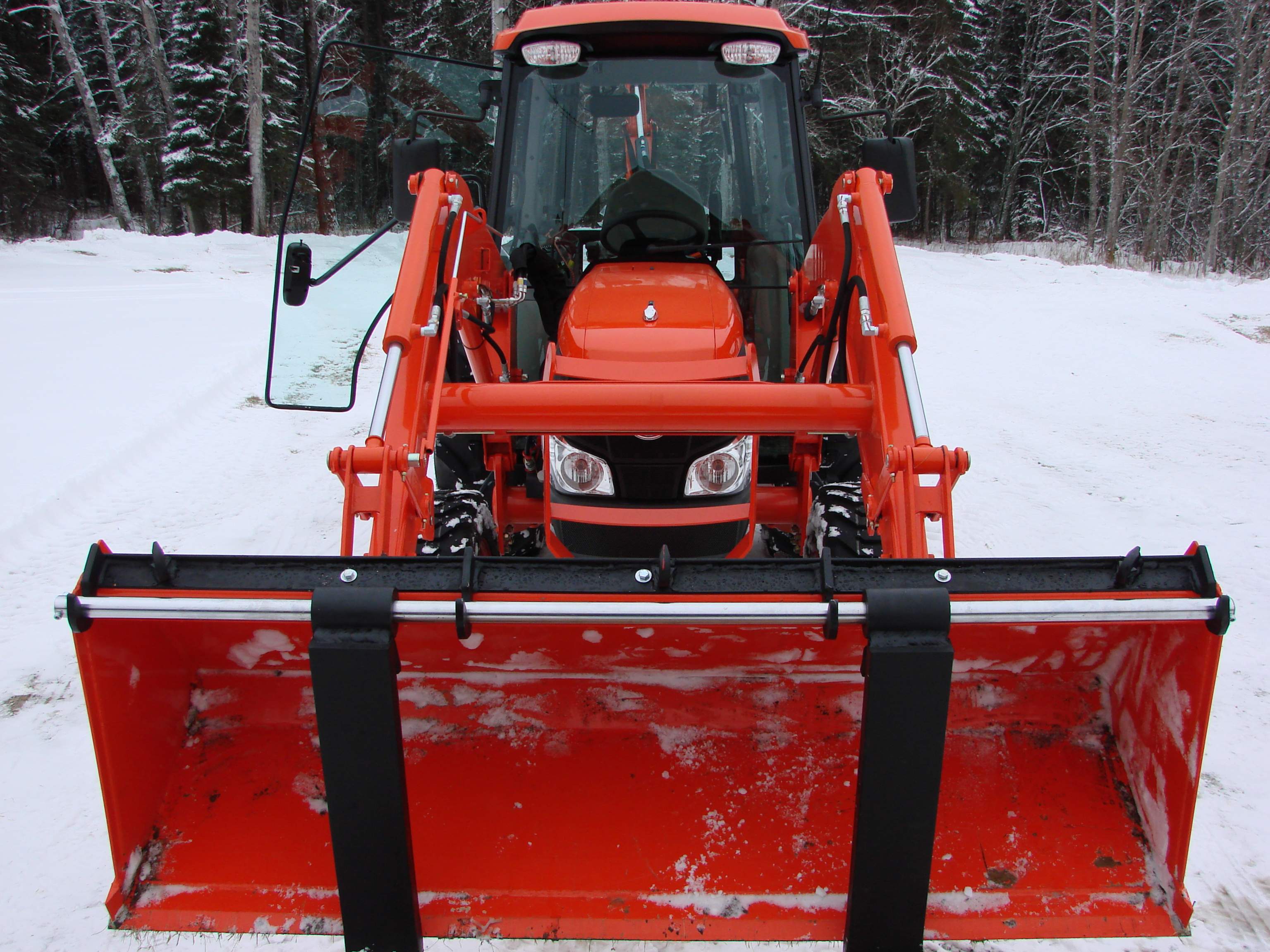

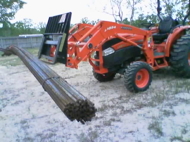

Forgot to mention ,, I guess a self leveling valve would be asset for forks,, does Kubota make one for L3540... let me know what you think of my forks..
/ Clamp On Bucket Forks #22
Nice looking job on those forks. Would have swiped your idea if I hadn't blown the money on Payne's a few years back. ;)
One of those deals where I absolutely needed forks right away because I was having a steel building delivered and had to get the banded together sections off the tractor trailer somehow.

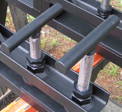

That was the major complaint that I saw, that is why I used two clamps. I grabbed the tips and shook them back and forth without them moving. It's a major advantage over the one clamp version everyone sells. Wonder how long before someone sells a two clamp version now? Tell them to send me a check! :)
Sorry to bust your bubble but I built a set over a year ago that had dual clamping design. So PM me and I will give you my address to send your check to:D
