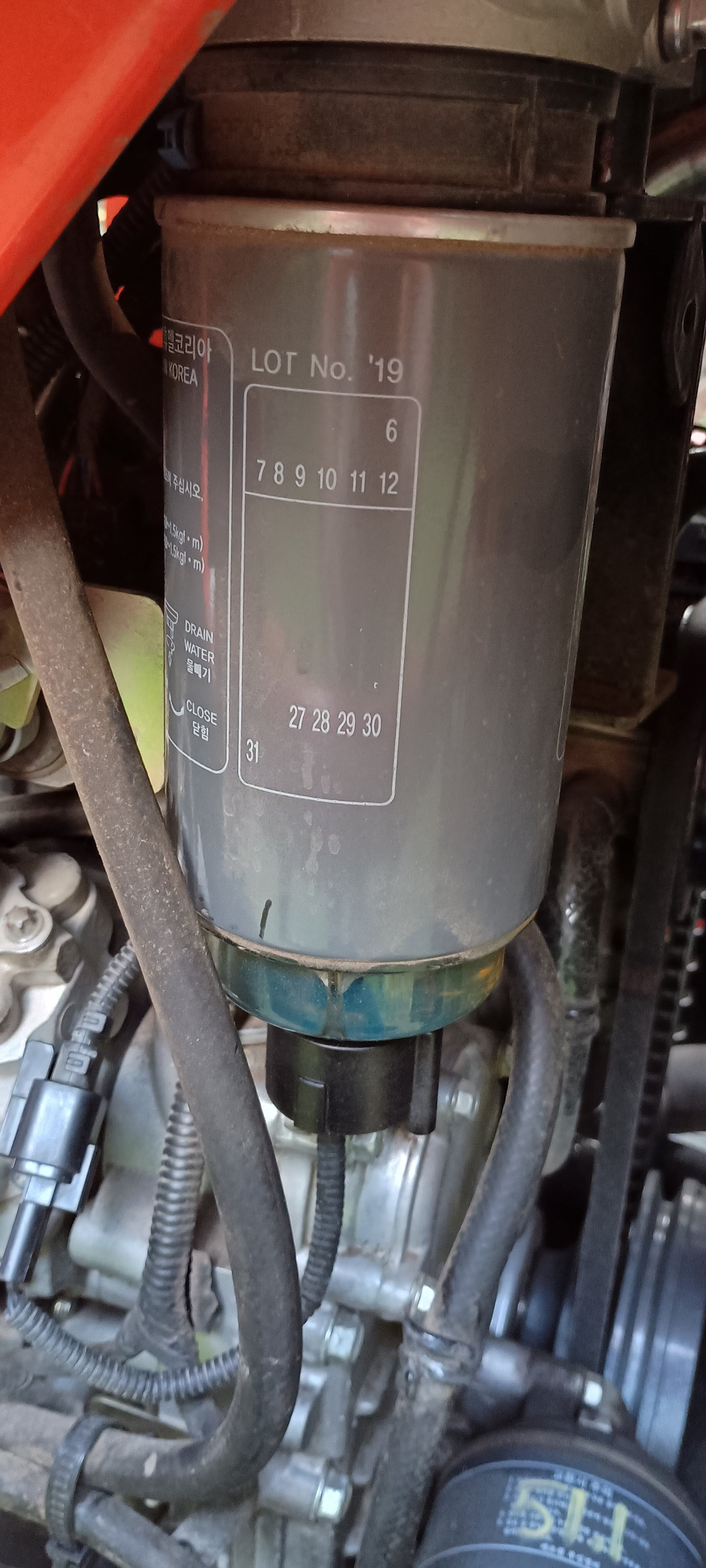

Tractor is a 2020 CK3510HSE (hydrostatic, SE, open cab)
Seems to be a lot of reference for the F6800-16411 fuel filter, including my own manual.
My tractor has a clear bowl and water sensor on the bottom. Looks like EH35-0011A based on what I was able to get from a cellphone pic (side with numbers is towards engine).
Why is this so damn hard to find?

/ Ck3510HSE Fuel Filter?
#11
Main thing is that its a single clip and not the normal 3.
So here's the weird thing, the air filter has 3 clips...
But this is my fuel filter:
I'm not following how the 2 are connected?

#12
I ended up buying the EH35-0011A from
$97 all in, shipped same day. Unless USPS bobbles it should have it Monday afternoon
