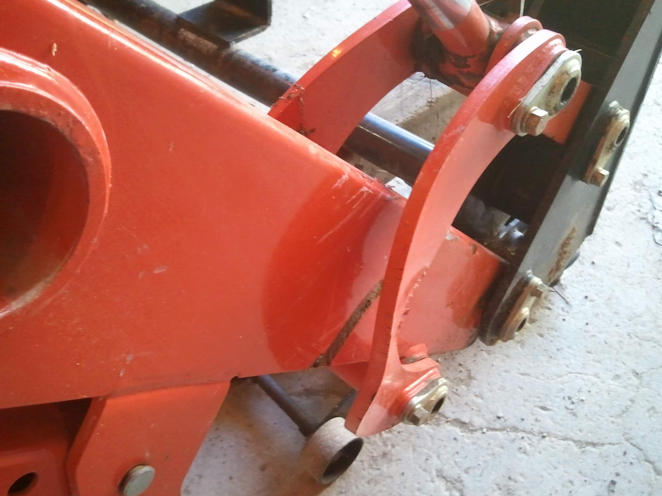

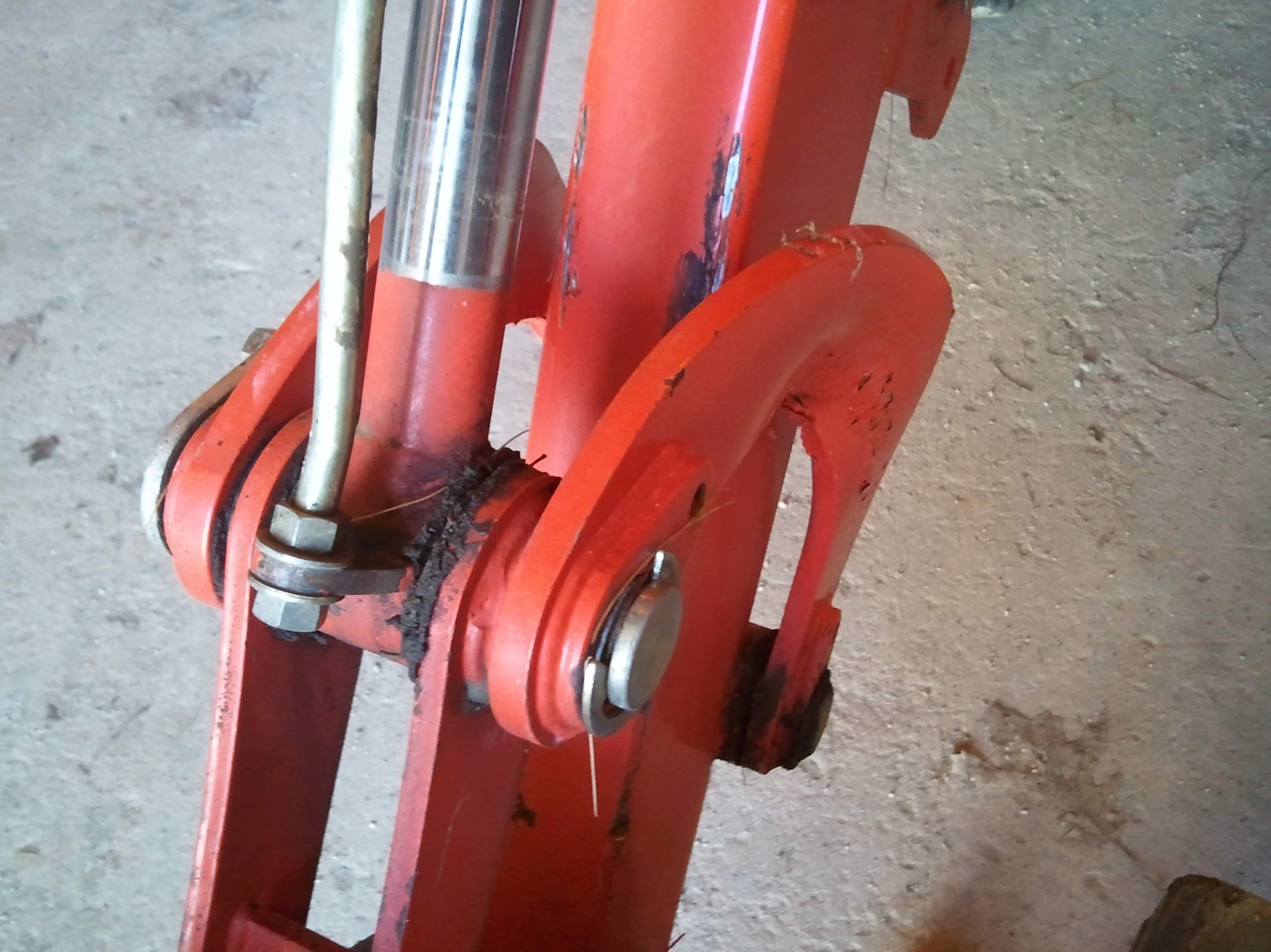

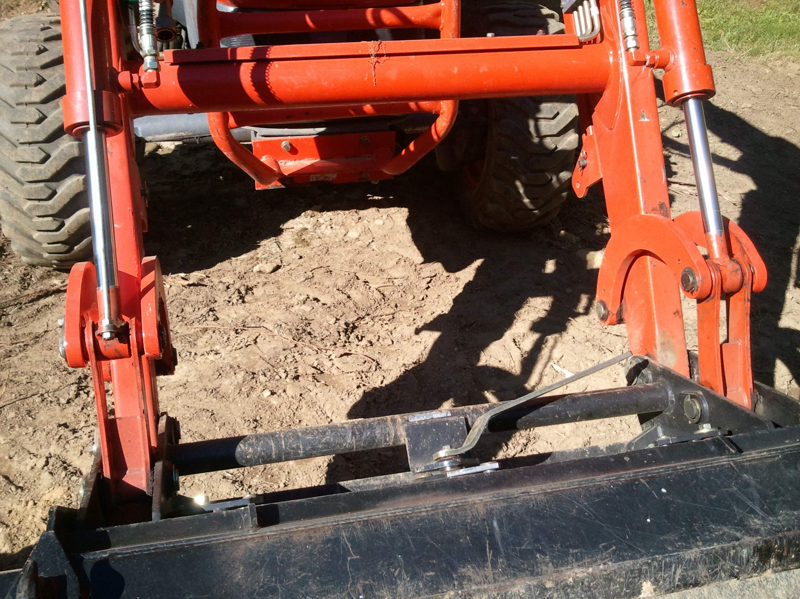

This post will get people talking. A couple of years ago I turned my curl brackets on my DK45 into pretzels. The brackets are made out of 3/8" plate with the ends doubled to provide pin bearing surface. Local dealer a couple hours away wanted about $85/ea plus shipping and figured a couple weeks delivery. I had a plate shop cut new ones out of 3/4" plate and a machine shop bore the pin holes and threaded pin retainer holes. My cost was about $55/ea and I was down for less than 2 days. At the time down time was critical. Yes I greatly strengthened the curl function of the loader. Yes I took it easy for a while looking for the next weak spot. It has now been a couple of years and no problems. WP_000186.jpgWP_000174.jpgWP_000175.jpg

I noticed my dealer had four curl bracket hanging on his display panel when I was last in, so it must not be that uncommon to bend them.
