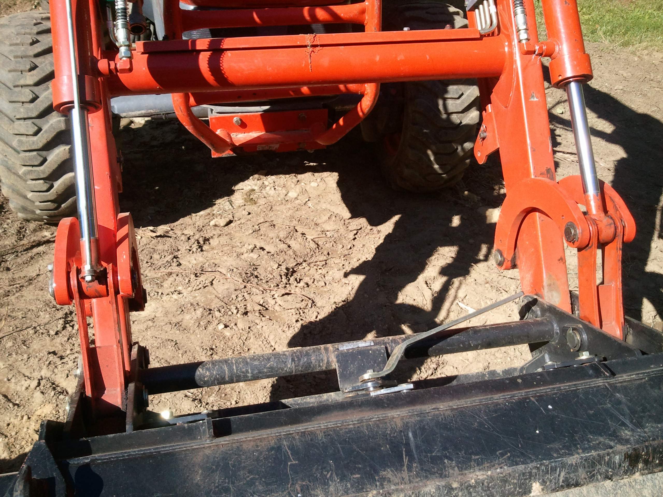

Please help me to understand. When back-grading, say the bucket is level, no problem. If you curl the bucket as to dump the bucket, and the front wheels come off the ground, and back grade, It's this position that stresses out the linkage. Is this correct?
/ CK35 Loader Problem #42
Correct. You don't even need the front wheels off the ground. All that's needed is to come against something in the ground that won't move or even the ground it's self while back blading with the bucket curled most of the way down. It's not only small tractors that have this problem. It happens to large tractors too. And the color of the tractor doesn't matter either. They are all vulnerable.

Chuck you would a lot better off if the loader was in float when back-dragging. That way the loader arms are free to "float" up when it hits something immovable. The weight of the loader and bucket will smooth out material like gravel and dirt. You will do a lot better job, and a lot less strain on the parts. Also don't point the loader bucket down or even any where 90 degrees down. Sure you can give the lip of the bucket some down angle to accumulate material under the bucket to be distributed into the low spots, after all that is the whole idea when smoothing, but trying to drag back material in a locked cylinder and vertical or even reverse angle position is what caused this breakage of parts.

If you backgrade in float position you will not have a problem. I have hit hidden rocks and even low stumps I did not see, and it causes no problems, the bucket and arms just slide over the immovable object without any real strain at all.

I think I get it now, the no-go position of the bucket blade is 90*. Just a back-tilt is o.k.
/ CK35 Loader Problem #47
90 or more is the worst, use float and less than 90.

You know I was thinking about all of this and I am going to reverse my position completely on the op's original pictures. I don't think these brackets would break from back blading. I think the cylinders would bend instead. This break is caused by having the bucket curled all the way down (or forward) and then pushing forward into something. Your thought's?

I said I was backdragging with the bucket blade curled all the way under toward the tractor; why is this so difficult to comprehend?

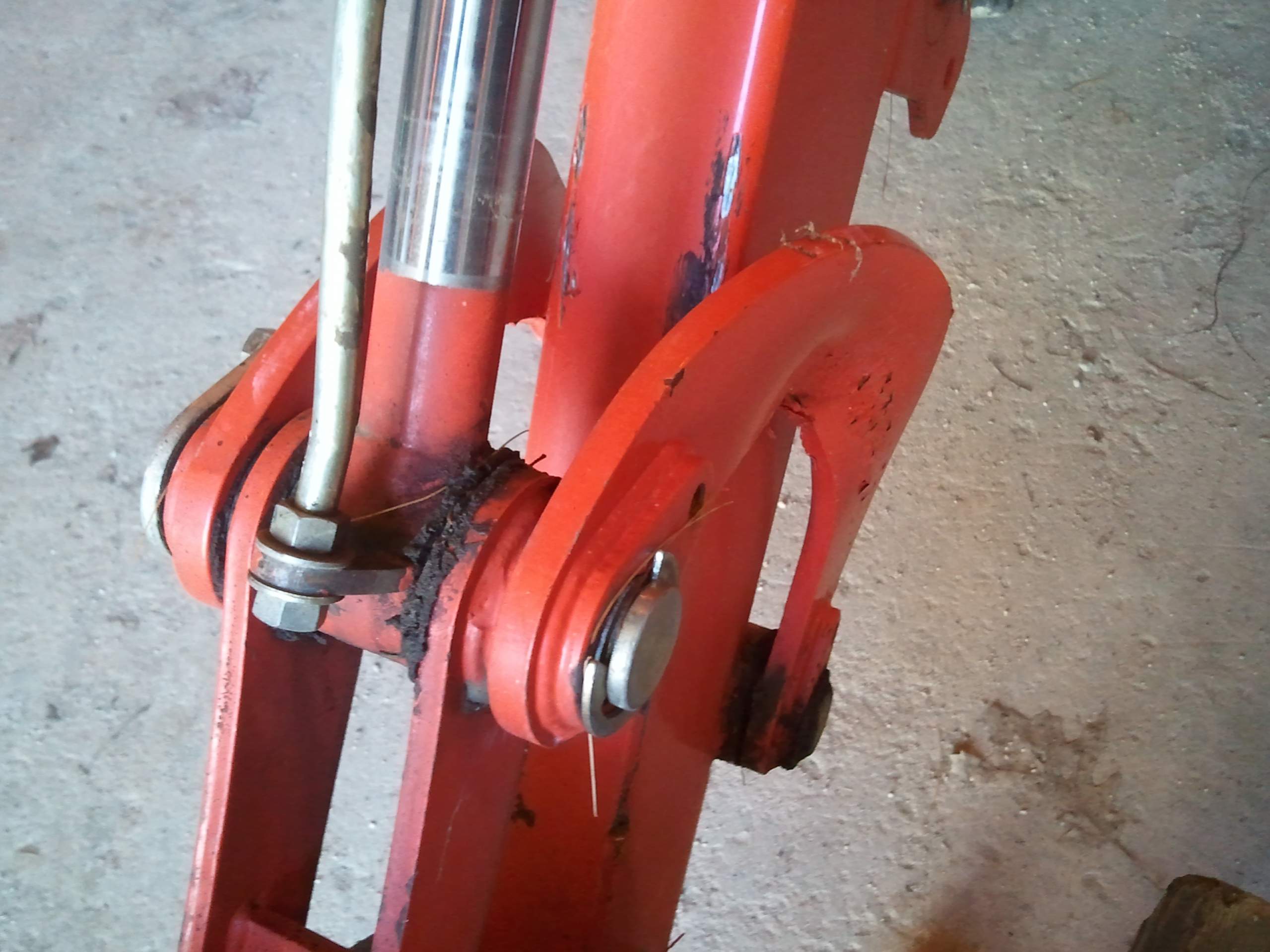

I measured and found that the link BELOW the half moons (as some have termed them) is 50% thicker material. Half moons=6 mm, lower link=9mm.

It's not the comprehending that is difficult. It's just the visualising in my mind how this happened. I think I got it now. It's the fact that the pieces are in a half moon that takes the strength out of them.

That's quite the difference in metal thickness/strength on your curl brackets.
Judging by your pictures of the bent ones I afraid I would have done the same thing.
3/4" plate may have been a little extreme, but I would have had them made up stronger than the OEM brackets

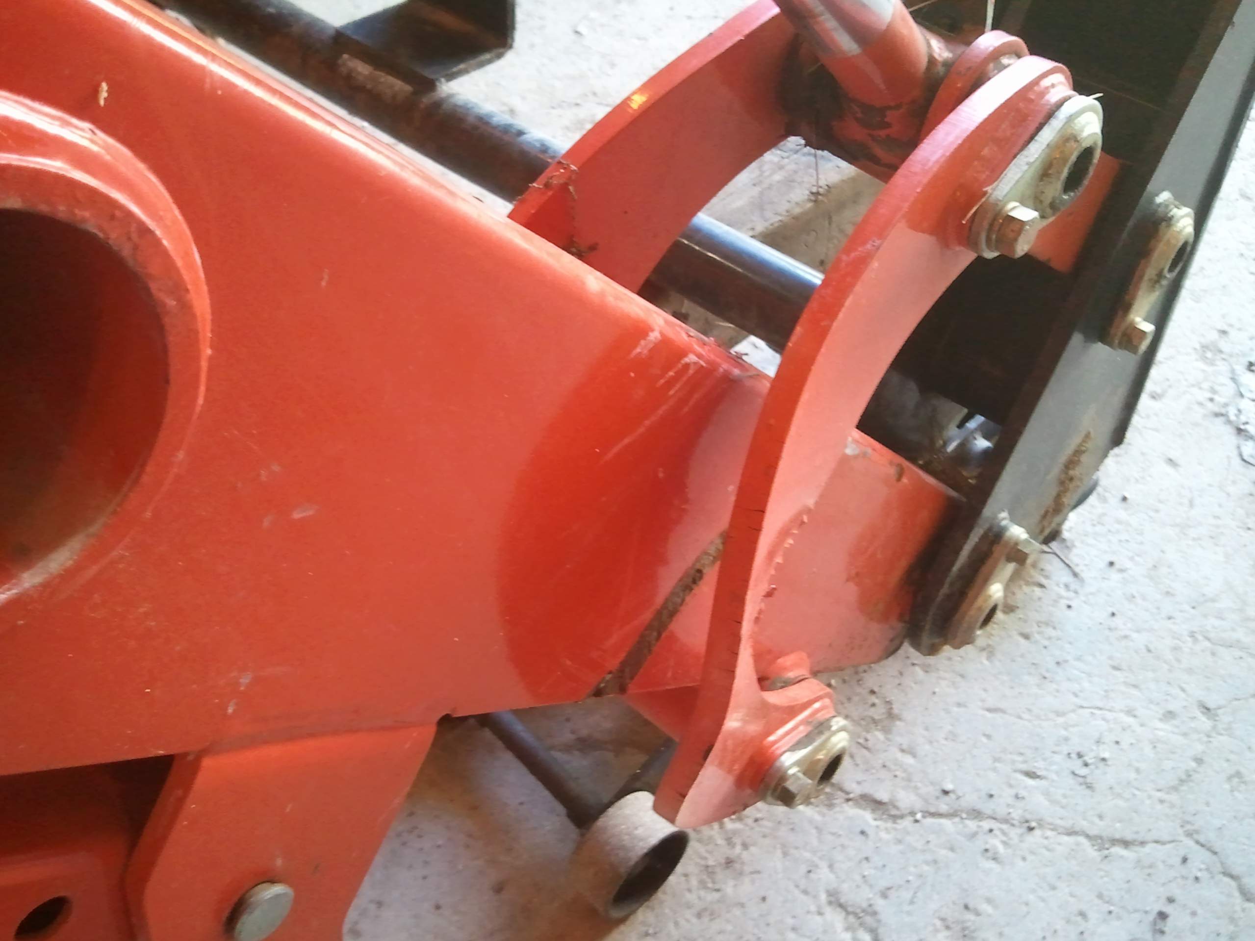

Here's what I don't 'get'. How did you manage to pretzel the 1/2 moons on a DK-45 series? That setup is so much stronger than what my DK-35 had, and the 1/2 moon brackets are much beefier than those on the CK series? And how did you avoid cylinder damage and just destroy the curl brackets? Spill!:)

Not that it makes any real difference but, both of those broken brackets look like they had started to break earlier. There looks to be rust on the edge of the cracks, which usually means it was cracked there long enough to build a little rust before it finished breaking.
/ CK35 Loader Problem #60
Forces crack paint, atmospheric moisture enters equation, metal begins process of rusting, further extreme forces are applied, twist, bend, snap. Spend money.:confused3:
