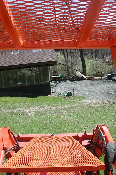

RedRocker,
Just a thought. I used flattened expanded metal (9 gage) because i wanted to see what was happening above me.
Turned out another positive was that it does not reflect sound down. I did not realize how much noise could be reflected down until I put a piece of plywood on my FOPS to block the sun. I soon replaced it with a piece of cloth, which absorbs sound and still blocks the sun.
I'll attach a photo to give you some idea of what I am talking about... /forums/images/graemlins/smile.gif

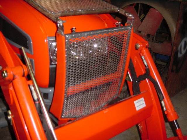

Here's the last addition for now, I'll run it a while un painted and see if I need to add anything.
