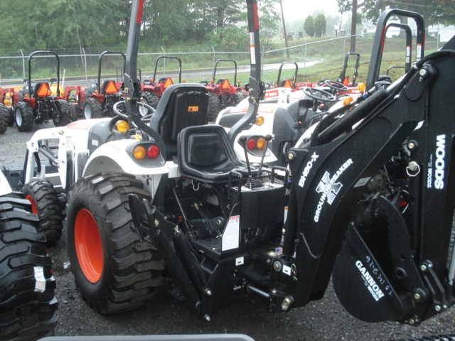

Woods does not list a mount for the Bobcat CT225.
You have to use the mount for a Kioti CK25,CK27,CK30,CK35
Same mount, bolts right up!

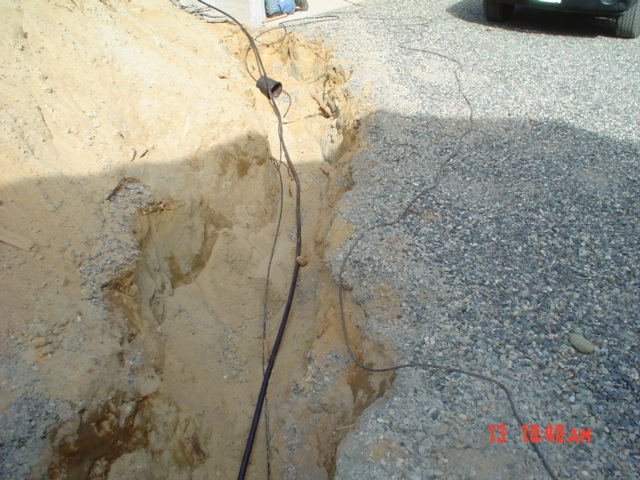

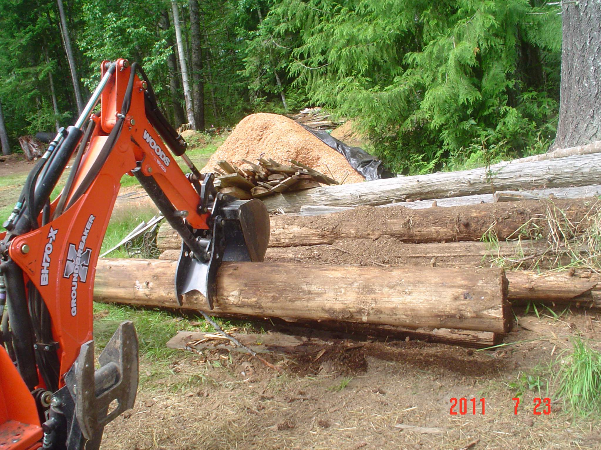

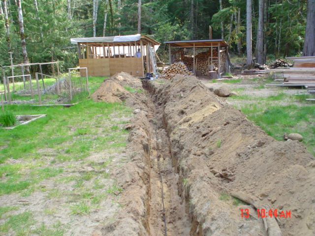

I have the Woods BH70-X on my CK35. Ordered it with the thumb when I got the tractor almost 4 years ago. Had one problem after a few hours of use and my dealer/Woods looked after it right away. You may want to farm out the septic tank hole (or rent a mini excavator) and dig the lines with the backhoe. The first 2 pics are of a trench I dug for my neighbor for an electrical line. I use my thumb a fair bit, very nice to have. :):)

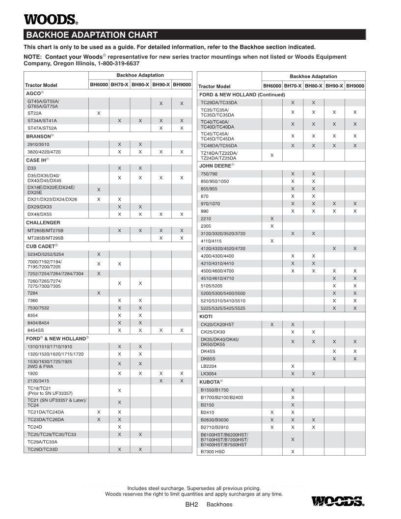

As others have said Woods makes a 4 pt subframe for the CK27/30. The subframe is compatible with the Woods BH70-X or BH80-x backhoes. The subframe part number is 1011425 and costs around $1400. If you decide to go with the Woods, I don't think you will find it cheaper in Ontario than the $4850 your seeing on ebay. One nice thing about the woods is that they come ready to install the thumb which you will need in Muskoka.
If you want to take a look at the Woods subframe manual it can be found here:
http://www.woodsequipment.com/uploadedFiles/Products/Manuals/MAN0345.pdf

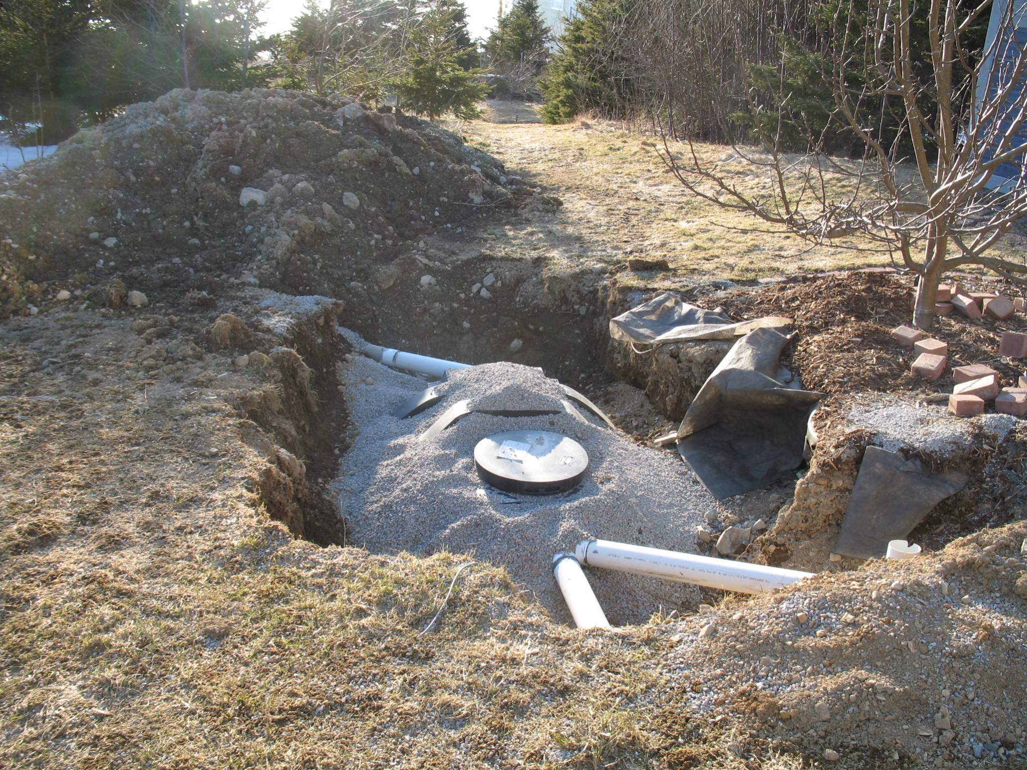

I don't know if you have a choice in septic tanks, but if you can use a horizontal one your hole will be easier to dig. The rest of the work you can do with your backhoe, so the horizontal tank option may be what you need to do.
Be sure to backfill around your septic tank with pea gravel (not to be confused with pee gravel). This 1/4" round stone allows frost in adjoining ground to move without pushing against your tank. The guys who put in my first tank did not use this; eight years later I had to put in a new tank.
The apple tree alongside also produced far less apples after the tank was replaced, too.
Good luck with your project - a great one to offset your backhoe cost.
